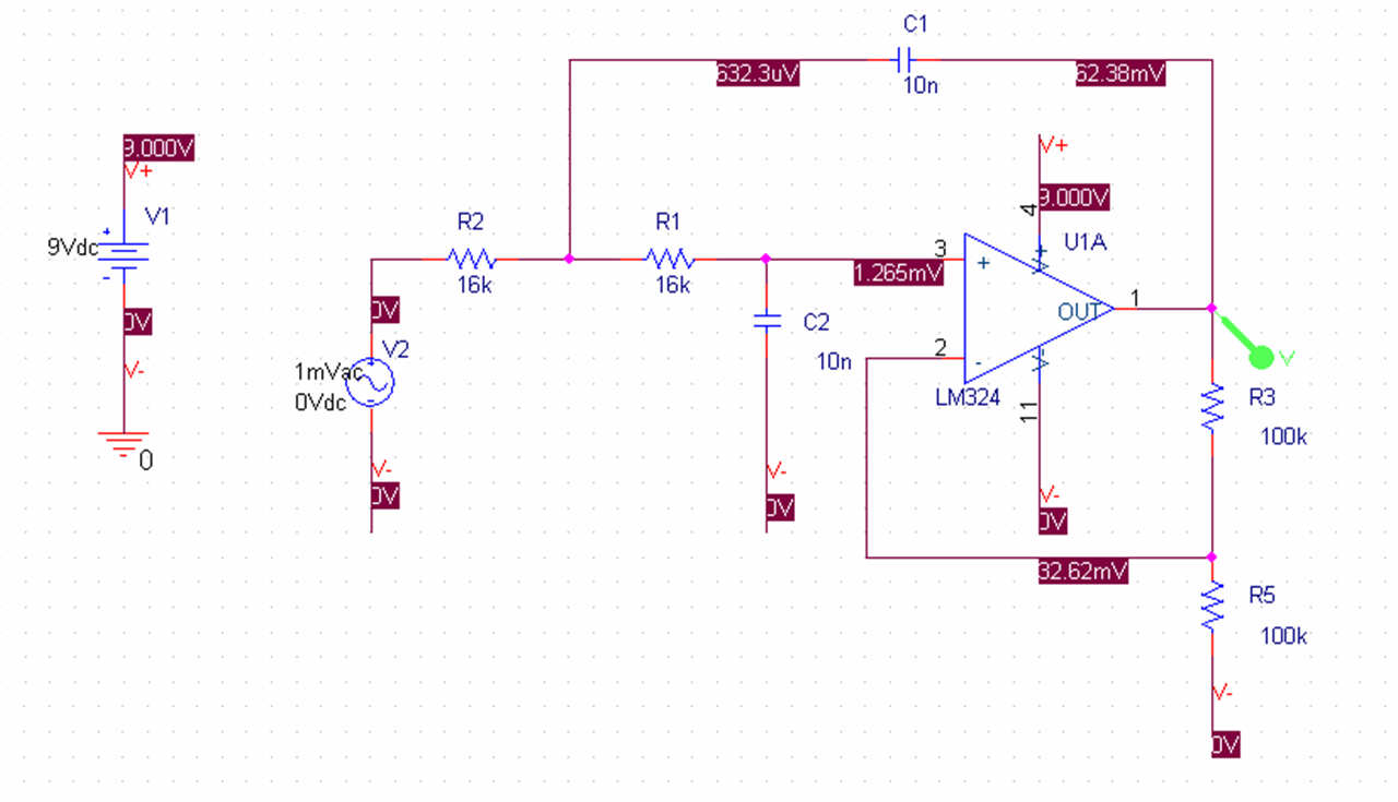

Hey.. below is my lowpass schematic in PSPICE and the simulation result.
The circuit is taken from the opamp datasheet so there should be nothing wrong with the circuit.. This opamp support single supply at 5V..

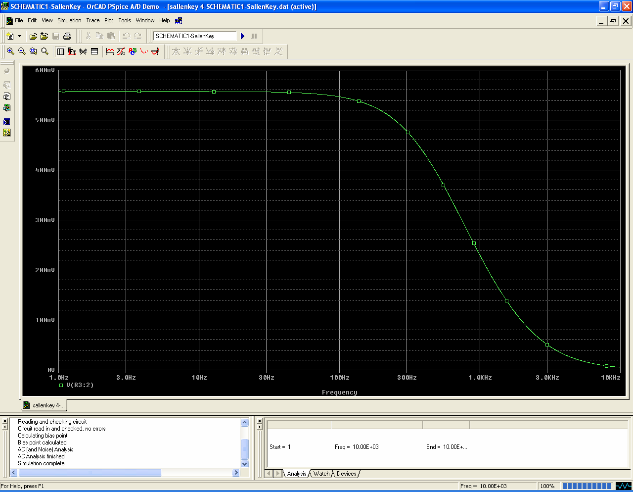

However, the simulated AC sweep result shows a negative gain..? 600uV..? How can that be possible when my input signal is 1mV..?
Anythoughts..? By the way, I have spent no lees than 4 hours trying to get just the lowpass filter to simulate correctly.. And i am out of ideas.. Any ideas..?

Opamps behave strangely (phase reversal and saturation) when you give them inputs outside their common mode range. In my experience this happens at about -0.3VDC, so I'm at a loss to explain your result. The 1 mV AC input does take the input below ground. If you want to work with a single supply then you have to bias the inputs to V/2 and AC couple them.
Before you tackle that I would suggest that you add another 9V battery to make a negative supply and rerun the simulation. Once you have some confidence you can try for SS operation.

Spice does an AC analysis by first computing the DC operating point, then linearizing all components at that operating point. It does not matter what AC amplitude you use. The gain will be the same, because the network has been linearized.
Your problem is, the op amp output is at (or very near) zero volts. At that DC level, the op amp has very little gain, because the pulldown transistor is saturated.
You need to raise the DC bias on the input, or add a negative supply. Try making the DC level of your input 1V. Also try outrageous AC voltages, like 1000V. If Pspice is the same as all other spices I have used, you will get 6dB gain (gain=2) in the passband, regardless of the AC voltage.

If he is measuring the gain within the passband, the gain should be 2, by inspection.

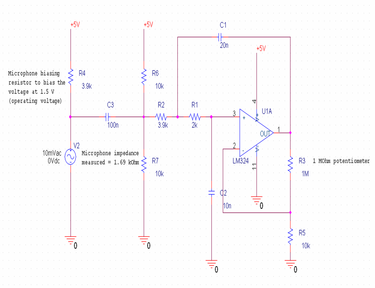

Thanks.. Based on what you have said, I have made some changes to the preamp circuit.
The circuit is attached below, based on the assumption that the opamp will work at 5V.. Does it seem right to you..?
Let's say I want to test the circuit without using mic, can I replace the mic with 1.69 K resistor (impedance of the microphone) and input a 10mV sine wave to the coupling capacitor to observe the output..?

You changed the entire circuit:
1) The source impedance for a Sallen and Key lowpass filter must be very low. So it should be fed from an opamp. The new opamp should have its input biased at half the supply voltage and it should be the opamp with the input coupling capacitor.
2) If the gain of your lowpass filter is more than only 1.6 then the frequency response will have a peak.
If the gain of the opamp is more than 3.0 then it will oscillate.
Use gain in the first opamp.
3) Both opamps need a capacitor in series with their gain resistors to ground so that they don't amplify their DC bias voltage.
An LM324 is a quad opamp in a 14 pins case. An LM358 has the same opamps but it is a dual in an 8 pins case.
They are both horrible old opamps for audio because they are very noisy and have crossover distortion.
The MC34071 single, MC34072 dual and MC34074 quad opamps have low distortion and work with your low supply voltage. But they are not low noise.
