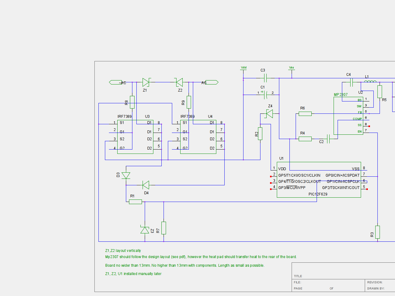

Scrap that code. Now using XC8. It compiles, and hopefully my logic is correct if anyone can have a quick look over!
  • test.c

Final (I hope) circuit attached.
Hi All,
I'm nearly there, I rewrote the software and got the PIC working. It's perfect!
I'm going to use a mosfet bridge instead of skhotty's, I've implemented this using 2x AOP605's for now but will switch to IRF7389 for manufacture (same spec). It's working, however, even though my gate voltage didn't go above 15V I somehow blew the AOP605's. I've now stuck 2x 15k resistors inline to the joined gate and it's not happened since. Is it required to reduce the current going to the gate?
Andrew

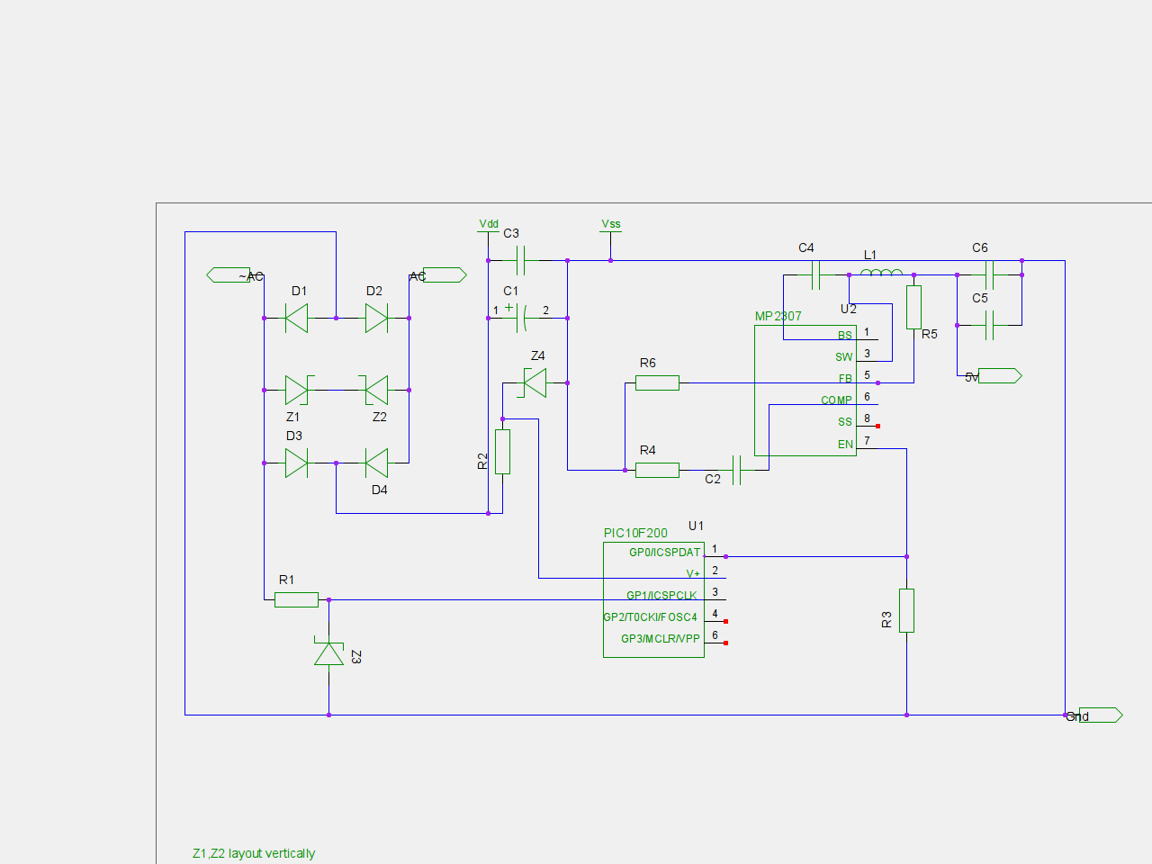

Here's the final circuit. You can see how I've added the resistors to the gate out of paranoia!
Hi Andrew,
It looks like you are well on your way to a working prototype. I have not seen the mosfet bridge rectifier before. I should reduce the voltage drop in rectification. I do not fully understand how it works as the mosfets seem to be conducting in the opposite way to the way they normally conduct. I do not understand why you original mosfets failed. I do not see how the 15 K resistors will help unless you also have zener diodes on the gate to limit the voltage. (Mosfets have a very high input resistance so 15 K would not make much difference to the gate voltage. ) I assume you are using your own code written in "C" rather than my version. If so I would be interested to see it. I may be able to follow it to some extent even though I can't write code in "C"
Les.
Hi Les, sorry yes I had to redo the code. I've attached the working version.
With the Mosfets, they use the build in diodes for the traditional bridge setup but once the voltage get to the 4.5v mark they take over. I couldn't get it working the first time but now it is. No idea how I blew the first two either. I've tried to find MOSFET's with skhottys but to no avail. I'm also unsure if it'll make any difference, there would be a greater voltage drop up to 4V but that's irrelevant anyhow, it's 5V+ that is required. Possibility it means less current is available although the voltage is the same. Splitting hairs anyhow.
If I'm limiting the voltage to 17V AC, that's 17V per side which should be fine for the MOSFET right? I'm aware that for DC it's x1.4 but wasn't sure if this is the value I should be applying to the gate. Need to be 100% before I get the 5,000 board run off done!
Regards, Andrew

That's interesting about the zeners, I was using those values to give less than 24v (max buck voltage), but knowing that I can go to 23v zeners? Are you sure!? I'm using beefy 5W, and carefully heatsinking them. They do get hot, but they've stood up find so far. If I can make them 23V, even better. It's a simplier way than using a darlington shunt.
The mosfet's have ended in failure, I didn't realise that they reverse flow, so the capacitance goes back through them and keeps the detection pin on high. Whoops!
Andrew
Hi Andrew,
I don't think I have seen that simple method used before in "C" programs. It makes the program quite short and your timing requirement is not very critical. I didn't spot that problem with the mosfet bridge. I do not like running components on the limit so I would not use a zener above 20 volts. You could use a single zener on the output of the bridge rectifier rather than two back to back on the AC side. The disadvantage would be that the power dissipated in clamping the voltage would not be shared between two zener diodes. Also the bridge rectifier would have to carry the clipping current so you may have to use a higher rated one. The possible advantage would be that you could use a stud mounted zener diode which may be easier to heat sink. I am fairly confident that you do not have to consider the 1.414 factor. (Hopefully someone else will comment.)
Les.

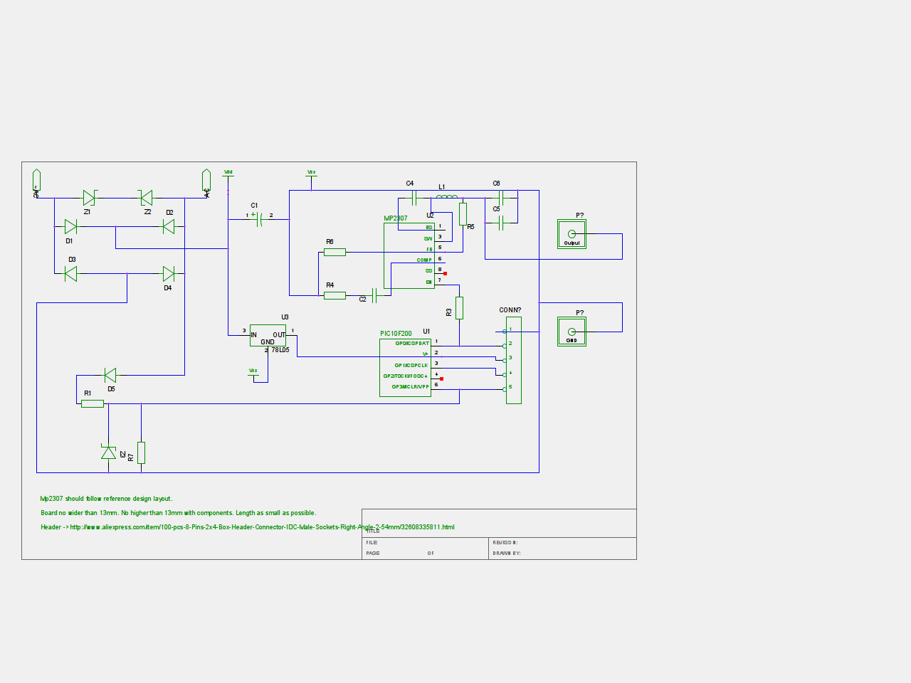

Hi Les,
I originally did it a similar with a darlington after the bridge, but you're right the bridge diodes then have to carry more than the 1A currently.
You're right about the timing but then the small PIC's don't have timer interrupt in them so wasting cpu cycles is the only way. It works though!
I modified the code timing to only count on a signal of zero and removed the diode/resistor from one side. It fits's into a 10F200 at 75%.
And I modified the schematic to include on pcb programming, a 78L05 for the pic and revert back to standard bridge rectification.
It works fine with my dynamo. :)
I'm now ready to make the Gerber (i have the BOM and footprints). If you're available to do that (at cost of course) let me know, or if you can recommend anyone. I did have a look but there's too much room for a novice to cock-up!
Regards,
Andrew
Hi Andrew,
I've never used any of the PIC10F series devices so I did not know they did not have any timer modules until I looked at the data sheet today. Most things I build are built on Veroboard (Stripboard.) so I only use devices that are available in DIL packages. I have never produced files to get PCBs done. PCBs I have made in the past have been hand painted with cellulose paint and etched in ferric chloride solution. I have tried printing out PCB layouts from magazines but none of the laser printers I have had produced dense enough print to use with photoresist coated board. For this reason there has been no point in designing PCB layouts with Eagle or any other package.
Les.
