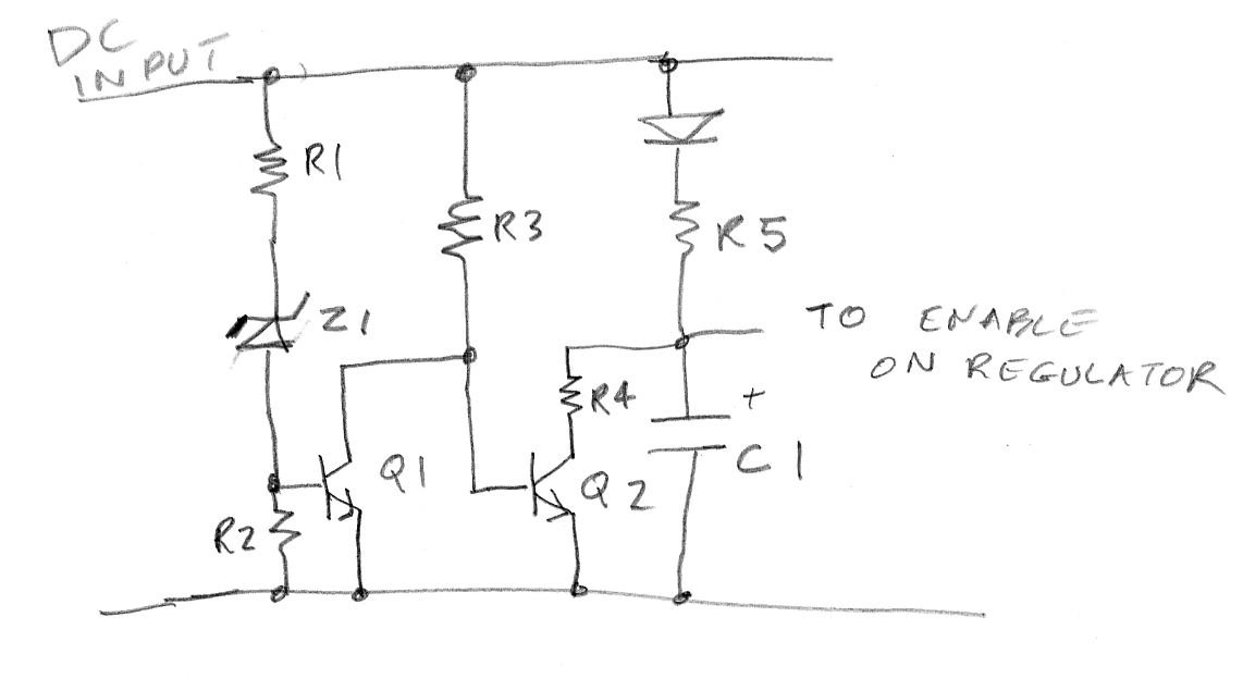

This is how it works. When the input voltage is above the zener voltage + about 0.7 volts (Vbe of the transistor Q1) Q1 will conduct. This will short out the base drive to Q2 from R3 so that Q2 does not conduct so C1 can charge via R5 and the diode. If the input voltage is below the zener voltage + about 0.7 volts Q1 will not conduct. This will cause Q2 to conduct (Due to current into it's bse from R3) which shorts out C1. Choose the value of R4 to limit the collecter current of Q2 to within it's ratings. The diode above R5 is only to prevent C1 from holding up the input voltage via R5. The diode is probably not required. You will have to work out the component values as you have not provided enough information for us to do so. You may be able to use a comparitor chip such as the LM393 but you have not provided enough information to know if this chip would be used within it's ratings. IF the input is from rectified AC then you could use the ripple frequency instead of the voltage level to decide when to enable the regulator. I was tempted to just give a description of the circuit to make it just as hard for you as you are making it for us but I decided it was quicker to draw the circuit.

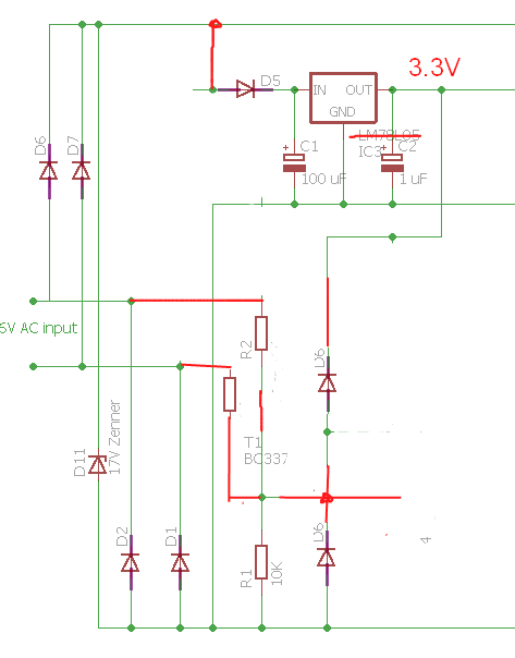

HI all, sorry for my delay. I've been busy...
Input AC - 6V, but frequency varies. Ultimately it's not the voltage that I need to detect but the frequency as there are still 6V "bursts" right down to 1/2hz. Capacitors either side of the switch mode don't elevate the problem.
Since writing the post yesterday I've been playing around and have made good progress. I'll find some Linux schematic software tomorrow and post up a diagram, but for now;
Using a 555/monostable or doesn't work due to capacitor being unable to discharge before the next V+/Hz. Attempts to discharge the capacitor have all failed due to unreliable power source to keep a transistor latched, and the varying frequency which requires hysteresis to solve.
To get around this I tried a 4060 with a diode on the last output to latch the enable pin. This works great but the chip requires a minimum 20uF for stability so I can't reset it using low V+/Hz alone. It has a reset pin though, so...
I tried a 741 wiring a equal voltage divider to vin and vref (same both sides), but using a small capacitor on one of the divider sides. My thinking was as the V+ became "choppy" the capacitor would delay the voltage and the output would begin to cycle, which would trip the reset on the 4060.
However the capacitance for the switch mode and 4060 prevented this happening, and the switch mode was potentially draining the 4060 supply, so, I added four additional diodes and give each it's own V+ rail. Hence the 741 vin/vref are monitoring V+ without any capacitor smoothing.
I'm now very close. The 741 just misses the beginning of the low frequency before resettting the 4060 and keeping it reset. I've tried all sorts of tiny capacitor and resistor dividers to tweak it but haven't had any success. Perhaps it is pulsing and the 4060 isn't quick enough (I have only an LED to inspect the 741 output). I'm wondering if an NE567 would be a better option (if it's possible?).

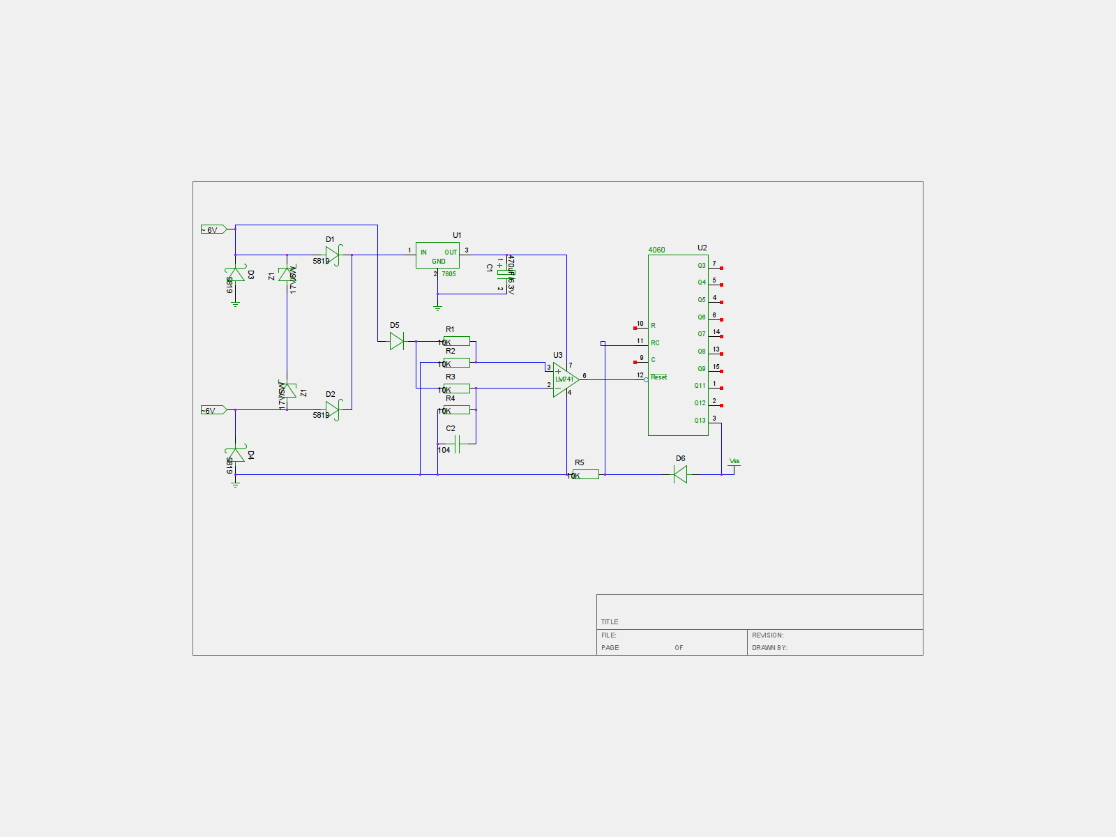

Diagram attached. It's incomplete, missing 4060 RC. The main area of focus is detecting the AC ripple/frequency. I'm very close and will upload a youtube vid in a bit to show it.

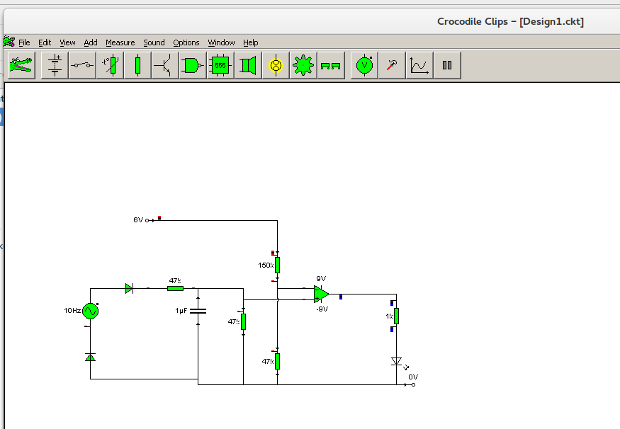

Here's what I came up with for the voltage comparison. The 741 would be on the 'smoothed' 5v rail, so I'd have to zener clamp the input to keep the comparison consistent. Can anyone see any problems?
It works in Crocodile Clips from 1998!

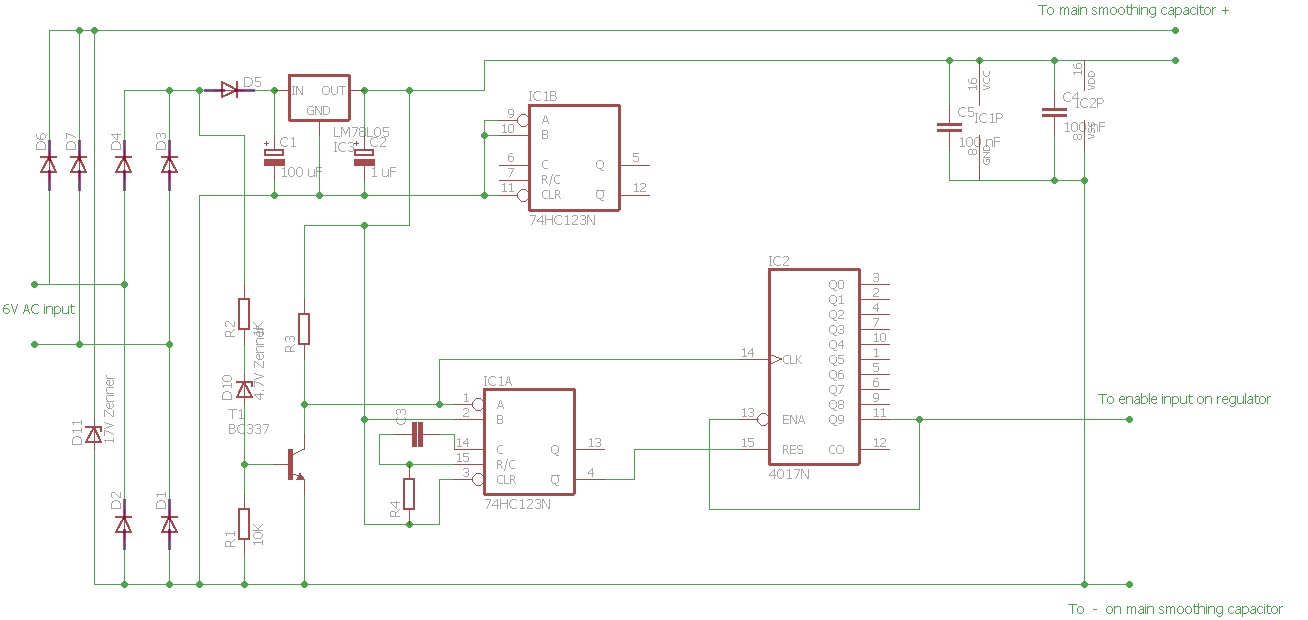

This is my suggested circuit.
This is how it works The raw rectified waveform before smoothing is taken via a resistor and zener diode to the base of T1 so T1 only conducts when the input voltage is above 5.3 volts. This generates pulses at the collector of T1. These pulses go to the re-triggerable one shot so that if the time between the pulses is less than the time constant of the one shot the Q output remains high and the not Q remains low. These pulses also clock the 4017 counter. When it reaches a count of 9 the Q9 output inhibits further counting and Q9 remains high. this is used to enable the main regulator chip. As soon as the frequency goes below the re trigger time of the one shot the one shot's not Q output goes high reseting the 4017. After the input frequency is high enough the not Q output of the on shot goes low removing the reset from the 4017. It then needs another 9 pulses before the main regulator is re enabled. If I was doing this I would use a single ATtiny13 or PIC12F629 microcontroller.

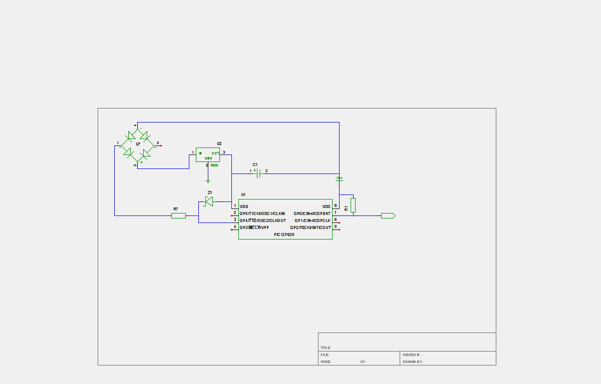

Hi Les, I'm also wishing to go down this route.
I've attached my initial design. What I can't get my head around is if the dynamo is at low hz, the amount of time spent at a positive voltage within a given timeframe is exactly the same as a high frequency. Sampling it at higher frequencies I'd expect
1010101010101010
And at low frequency
1111000011110000
So I take it all I need to do is ensure there's no 0's in sequence for a given period of time.
Back to the circuit;
1. Would the 7805 be overkill? I'd be using the To92 casing but the 629 takes so little current a resistor and 5v zener may be simpler?
2. C1 prevents the 629 resetting at low Hz. Probably 6.3 470uF
3. R1 is 10k, required to pull the buck low by default
4. Z1 would be 4V. R? would be large say 1m. Max AC input is 17V clamped by two beefy zeners (not shown).
