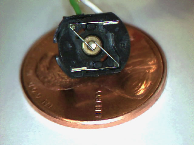

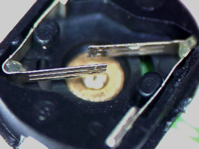

I like that resonance idea! Could be at one particular speed the brushes vibrate over the commutator gaps at some mechanical resonant frequency, and raising or lowering the voltage by just a fraction enhances or destroys that resonance. The brushes even resemble little tuning forks.
Here's a couple of pictures of the brushes themselves. These have some wear but are still good. A mechanical resonance mode at a lower speed that would knock 20% off the life makes more sense than some hinky surface film issue that only happens at low current.
Yes, that's the theory. The brushes are acting like little spring/mass/damper
systems with resonance.
If this what is causing the spike in wear then a simple (well sort of)
experiment would be to add some mass to the system to lower the
resonant frequency, and perhaps push it down low enough to move
it out of the normal operating range.
If you could get a tiny dab of solder on the two brushes without
hurting the spring characteristic too much (hopefully not at all)
this would lower the frequency quite a bit because there
is very little mass there to begin with.
Unfortunately this would mean also testing the motor to check for
wear. This brings up the question, what kind of test equipment do
you have on hand to measure the brush wear?
I guess i should have also asked how did you do all the other
tests? I guess i also have to ask, how long would it take you
to do another test after this little adjustment in mass?
If it seems like soldering the brushes would be too harmful,
a dab of epoxy might do the trick too. I just thought that
solder would have the most mass for something relatively
easy to apply and would take the frequency down the
lowest per unit volume.
