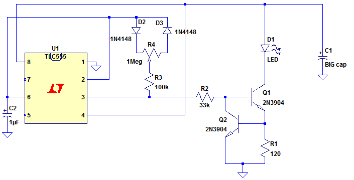

That's it. If you want constant brightness, you need a current source for the LED. The circuit below should work down to about 3V, at about 5ma current through the LED. You can change the duty cycle of the flash with the 1Meg pot. If you want to change the frequency, change the value of C2.

The Q1, Q2 structure.. I use it alot. It likes to oscillate at high frequencies alot. Ever build this on the bench? I _almost_ always need about 100pf from base to base on this structure to calm it down.

Cool, thanks Ron. By big cap, how big are we talking? 100uF or like, 10,000uF?
That's the big cap you are playing with.
C=I*T/V
The current I = 5mA*dutycycle
So, if you flash the LED for 0.2 secs every second, or 2 secs out of 10 seconds (20% in either case), and you want it to last for T = 10 minutes (600 seconds):
If you charge it to 9V, and it works until it's down to 3V, then V=(9-3)=6.
C=(5*10^-3)*0.2*600/6,
C=0.1 Farad
If you already have a capacitor, just solve the equation for one of the other variables. You can change the duty cycle with the pot, as mentioned previously.
This is just an example, and assumes the TLC555 draws negligible current. In reality, the time may be about 10% less than calculated.
