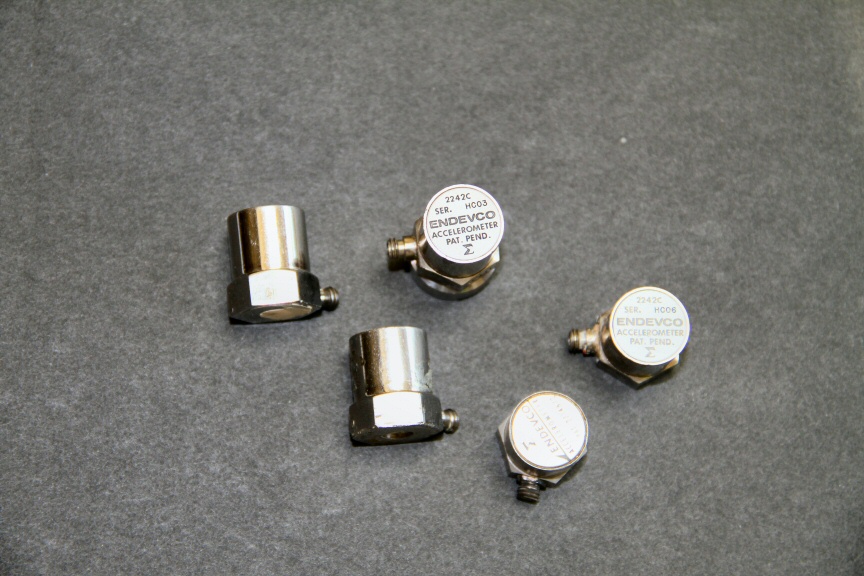

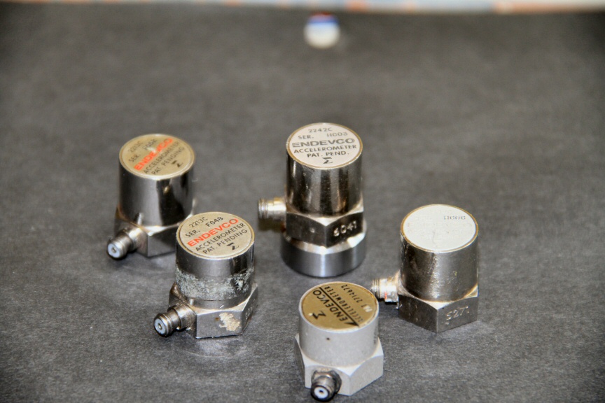

One way to measure the passage of the rod through a coil is to apply a DC current through the coil with a resistor to limit the current. When the rod passes through the coil it will disturb the magnetic field which should produce a measurable voltage blip across the coil and resistor. Just detect the blip by AC coupling the coil voltage to an op amp amplifier and then to a comparator. With a little experimentation you should be able to select a comparator trip point that will reliably detect the passage of the rod. The more turns of coil wire, the more sensitive the device will be.
I can tell you how I would start as to measuring rod bottom time, and rod bottom time being the time it takes the rod to drop from when the field of the magnet collapses to when the rod hits the plate it crashes into. You have a time interval measurement needing a start & stop command. First the start, I would think about using a hall effect sensor (assume DC Coil magnet). Place the sensor in close proximity to the magnet. Allegro makes a line of hall effect sensors that act as switches and can be found here. Nice thing about this is that it will switch when the field collapses which should be when the rod is released. Another option would be to grab a signal from the switching when the magnet power is removed. Downside is it will not take into consideration the current decay in the coil unless you get fancy. A hall effect may be the best bet or something for you to consider. I would likely start with considering one of those methods as a start.
For the stop signal I would again consider an accelerometer. Since the term accelerometer has become real popular I'll attach an image of the type I am talking about. The ones in the image actually have a screw hole tapped into the bottom and one in the images has a magnetic base attached. The connectors on them are also a screw connector, here in the US a 10-32 screw but there is a metric version I am sure. I happen to use Endevco (Meggit) which can be seen here but others make the same thing. Truth be known and for what you want maybe even a cheap guitar pickup would work attached to the impact plate. When the rod drops and hits the plate there will be a bang and that bang is all we care about.
I amplify the output of the accelerometer (more I think about it a cheap electric guitar pickup may work as well) and eventually run it to a comparator circuit. When the bang happens it triggers the comparator and I use that to drive a 7474 ancient flip flop. The circuit is really simple (well pretty much).
The bottom line is I have two
Type D Edge Triggered Flip Flops
using the preset and clear. The outputs of those flip flops give me the negative slope triggers I use for start and stop of my counter.
This is how I do it for my applications and it works for me. There are likely a dozen ways to do this so be open. Both Gary B and Crutschow may have ways to implement their thoughts. You mention acceleration as a result of a spring so the velocity of the object (rod) dropping won't be a constant. I like the coil ideas.
<EDIT> When I said electric guitar pickup I did not mean a $1,000 USD pickup, I had in mind a $5.00 USD mic as used on a kids guitar. I just looked at some pickups and thought I would clarify after the sticker shock wore off. :) </EDIT>
Ron

I don’t think I understand the sensor positioning issue. Do you want to measure the speed at a particular point below the release point as opposed to an absolute position above the final resting point? I was just thinking about something like a plastic tube the rod would drop through and you manually clamp the sensor to the outside of the tube at the position you want the measurement to take place. You could use a slightly larger tube with slots cut in one end and a hose clamp to squeeze it down to hold. Wrap two coils around the moveable tube and build what amounts to two metal detectors.
Per Gary B's questions and just so we are on the same channel my understanding is you are not concerned with the velocity but the time interval between rod release and when it hist the bottom, the plate it falls on. Also if or when you have any information on the rod dimensions that would help so we aren't envisioning two different pictures. The more information that can be provided as you get it the better.
Ron

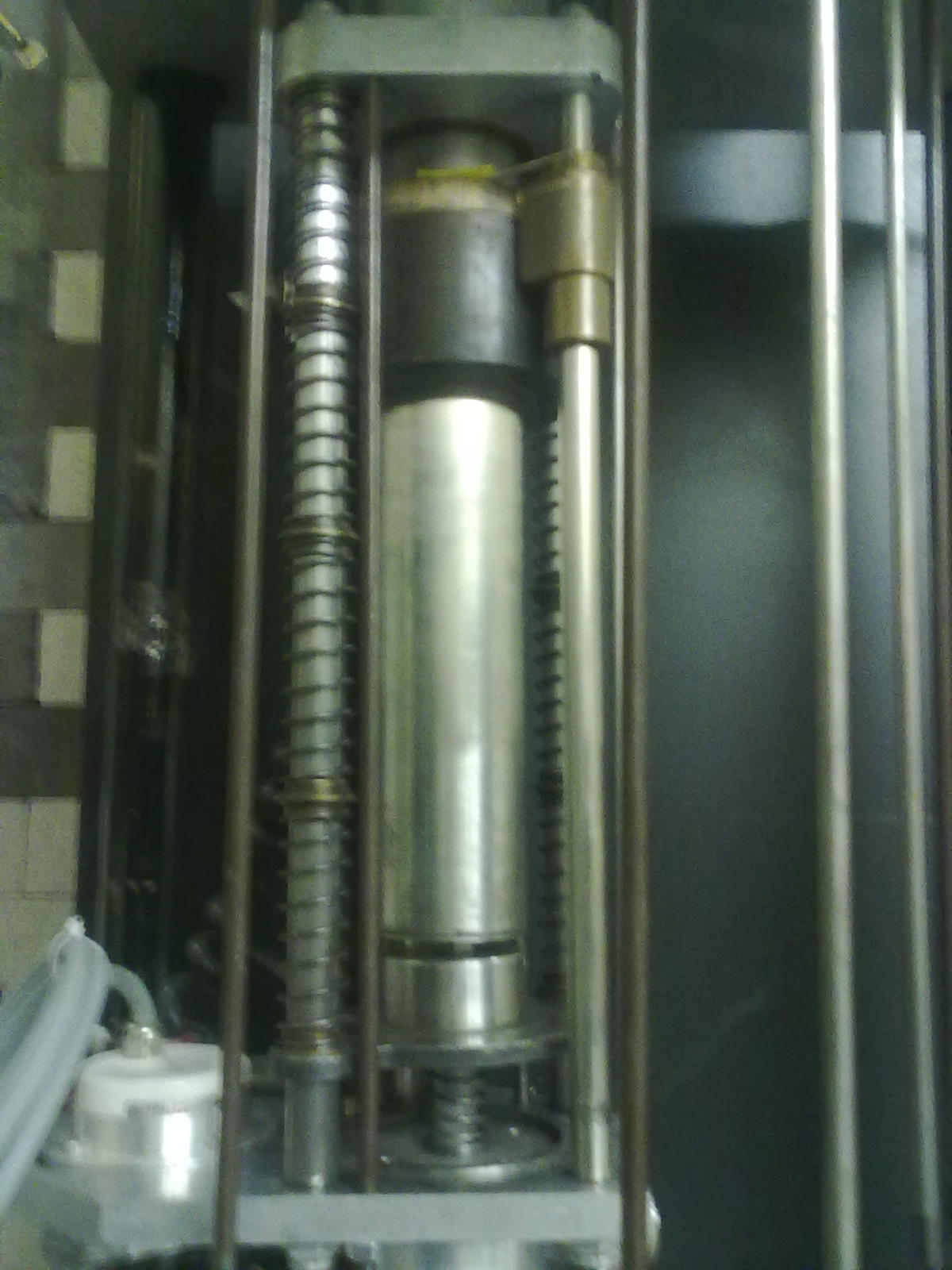

Sorry for not responding for a while, I wasn't able to make schematics (i will do that once i get the proper access to the programs to make the diagrams). However i was able to just take picture which will help.
The Starting position of the drop will vary. The max drop height is 26 cm, however it can be dropped from 20 cm or 15 cm etc.. the drop height is random.
The first picture shows the rod at rest on the bottom being supported by the dash pot it will hit when dropped from the top. The black thing at the top of the rod is the magnetic that will be lowered to pick up the rod from rest. The magnetic will drag the rod up to x height and drop it.
The second picture is the view from above the rod. Sorry about the resolution, The base of the platform is the area i can use to setup the sensor.
I cant put anything in between the supporting beams. The beams allows the magnetic to go up and down so if i put a sensor there it will block the magnetic path.
Now back to the previous suggestion of a accelerometer that will sense vibration. I don't think i can use this because 4 of these mechanism will be placed adjacent (the metal bases will be touching) to each other so how would i be able to differentiate the vibration from one mechanism to the other one sitting next to it.
I'm going to look into using an inductor type sensor to detect when the rod hits the bottom.
As a side note I will refer to the dropping object as a rod in order not to confuse how our discussion has be proceeding. However as you can see in the picture the rod is connected to a flat disc which is then displaced by the magnetic.
The bottom line is i need to find the time it takes from start to stop at any height with out me readjusting the sensors each time. I've considered just splicing into the signal that will turn off the magnetic as my start time. Additional data that i would like to be able to get is the distance traveled within total time at various interval. For example say my start/stop timer measures 4 ms to drop say 20 cm, I'd like to be able to determine displacement in the first 2 ms and the last 2 ms. The reason why i can't use a simple analytical analysis is because of the spring that is pushing downwards with gravity therefore trying to use sensors. The additional part can wait first I'd have to be able to determine a reliable method to measure start/stop time.
Another thing I'll toss out there is this mechanism once fitted with the sensor will be put inside a giant container. They only pull this mechanism out like twice a year for maintenance thus the reason why i can't reposition the starting sensor by hand.
Hopefully this helps clarify things! As always thanks for the responses :)

I need the time it takes dropping from a random height to the bottom.The height can vary after each drop. I will need the initial height it drops from (if they don't have a sensor that tells that) and the time interval during the drop. Eventually i would like the speed/velocity.
Now that i think about it what i think i might do is have a IR sensor on the bottom to tell me when the moment the rod hits the ground as you said.Then I'll just use the same signal that is used to turn off the magnetic (which initiates the drop) for the start timer. Does that sound feasible?
Now that i think about it what i think i might do is have a IR sensor on the bottom to tell me when the moment the rod hits the ground as you suggested.Then I'll just use the same signal that is used to turn off the magnetic (which initiates the drop) for the start timer. Does that sound feasible?
That's basically what I said in the last sentence of my previous post.
If you need the initial height, then that requires an additional sensor(s).
That sounds feasible as long as your stop signal is right across the dash pot so you get the true bottom. By the way, the dash pot is acting like a shock buffer correct? If so does the dash pot move? When the rod strikes the dash pot does it collapse any? The fact there are several of these things in close proximity could screw with using an accelerometer to catch the bang. Bummer on that note.

Yes it does act like a dampener that's why I wasn't sure if the accelerometer would work out so well although it was a good idea :). Eventually i have to figure out how far down the dash pot is pushed down but, that's a problem for later.
@crutschow
I'll have to determine the height as well using sensors it seems. I was thinking using the magnetic it-self as a point of reference then perhaps use a IR that measure distance by -10 to 10v. I'll just have to think on where to position it to make that work.
