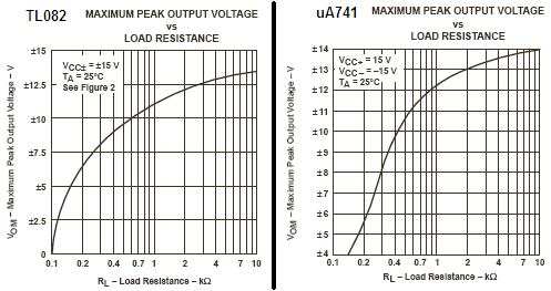

I'm glad you discovered the "Suzluki" pair of a darlington type of connections for complimentary transistors. It has the voltage loss of a single transistor but a high current gain.
The 741 has a little higher output voltage than the TL081, but over only part of its output current range. There are a few dual 741 opamps: MC1458 and 4558 ring a bell in my mind.

Thank guru. I see that if I want to maximize my maximum output voltage, I need to draw less current from the TL082, and/or use a ua741. The revised design has a maximum output of 11 vs 10.4 before.

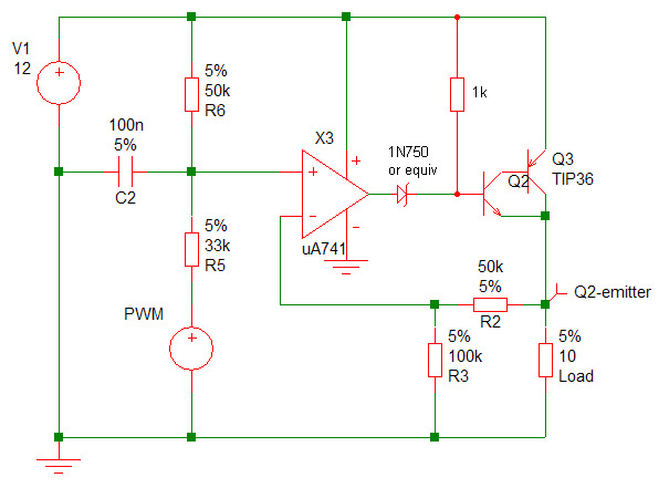

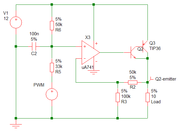

I don't have a PFET, so here's my latest rev. Please let me know where you think a feedback capacitor is needed. The final values of resistors may be adjusted, but let me know if I am missing a resistor somewhere.
According to simulation, I can get a maximum of 10.95 volts from this approach. Anything over 10 is going to work.

I think the feedback cap shown in RON's fet version remains suitable for this one as well.
If you require over 10 volts to work, you ought to calculate the minimum you can get with your offsets & tolerances. Otherwise, when you build the thing you may find it running under 10V (unless you will be cherry picking your R's)
My 741 model only allows about 10.3 V at the output - and that ain't guaranteed. Maybe you were monitoring the op amp output?
Anyhow, you can get closer to +12V by adding a zener and resistor as shown, since it is the op amp that is limiting your range. Either that, or switch to an op amp with rail-to-rail output capability.

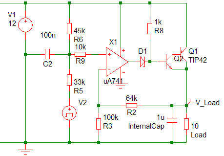

I built the circuit on a breadboard and ran my pump for about 20 seconds and it start up at around 8 volts. (duty cycle is around 20% at boot-up). The transistor got really hot. It would have been burning about 4 watts, but it may have been oscillating. I'll be putting on a heat sink.
I see that that 50p capacitor directly connected to the negative input and amp's output solves the oscillation problem.

Got the heatsink on and the feedback capacitor in place. It works exactly as simulated. Max voltage, 11.05, min voltage 7.34 or something. The heatsink is too hot to leave your finger on it, but not hot enough to boil saliva ;-). I used silver thermal compound when attaching.
Is this too hot? It is possible to run two TIP42s in parallel, or do they need to be "load balanced"? I'm starting to see why a buck converter is the preferred method for DC to DC.
Finally, I have a 10-Ohm 10W power resistor I could put in parallel around the TIP42. In this setup, it would take just over half the current load at the minimum voltage, which is going to be most of the time.
