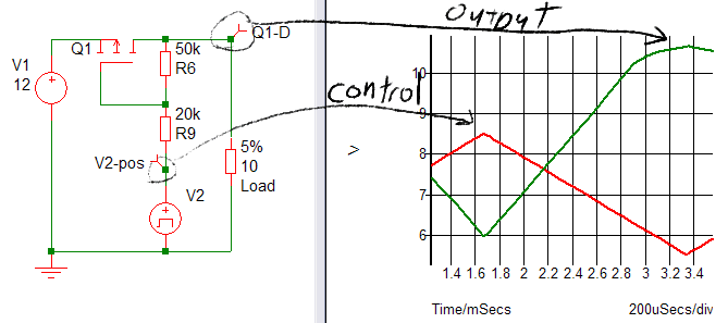

I was going to use the MOSFET in favor of a power transistor because A) it takes very little current to drive it, and B), the voltage drop can be almost zero. But, after simulating it I don't see a big advantage over an NPN power transistor, mostly because my load is low resistance and the voltage drop is still going to be about the same.
My goal is to power the load between ~7 and 11 volts, approaching 12 volts is extra credit.
I am operating the MOSFET in "linear" mode by using its own output as feedback to the gate. Are they designed to operate in this range? Or should they just be "wide open".

I tried simulating it, but the Mosfets in my software have static damage.
Do you need linear control? Would you like it to be predictable? If so, we can show you how. What is your input voltage range?

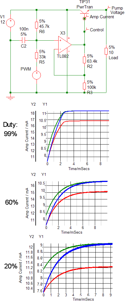

My input voltage is from 0 to 4.2 volts (PWM through RC filter). I am running it through an opamp for gain and offset to get a control voltage of around 7 to 11 volts, which I am running through a power transistor.
The graphs show the opamp's output voltage and current, and the load's voltage, which is slightly lower due to the TIP31 drop.
Notice that the opamp is putting out almost 20mAh, which I believe is its limit. On a chip with 2 opamps, is the limit described per unit, or for the entire IC?

Hi Dino,
A TL082 is guaranteed to drive a 2k load to 12V with a 15V supply. That's a 3V loss with only a 6mA load. Its typical short circuit current (with the full supply voltage as a loss) is 20mA per output.

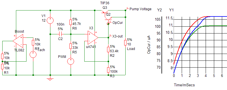

Thank guru. I see that if I want to maximize my maximum output voltage, I need to draw less current from the TL082, and/or use a ua741. The revised design has a maximum output of 11 vs 10.4 before.
I didn't know how to improve my gain. I thought I had to stack two NPNs in series, which results in double the voltage drop. Then I found out about stacking a PNP and NPN pair, as shown in the following attachment. The OpAmp current draw is *much* less now. The TIP36 is overkill, I'm actually going to use the TIP41/42, but I couldn't find a spice model for it.
Does this look like it should work? The Op-Amp on the left side is boosting my tachometer pulse. I'm not sure if I need to boost it back to near 12-volts (which is why I was using the TL082, since it's a dual IC). I have a feeling my motherboard should detect the RPMs even if they are ticking at just 7.5 volts. If so, I'll use a 741.
