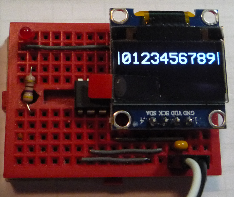

The little 0.91" (128x32), 0.96" (128x64), and 1.3" (128x64) OLED modules use a two pin I2C interface and look pretty nice with a 10x14 font (10 characters per line). The photo below is a 0.96" display...
Good luck on your project.
Cheerful regards, Mike

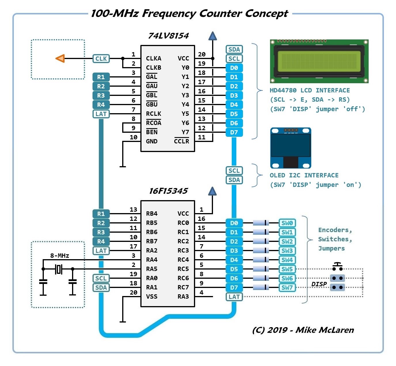

On a related note... I came across an interesting 32-bit counter chip awhile back that I believe would make a nice 100-MHz frequency counter. I ordered a couple of the chips and came up with a design that I thought could perhaps support multiple display types but I have not had a chance to try anything yet. BTW, you should be able to add a 2nd or 3rd counter chip in a design (using a bigger PIC) which would allow you to measure BFO and Mixer frequencies, too.
