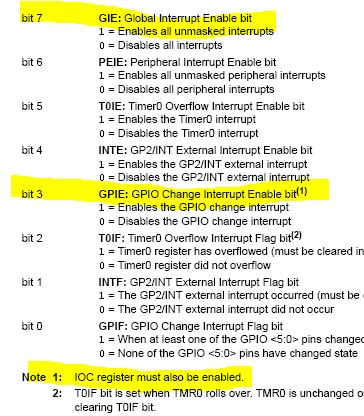

I used a 12F683, mainly because I was playing that chip for something else. For that chip, it appears that Microchip makes a distinction between other peripheral interrupts and the IOC interrupts in INTCON:
I left bit<6> clear and only set GIE and GPIE. In the IOC register (Bank0), it is also necessary to set the appropriate pins. I clear GPIF on exiting the ISR. Perhaps that name (GPIE) is due to calling the 12F683 port "GPIO" instead of a proper port name. In the 12F1840, GPIE is renamed IOCIE, which makes more sense. I am not that familiar with IOC on other chips.
I think I have made all the name corrections for you, including in the diagram I posted.
Thank you again for sharing your algorithm.

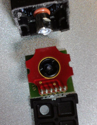

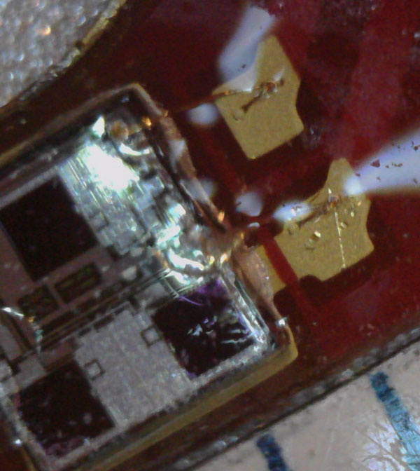

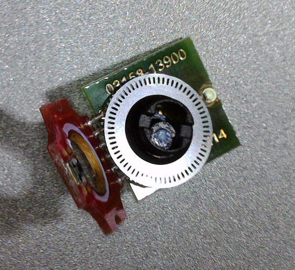

Here's a little follow-up. My first Bourns encoder died an early death, and DigiKey replaced it. I had seen pictures of how they are made, but I decided to take a look anyway. Here are some pictures. One shows the parts right after popping the back off. There is a little pot accessible from the back, but covered with the label. Then there is the LED and detector and a very nice slotted disk. The rule is in millimeters. One photo shows some silicon. I have no idea what it does except act as the photodetector. Maybe it acts like a comparator to give sharp state changes.
Regards, John
The pot is often there to adjust the phase angle between the two pulses to exactly quadrature (90°).
The optical/graticule type of encoder starts off as two sine waves, they are then squared up for output, some encoders will retain the sine waves and use the Arctangent function to increase the resolution to much higher than the slot count itself.
Max.
