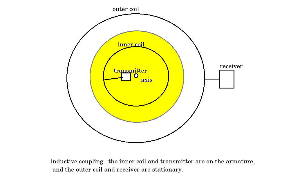

you could also use inductive coupling, where you have a circular coil on the rotating part, and another circular coil stationary, but around the moving coil. i don't know what the data rate is that you are looking for, but if you ran something like PSK or FSK at 20khz you could get a decent data rate.
something like this:
This is a very harsh environment. I think it would be too difficult to protect something like that from damage. Assume that a deranged mechanic will attack it with a sledge hammer. Larger assemblies make larger targets for the evil mechanic. I'm not joking. Smaller devices can be protected in thick fiberglass enclosures, and may fly under the evil mechanic's radar. Even so, we have to expect to replace them every few weeks as part of standard maintenance.
