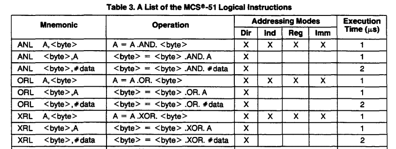

please clear one thing all logical operation can be done in accumulator so where and how to use acc in above program
ANL Is used by the Acc only... Sorry about that... A quick look at the datasheet says it can... But it can't.

Oh!! Ignore that... I was just having a whinge at the datasheet... As you know they are not always clear about some commands.
If you look at the table it doesn't specifically state the accumulator..
