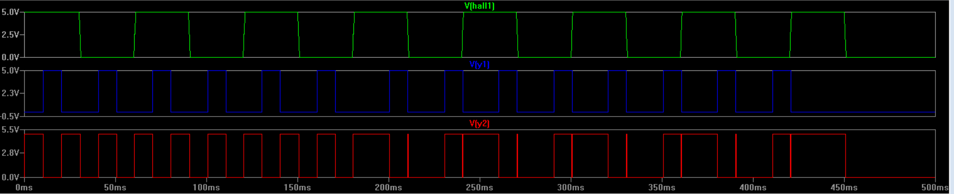

I used 74HCT86 XOR gate in my circuit.At the output, I expect 0 or 5v according to input values.But I obtain irregular waweforms when motor change direction of rotation. Inputs of 74HCT6 are Hall1 and Y1 and output is Y2.How I can eliminate these irregular waveforms from Y2?
Regards
By having exact timing between changes on the two inputs. Otherwise there will be these glitches.
Anytime the two inputs are changing at approximately the same time, you will get glitches.
You have to arrange the hall sensors so the two signal edges don't overlap for either motor direction.
