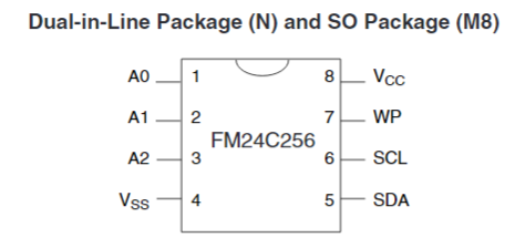

located EEprom on this board.

I see that on two of the 8-pin devices, four pins in a row are connected together. In the case of this memory chip pins A0,1,2,Vss. This is common for a I2C EEPROM and sever other types of memory.
The 5500B may be a LDO voltage regulator, its pinout seems to matche the NCP5500B.
What is the part number of the "CPU", the 32 pin chip? That may have the EEPROM built in (internal)

I have Atmel 8-pin EEPROMs if you want to modify them. All are SOIC devices that I can send to you - I'm not into surface mount IC's, just got these from PCB recycling.
I read that if I swap the eeprom chips, the info stored on my old Radio will get moved to the new one and the radio is unlocked.
the other way to access the EEPROM is through the JTAG interface, which will be 5 test points grouped somewhat together near the MCU chip. you will need a schematic to identify the test points for the JTAG interface, and have a JTAG device that goes to a USB port on a PC, and software to read the EEPROM data. depending on the MCU and it's features, writing to the EEPROM might be disabled after programming at the factory.
