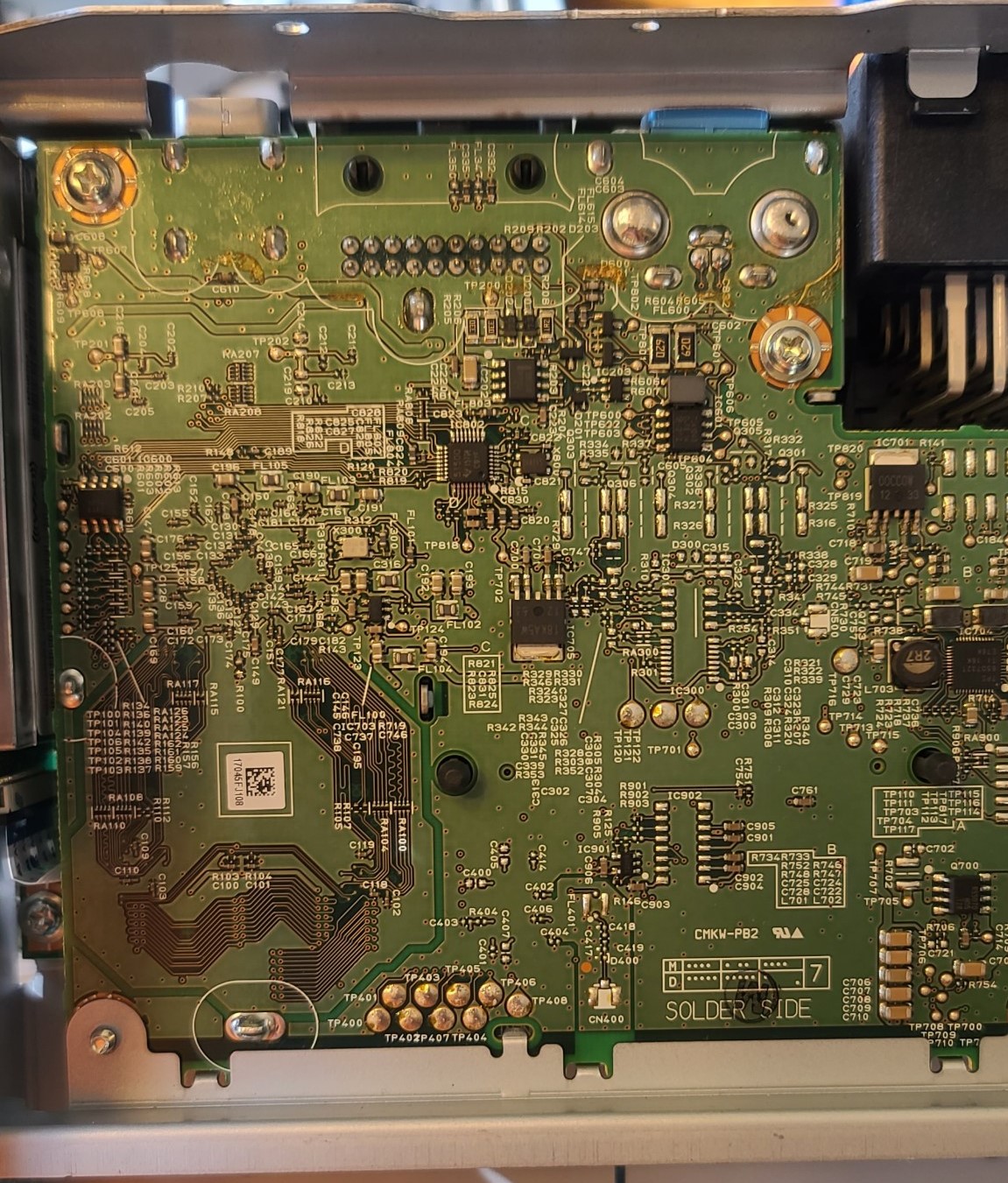

located EEprom on this board.
mbarry7920
Hi all, please help me locate the EEprom on this board.
Thank you
Mitch
Post the part numbers of the 8 pin parts for starters. The ones with 4 pins on each of two sides.
Regards, Dana.
It will likely be one of the 8 pin ICs. Most likely it will be closer to the CPU than those farther away.
If you post the make and model of your TV, rather than keep posting blurred pictures, it would make life much easier for you. Usually the EEPROM will be an 8 pin chip, but it could be contained inside a much larger one.

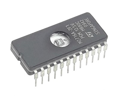

Only Eprom I know looks like this. Maybe this is an EEprom? That was 35 years ago. I forgot more than I ever knew.

I presume you don't know what either means?.
Originally there was ROM - Read Only Memory - essentially 'blowing' fuses inside the chip, a one-off time operation.
Next was EPROM - Erasable Programmable Read Only Memory - you could erase the device with UV light.
What we're taking about here is EEPROM - Electrically Eraseable Programmable Read Only Memory - these are usually small 8 pin I2C (or SPI) devices used for storing settings, such as the tuning settings in your TV.

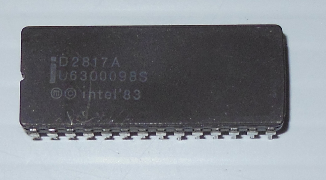

I remember earlier D2817 EEPROM, those as 28 pin DIP packages emulating a 2716 but with more pins (28 vs 24) to allow programming. I still have a few of them :)

looking at the board,
judging by the wiring pattern with a lot of the I/O lines going to the left of the board, including a couple that go directly to IC600, i would say IC600 on the left edge of the board.
You may be right, but then, all those lines may go under that chip to the Test Points. The test points may be used for ICSP programming of the little CPU. My guess would be IC202. An I2C EEPROM would only require 2 signal lines, not the many lines that go towards IC600 on the board.
But, this forum asked a while back for the OP to post the part numbers of the 8 pin chips. With that, we can tell for sure if any of them are EEPROM. It is also possible only the CPU chip has EEPROM internally, and there is none external. Again, without chip labels or numbers, no one can give an educated guess unless they happen to have the same board...
The OP hasn't been back since he posted the question, if he gave the make and model we could probably easily tell him which (if any) is the EEPROM - as you can often download the manual.

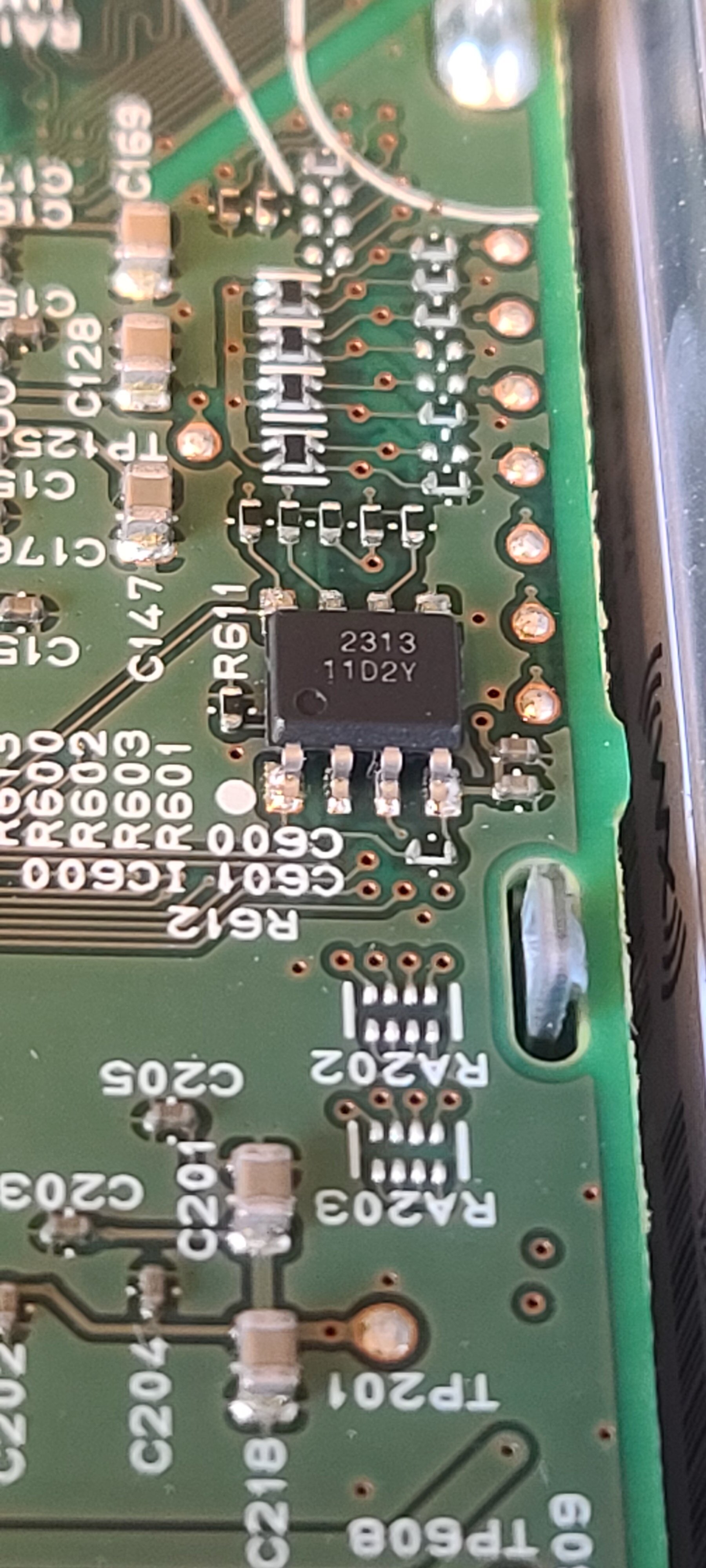

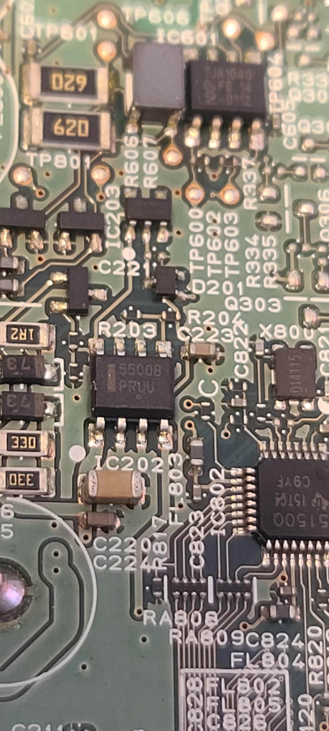

Sorry guys I've been out of town. just to explain why I need it, I have a GMC car, the radio stopped working, so I bought an identical one online, when I installed it, it says "locked". I read that if I swap the eeprom chips, the info stored on my old Radio will get moved to the new one and the radio is unlocked.

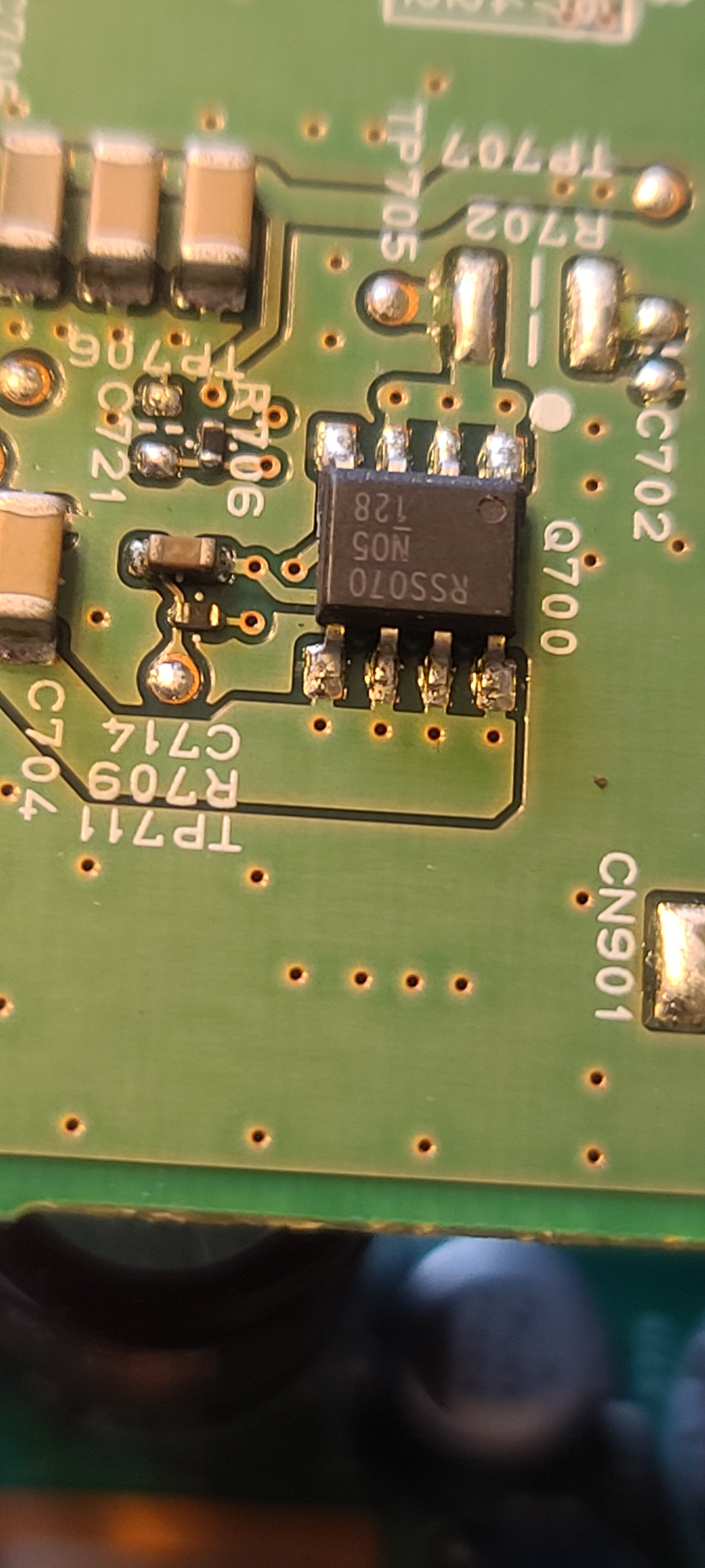

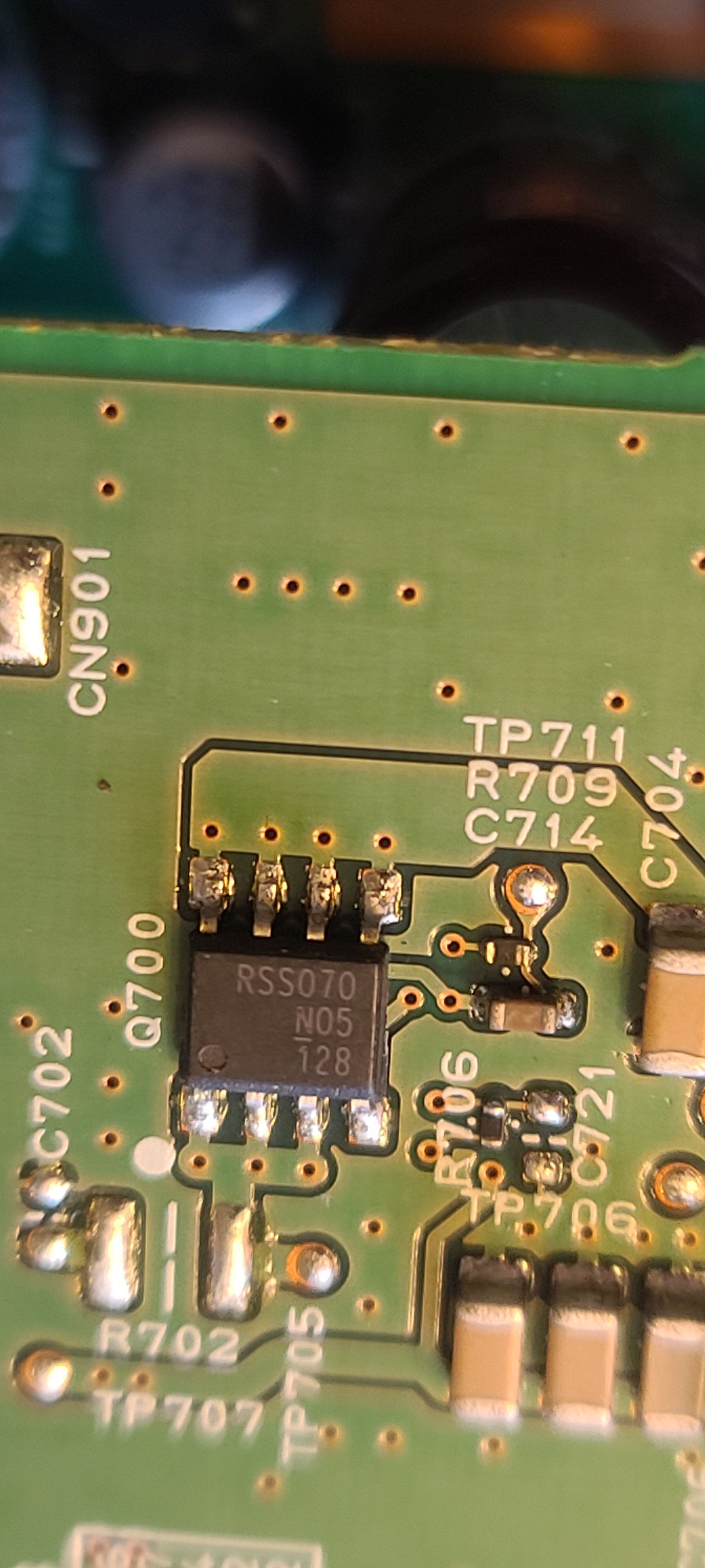

Please see attached pics for all of the chips with 8 pins. here are the numbers chip1 RSS070 NO5 128
Chip2 5500B PRUU

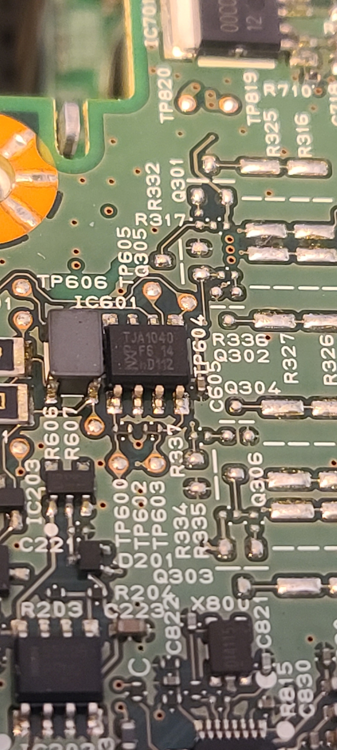

Chip3 TJA1040 F6 14 D112
Chip4 2313 11D2Y
Your input is appreciated.
Thank you.

It's not the TJA1040. That is a CAN transceiver and it doesn't store any data.
Nor is it the RSS070. That is a MOSFET, I think. It is labelled Q700, which implies that it's a transistor, and the four pins on one side are joined together, as are three of the pins on the other side. That is how MOSFETs are often arranged.
I don't recognise any other parts.
Your photos don't line up with your descriptions.
