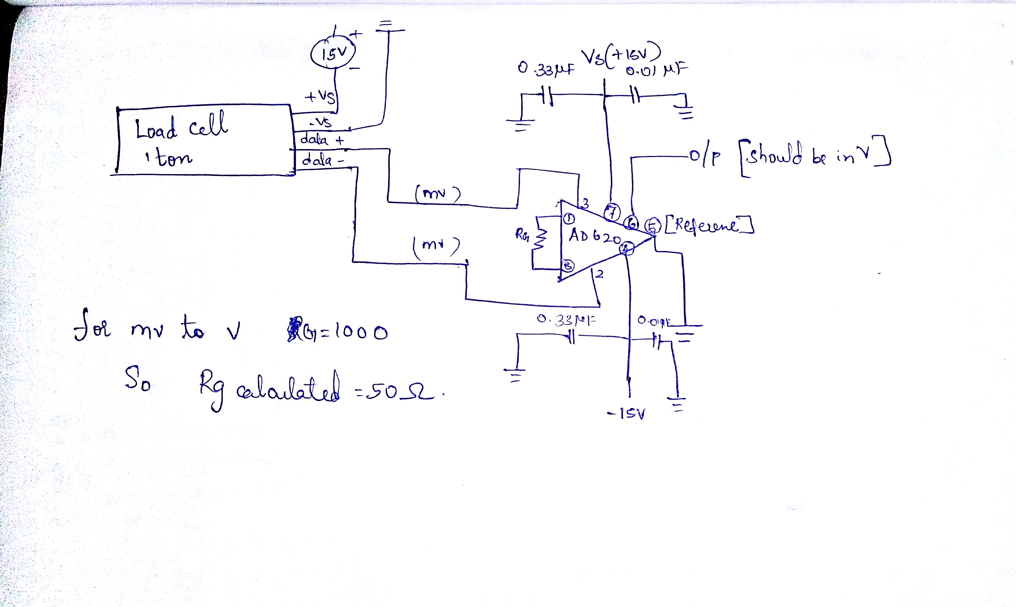

Have you sketched out the circuit you could post.?
Eric
Hi sir ,I have inserted the circuit diagram. So please check it. Heartly thanks for your ccomments and replying me

No I had applied only 15 volts to it.as its an one tonn rated load cell , it requires excitation voltage of 9-15 volts
If I use the above circuit the out put comes of 11.35 V .its like the excitation voltage (15V)that I got.what is this problem.please give me some suggestions.
hi D,
With 15Vdc excitation, the unloaded load cell should have common mode output of +7.5v.
With the Vref pin at 0V, the Vout of the AD620 should be close to 0V.
If you set set the Gain, assuming a load cell output of 15mV at full load, to give a Vout max of 5V [ suitable for a PIC's analog input]
The Gain would be 5/0.015 = 333, a Rg of ~ 150 ohms would be required. [ I would suggest a 100R fixed and a 100R pot in series]
If you are concerned about over driving the PICs ADC input, ie: greater than 5V, use a series resistor and a 5.6v clamp zener diode on the Vout connection.
E
I would recommend a simple noise/RF filter between the load out and the input to the AD620.
Say a 10K in series with both the Inv and Non Inv inputs and a 10nF across the AD620 input pins,

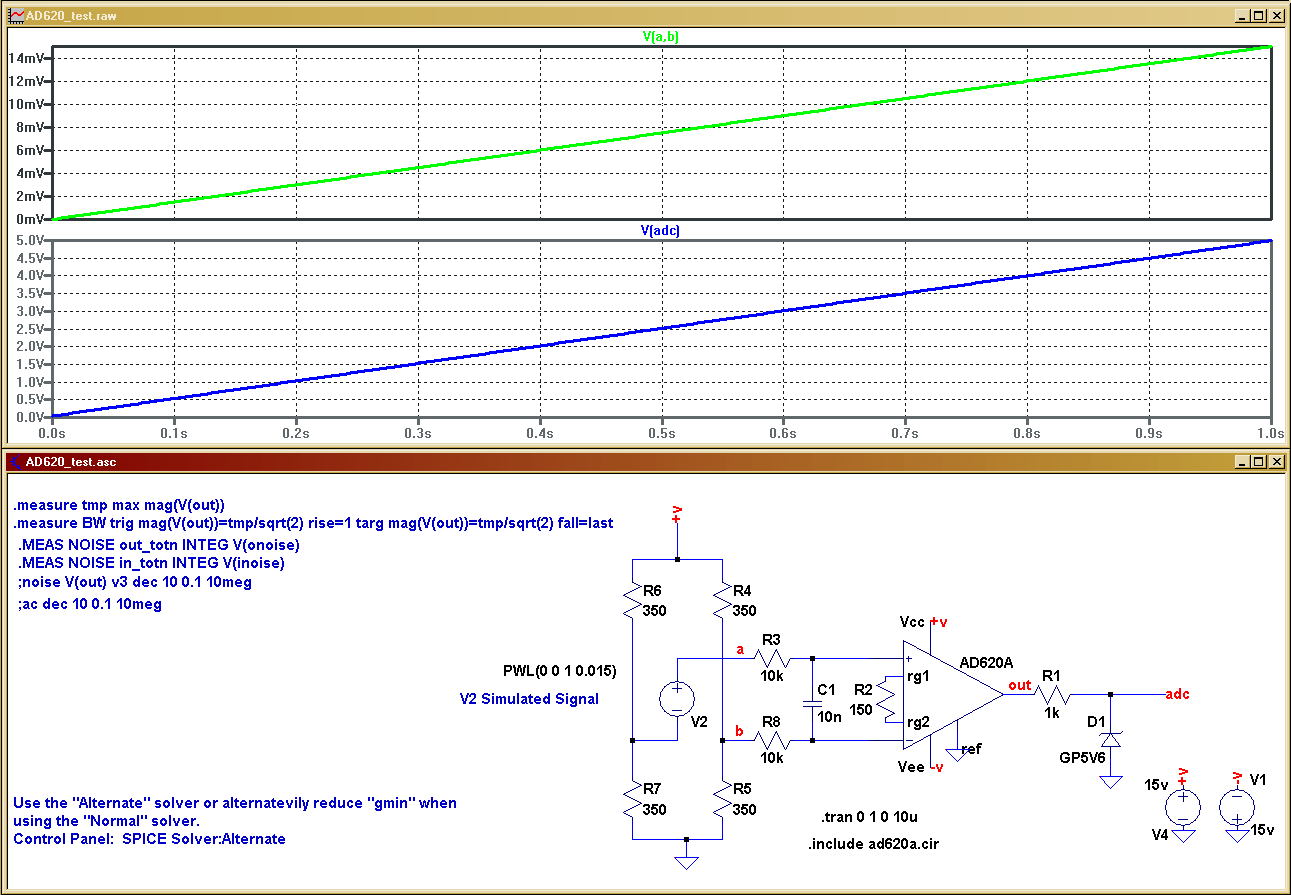

hi D,
This is the circuit config I would recommend, the image and plot are from an LTSpice simulation.
The V2 source is the sim load cell signal over the expected range of 0mV thru 15mV [ if over driven the Vout is clamped at ~+5.4v]
With the weight of the Base that carries the load cell you find that there is Vout shift from zero due to the weight of the Base metalwork.
To null this out, you could introduce an opposite polarity low level signal at the AD620 input, using a high value resistor and trim pot, or
apply an offset voltage to the Vref pin, this should be from a low impedance source and trimmable.
If you want the maximum load of 1 Ton, set the Gain to give a Vout of 4.88V at 1 Ton. This will give 1000 counts from the ADC.
It makes the PIC's maths easier.
Eric
