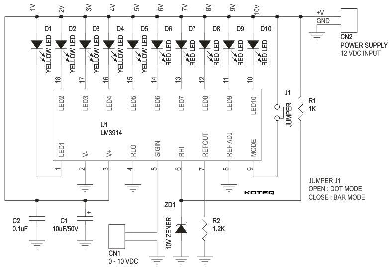

Hi, So I want to make some kind of VU meter + adjusting tool for my modular synth modules. I decided to use TL431 as a reference voltage source so I can set 10V or 5V with a flick of an switch. When I connect this reference voltage of 10 volts to the 6th pin of the LM3914 and following this circuit for the rest I got absolutely nothing outputted on the LEDs when I tested it with a 9V battery for input.
I removed the zener diode and the 1K resistor thats connected to it and connected it to the reference before all of this. I saw that when 6th pin is connected to the TL431 the reference voltage dropped down to 3.5V and recovered when I disconnected the TL431. So I assume the LM3914 is drawing some current from the 6th pin which was something I did not except. Should I buffer the reference or am I missing something.
Post the circuit you used with the TL431 - you are aware that the minimum voltage from a TL431 is about 2.5V, and above that is set by two resistors.
Also, if I recall correctly?, you want the LM3915 for a VU meter, the 3914 is linear, and useless for VU.

TL431 circuit is the one you said, 1K resistor to cathode and two 10K resistors to get 5V but instead I add 2 more 10K resistors series with the R1 so I could have 10V and have 5V with a switch that shorts those 2 10K resistors when needed. But for testing it was essentially 30K for R1 and 10K for R2.
I know you need a logarithmic response for a VU meter but I already have a real analog VU meter I will make a circuit for so this one is more for adjusting the pots on the synths and having some random moving led when not doing so. It is like resting 8 years in my toolbox so I wanted to use it for something while waiting for new parts to ship.
I've not seen it's datasheet for a few decades, but what are the current requirments for R1 and R2, are 10K and 30K low enough to pass enough current.
As for the 3914 you will be VERY disappointed with it, as it's completely useless as a VU meter.

Your circuit looks good. It should work as you've shown.
Recheck parts, wiring, voltages and currents.
The LM3915 audio meter IC ain't made no more no more. Because I was probably the only person buying them.
The LM3914 linear meter IC is still made in a surface-mount package.
A VU audio meter needs logarithmic, not linear steps.
Both ICs already have an excellent adjustable reference voltage (pins 7 and 8) so why add an external reference voltage??
So can you adjust its reference voltage and it doesn't move when power supply voltage changes. Then you are right tl431 is not needed. I shall search this more.
