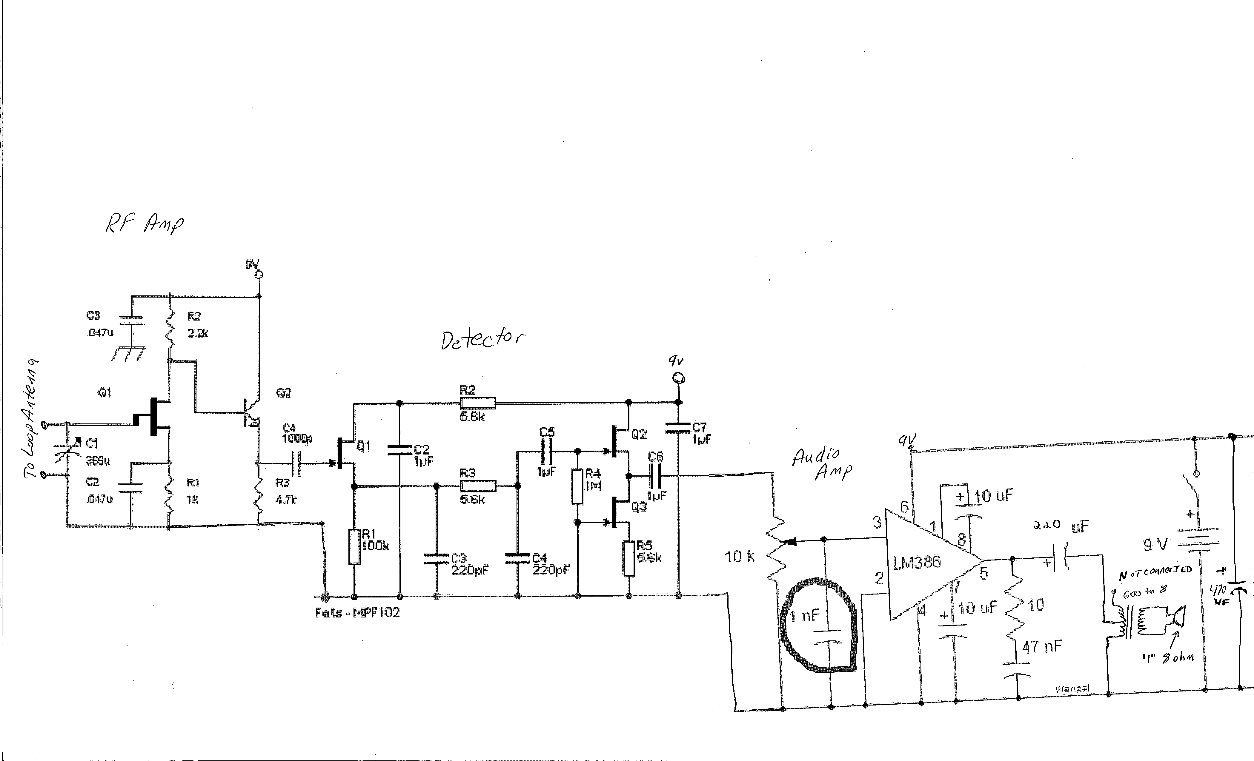

I was working on my little radio last night and trying to improve the output of the LM386. Two changes I made seem to have had a huge effect on the output volume. The first was to use a small audio transformer between the output (pin 5) and my speaker (not shown in schematic.) I understand why that helped. But, I also found a schematic online that shows a 1 nf capacitor going from pin 3 (input) to ground. Using that capacitor gave a large boost in output as well. Nearly all the other schematics I've seen online do not show this small change, but it sure seems important (at least in my circuit.) So, what does it do and why did it help so much? I understand bypass capacitors in a regular amp prevent degenerative feedback, but this doesn't seem to be the same thing. I've included the schematic.

I have built many LM386 amplifiers and I can assure you that something is wrong in this case.
In a correctly operating LM386, that 1nF capacitor across the input can do nothing but attenuate the input signal at higher frequencies. The 6dB (half voltage) point drop in gain will be affected by the position of the volume control and the source impedance of your detector output. But with the potentometer near the center of its travel, compared to the signal voltage at 1kHz, the voltage into the amp will be half (-6dB) at 66 Khz. At other positions of the potentiometer the half voltage point will be higher, so any attenuation caused by the capacitor will be well above the audio band- as it should be.
It sounds very much like the amp is oscillating, which would not be surprising as there is no high frequency decoupling on the supply line.
To see if this is correct place a 100nf or bigger ceramic capacitor directly across pins 6 and 4 of the LM386. If that does not work add a 10uF upwards aluminum electrolytic capacitor across the same pins in parallel with the 100nF capacitor (positive connection to pin 6). If that does not work you may need to look at the physical layout of the circuit.
The 1nF capacitor is there either as a botch to stop the amp oscillating or more likely to prevent radio signals from entering the amplifier. What can happen is that when AM signals get into the input of an amplifier the protection and parasitic diodes, fabricated into the chip, rectify the AM (detect it) and you get the radio station audio at the output. To do a proper job of the input filtering you should put a 1K resistor between the input potentiometer wiper and the capacitor.
You say that you have connected a 10uF capacitor between the detector and the amplifier. That will almost certainly be an aluminum electrolytic capacitor and will probably be insufficiently biased. There is already a 1uF isolating capacitor in series with the input so just remove the 10uf capacitor and replace it with a link (the existing 1 uF capacitor should be a non electrolytic, solid type).
The other thing you should do is to put a 470uF or larger capacitor across the battery. Can you say what type of battery it is because if it is small or badly discharged that will also cause problems due to the high source impedance. Can you measure the actual battery voltage with a meter while the amp is producing sound?
A final area of concern is the detector circuit on your radio: are you sure you are taking the signal to the amp from across the integrating capacitor in the detector. The other thing is that the detector source impedance may be sufficiently high that the input impedance of the amp is swamping it.
Moving on to the transformer that you have added to increase the volume. I am intrigued by this. Can you give some more details; the impedance of the loudspeaker would be helpful.

So, I have an oscilloscope now and was able to do some investigating:
In regards to question #1: Using my scope I've determined that the this change: "I found a transistor in my RF amp (the very first stage in my radio) with an emitter going to ground without an emitter bypass capacitor. Apparently the schematic was wrong OR the designer just didn't realize it was a problem. I haven't used the scope yet, but once I put a .047uf capacitor from the emitter to ground the 1nf became irrelevant AND the RF amp is giving me more gain now." - Actually distorted the amplified RF signal coming out of the RF amp. The wave was slightly misshapen and push more toward the positive side of the Y axis. (So the designer was not wrong.) I removed it, and although there was a drop in final output volume the sound quality was better. Interestingly, I did try a 470uf across the battery and that resulted in slightly better volume (not as much as the above change) and improved sound quality. It also eliminated the need for the 10nf previously mentioned, so that had something to do with the problem.
Question #2: Well, the speaker is a standard 8 ohm. It's pretty high quality about 4" in diameter and has a strong magnet in it. Probably much higher quality than most cheap AM radios have. Just changing from a cheesy 2" 8 ohm speaker to this speaker made quite a difference in both volume and sound quality. As to the transformer, pretty basic, it's a 600 ohm to 8 ohm audio transformer, however, I've determined that only using the center tap and not the full input windings is slightly better. Basically, one side of transformer to ground, center tap to the output of the LM386, and then the output wires (red and black) from the transformer to the speaker. This gives a very substantial boost in volume and quality. I'd say it's probably 2 - 3x as loud when using the transformer. Interestingly, this transformer also improves the sound and volume in a high impedance crystal radio earpiece. That indicates to me it may be doing more than just matching impedances. If I can remember, I'll try to scope the output with and without the transformer and see if I can figure anything out.

Yeah, this simple radio does not have any AGC. When you get a strong station it's LOUD compared to a weaker one.
I've attached the full circuit minus the antenna and one of the tuners (it has an coupling coil with tuner and the tuned main loop.)
Probably the biggest problems with this radio currently is that it has selectivity issues, stations that are closer than about 70 kHz are hard for it to separate and it's not as sensitive as some higher end radios like my Tecsun 880. However, it does pickup every station that would be considered to be in my listening area. The stations the Tecsun can pull in are very weak and long ways away, so the sound quality is quite poor and it only really gets those stations after dark. The super selectivity of Tecsun is very helpful in this regard. With my home made radio those stations would be drowned out by a stronger one in many cases.

The transformer should reduce the maximum output level. Half of the 600 ohm winding is an impedance of 150 ohms. The datasheet of an LM386 shows that with a 9V supply, its maximum output into 16 ohms or more is about 7.5V peak-to-peak which is 2.65V RMS which produces only 0.047W of power. But without the transformer the 8 ohm speaker gets 6V p-p which is 2.12V RMS which produces 0.56W, a lot more than 0.047W and the transformer loss was not included.
The AM "radio" that has only ONE tuned circuit and has a Jfet (Q1) that is missing a voltage reference of 0V for its gate because a resistor from its gate to ground is missing?
The low value of the output capacitor cuts bass frequencies when the LM386 drives an 8 ohm speaker but it passes bass frequencies when the transformer increases the impedance of the load on the capacitor.

Well, I don't know what to say, it's definitely way louder with the transformer in there. Maybe I'll post a sound clip.
Also, IIFC, I did add a either 10 or 1 meg resistor to the detector Q1 gate to ground (someone else suggested that in another thread), but my diagram doesn't show it (forgot to add it.) It does help slightly with the output. I don't have the actual circuit sitting in front me currently, but I'm pretty sure it's there. Or are you talking about the RF amp Q1? I'll check that tonight and see if adding a resistor there helps if it's missing.
As far as the output capacitor, it original circuit only called for a 10 uf and I upped that to 22o uf which seemed to improve the sound a bit. More than 220 uf doesn't seem to make much of a difference.
Since your transformer cuts the output voltage swing then it also cuts the output current and reduces the current from the battery. Maybe your battery cannot supply enough current for the amplifier to produce 1/2W?
Maybe you have a cheap Chinese fake copy of an American LM386? A cheap 9V battery? Did you buy them on ebay?
A simple calculation shows that 10uF feeding an 8 ohm speaker cuts frequencies below 2000Hz, 100uF cuts below 200Hz and 1000uF should be used for audio if the speaker is half decent. The 220uF capacitor is fine feeding the 150 ohms of the transformer but cuts bass sounds when feeding the 8 ohm speaker.

Now, that I'm home I double checked everything. You are correct. I mis-labeled the output capacitor it's a 330 uf not a 220 uf. Also, for some reason, probably a bad connection somewhere, now when I remove the transformer the sound is a bit stronger but more "tinny", so you are right about the "feeding" of the transformer vs. straight through. The sound quality is much better going through the transformer. So, you were right on the transformer thing. Although, I'm still puzzled about why I had the original problem. Also, I do, in fact, have a 10 meg ohm resistor going to the ground from both gates of my MPF102's (detector and RF amp.) Either way, the end result is that I understand what's going on. My next project is going to be trying to improve the selectivity of the radio. I think I will still post a sound clip of the output because this radio really sounds pretty good for such a simple design and the fact that I clobbered it together from various schemetics I found on the web.
