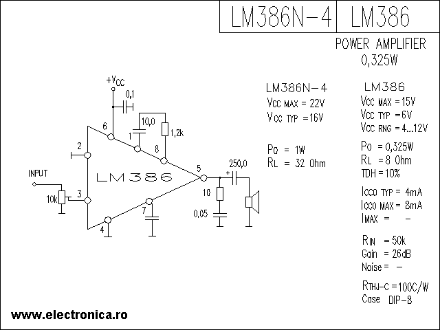

Make the LM386 circuit that is in its datasheet.
Its minimum supply voltage is 4V where its output power into 8 ohms at clipping is only 0.07W which is almost nothing. You are powering it with less supply voltage so if it works then its power will be less.
It won't have interference if it is built compactly on a pcb and the input cable is shielded audio cable.

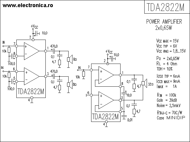

A TDA2822M works with a supply voltage down to 1.8V!
It is also in an 8-pins case but is two bridged amplifiers for double the voltage swing than an LM386 and therefore its output power is about 4 times more at about 0.28W. It is still a very small amount of power so keep the volume control turned down low enough so the amplifier does not clip.
A schematic and a pcb design are in its datasheet.

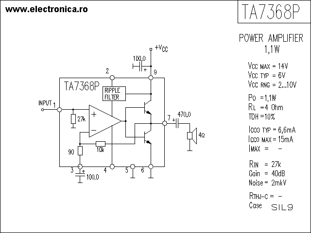

TA7368P is an excellent audio power amp designed by Toshiba for portable applications. It has very low distortion and noise probably not at all!!
It works well with a couple of external comps and doesn't even need an input coupling cap :p. I've made it as a rechargeable ipod power amp(6v).
Since 1yr I'm enjoying good music thru that. The 4*AA rechargeable battery lasts without any distortion for around 2months, half hour usage perday!
Vcc(2-10V,avg 720mW)
It has the same low output power as the LM386 power amplifier because it is a similar single-ended copy.
I've assembled LM386 only once and dropped into my toilet and flushed well with plenty of water!
It is suitable for testing an audio sound because it amplifies.
It is not good for a dedicated application because it produces audible noise even at low-gain configuration. No need to say about higher conf!
TDA2822 requires higher load resistance at bridge configuration. A really mess circuit. It is mainly intended for stereo apps.
TA7368P has a lowest possible simplified application circuit. I can't hear a little bit of noise when the volume control turned full up at no signal condition. When a signal is inputted it neatly amplifies and gives a smooth output :)
NB: I have first seen TA7368P on the output stage of a Philips radio receiver(guess LM386 in place of that). Philips have used LA4510 on the output stage of 3v walkman superheterodyne radios(old).
No.
Its datasheet has its bridged spec's with an 8 ohm load and a 4 ohm load for the more powerful 14-pins TDA7822 version.
The datasheet for the little TDA7822M in the 8-pins version has its bridged spec's with a 32 ohm, 16 ohm, 8 ohm and 4 ohm load.

It will work fine at 2v. 2-10V is acceptable by the IC. Normal operation is at 6v providing an output power near to 1W.

It (the Toshiba TA7368 IC) will work fine at 2v. 2-10V is acceptable by the IC. Normal operation is at 6v providing an output power near to 1W.
No.
Its output power with a 3V supply and an 8 ohm load is only 80mW at clipping. With a 2V supply then its output power is much less, maybe only 10mW which is almost nothing.
1W into 8 ohms is a voltage swing of 8V p-p. The swing into 8 ohms with a 6V supply is only about 4.4V p-p. The datasheet shows it clipping with an output power of only 300mW when it has a 6V supply and an 8 ohm load.
Its output power when it has a 6V supply, a 4 ohm load and severe clipping with 20% distortion is 900mW.
