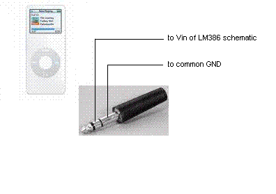

I've added a picture for connecting single channel to the mono amplifier LM386. 10uF not necessary as the minimum gain is OK for iPod output level.
If necessary, you can add a mixer in between for inputting the stereo frequencies.
My iPod audio amp:)
