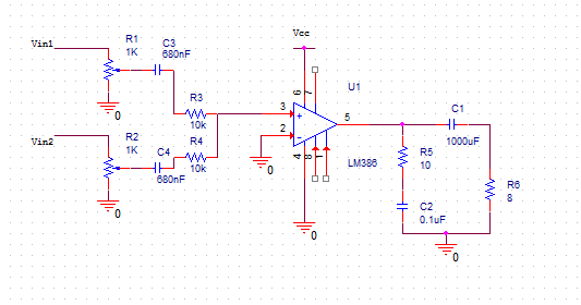

Lm386 amplifier
would like to do two inputs on it.

Yup, that's basically what I had in mind, but I wasn't sure whether to spell it out quite so bluntly or not. That is probably the minimum configuration for doing it. Here is a quick sketch of what I guess I imagined (I haven't checked all these values to see if they work or not):
Adding a cap across pins 1 and 8 and a bypass cap will increase the gain as per the OP's original reference material. The values of the potentiometers R1 and R2 may need to be changed if the signal source being used can't drive a 1k load (OP has not stated the application). Something like a computer headphone jack or sound card meant for driving 32-Ohm headphones should have no problem driving a 1k load, but other signal sources may depend. My coupling capacitor values are selected for a roughly 20-30 Hz cutoff frequency, which may be a bit overkill here.

Looks good, 680n caps nice touch, even less 470's might be an idea, max audible volume would probably increase as I doubt this circuit will be used with a speaker that can reproduce less than 80hz or so anyway, so theres no point wasting power trying.

Hi JLNy thanks for that schematic I will try this.

Glad I could help. Fair point about the caps, Dr. Pepper. 470nF should be fine as well, or even lower if those aren't available, but I would try not to go lower than about 180nF for C3 and C4.
Also, I think you may be over-thinking Alec's question a bit. :D I think his main question (and my question as well) is simple: what is your input device? is it a computer? a phone? a guitar? an Arduino? A bit of context as to what you are using and what you are trying to do with your circuit would be helpful. If something we said is too complex, just ask us to clarify. It's not a bad thing to ask questions, even if they seem basic. :)
The reason that knowing the input device is important is because different devices will have different output impedance and output signal levels. Something like a guitar pickup has a high output impedance and might not be able to drive a low impedance load like in my schematic. A source with too low a signal level might need more amplifier stages to drive the LM386, and too high a signal level might overdrive the chip at all but low volume.

Ah, that could be a problem, then. If you are going to be driving this directly from a guitar pickup with no preamplifier of any kind, it will likely not be able to drive the 1k potentiometer at the input. The microphone for voice will probably also need a preamplifier, but the exact configuration will depend on what kind of microphone it is. I am sure there are many schematics online which you can use for microphone and guitar preamps. If the guitar has some kind of active preamplification, it might be okay, but I am by no means an expert on musician's amplifiers.
The volume control resistances are much too low at 1k. Many circuits cannot drive it. Use 10k or 20k.

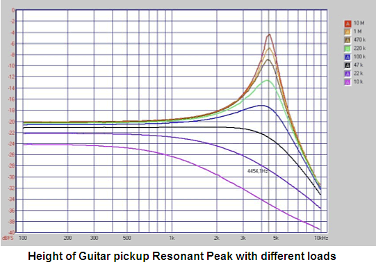

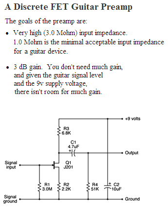

A guitar magnetic pickup must have a high resistance load. Usually a vacuum tube or a Jfet is used. It does not need much gain because the pickup output level is high. The resistance of its load determines the amplitude of the medium-high audio frequency peak that is a resonance that creates the "twang" sound of an electric geetar. Here is a guitar preamp that has 3M input resistance and a graph showing the peak determined by the load resistance. The gain of this preamp is fairly low.
ok the one input that I have has 10k volume. maybe I try the two input scheme with 10k and see what happens.

My graph of the frequency response of a magnetic guitar pickup shows that with a load of only 10k or 22k its high frequencies are cut very badly, much worse than an AM radio. Do you like the sound to be muffled like that (or are you deaf to normal high audio frequencies)? The guitar preamp circuit I posted has an input resistance of 3M which is 300 times higher than 10k. Look at any guitar amplifier and see input resistors of at least 1M.
Perhaps instead of using a discrete JFET, it may also be possible to just use a JFET-input op amp like a TL072 as a buffer. TL072 is a dual op amp so you would be able to buffer both inputs with minimum parts count. EDIT: if you are using a single rail supply, you may need some biasing resistors and a capacitor on the input.
