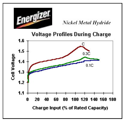

You don't need to limit the charging voltage. The battery limits its own voltage.
Go to Energizer's site and look at their Ni-MH battery applications manual. A cell's voltage is only 1.35V per cell when fully charged at only 1/10th its mAh rating.

1.6V per cell is too high and the cells will overcharge.
Look at Energizer's graph I posted. At a charging current of 1/10th the cell's capacity it is fully charged at 1.4V and will never reach 1.6V.
Your circuit will keep pumping 250mA overcharging current into the battery forever. Energizer says its life is shortened by overcharging.

Energizer says to reduce the trickle charge current to 1/40th of the cell's rating or its life will be shortened.
