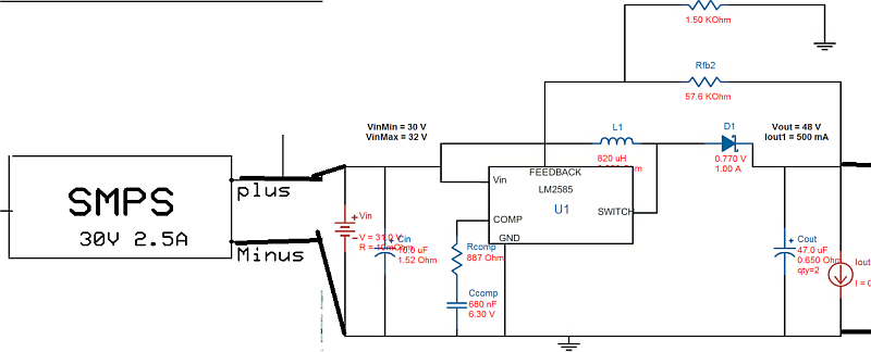

Here is the circuit
within a micro second LM317 Malfunctioning then when i rotate pot to zero full current flow throw 220 Ohm resistor via pot wiper to LM317 ground and 220 Ohm resistor burnt out.
what is the stackup? that causes microsecond malfunction? Sketch a a diagram of all connections.

Show complete schematic Like I did except show all inputs and outputs and where short occurs.
correct any assumptions I made below

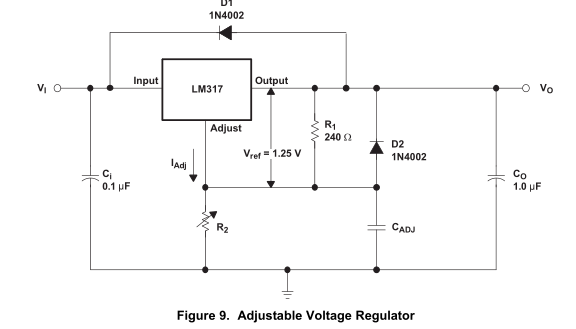

When the combined output is short circuited there will be over 60 volts between the input and output orf the LM317 (The unregulated input to the LM317 plus the 30 volts from the switch mode PSU.) I suggest putting a large diode (10 amp or larger) across the output of the LM317 regulator and adding a 1 amp fuse to the output og the LM317 regulator. (The diode should be on the LM317 side of the fuse.) This way the output of the LM317 will not be forced more negative than about 0.7 volts when there is a short.
Les.

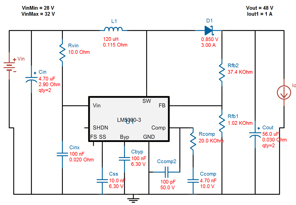

For next time.......
Fantastic Idea Tony !!! it could be a good idea for over 36 volts variable single source power supply when i have not any source of over 30Volts I will implementing this farther next project.
Les.
Hi les Jones is this way?

Hi ataul,
Yes, that is what I meant. I have also just noticed that you do not have a capacitor from the output of the LM317 to ground as shown in the data sheet. I think building a supply designed for the voltage you require as suggested by Tony would be a better solution than connecting supplies in series.
