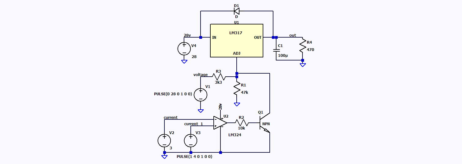

lm317 cant changing adjust pin voltage
Try this simplified arrangement :-
  • VregIlimit.asc
Note that the current limit will not work when the output gets below 1.25V (e.g. a short).
Working.. Also in simulation , also in appliance. Many Thanks.
But another problem is voltage drop of output. For example oıtput without load there is 24v. On 33ohm load , it drops to 14 v. I know this happens because of the no feedback. Although i change control voltage , output cant move back to 24v. Only goes about 20v.
What can i do for that issue ?
Did you measure the regulator input voltage when the load was 33 Ohms?

Yeah your right. Input is fallin about 25v. so 22-23v output becomes normal. I didnt notice input is falling ! It musnt be fall like that. Because i have 20,5v 11amps transformer. Huge transformer. Shouldnt expect voltage drop on input cause of that huge transformer.
And yes im currently tring on breadboard. First circuit was on printed board.
Transformer is like that one. Seperated two 115v primar winding. Out is 20,5v 11amps.
?? The transformer in the link has a 30V output rating.
A 20V transformer has a peak ouput voltage of 20*1.414 = 28V. A bridge rectifier will reduce that to about 26V under load.
Breadboards are not designed to handle high currents and their contact strips do not provide reliable connections. Some voltage drop might be experienced there.
What is the size of the filter capacitor at the rectifier output?
And yeah i forgot to calculate recrifier forward voltage drop.
