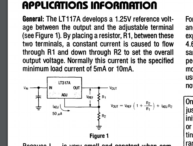

I've seen many adjustable 317 configurations over the years, but this is a very weird one.
My understanding is that, as Alec_t has already mentioned, that a resistor between Out and Adjust terminals is mandatory. I never seen a *proven* configuration without one. If anybody has seen one that is proven to work, please let me know.
In National's original datasheet, there was a typical application for a 4 amp adjustable regulator, which consisted of a master and two slave LM317s.
The master had the resistor between Out and Adj, and the slaves had their Adj terminals connected to the master Adj terminal. Since all Outs were wired together via very low value resistors, in an indirect way the slaves also had a feedback resistance from Out and Adj.
And the overall feedback was controlled with a PNP and an opamp to adjust the voltage.
The resistor is only required to set the current through the divider chain, when used with setting resistors.
The reg also needs a minimum load current as the internal circuits use the output as negative power.
(That's covered by the 470 Ohm load on the overall circuit).
An extract from an early data sheet that clarifies the point:
That is for using a potential divider to set the ref voltage; with an active control, that should not be needed and could upset the opamp circuit?
Good point. Simulation confirms the output should be adjustable over the expected range without the Out-Adj resistor, provided the minimum load current is drawn somehow.
