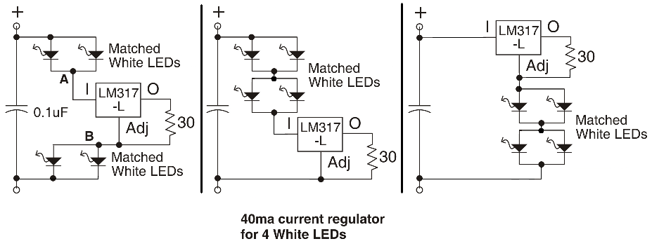

If you have two 3.4V LEDs in series they need 6.8V and the LM317 current regulator needs an additional 3.25V so the minimum supply voltage will be 10.05v and will not work with only 6V.
The circuit shown can be wired in many ways since everything is in series.

An LM317 current regulator needs a voltage of at least 3.25V for itself in addition to the voltage needed by the LEDs.
How do you get equal brightness out of two LEDs wired in parallel?
You don't, you should wire them in series, or connect each LED with its own series resistor.
To be picky no two LEDs are the same so the brightness will vary subtly even if they're connected in series.
Look at the schematic. You match their forward voltages by testing and documenting the forward voltages of hundreds of LEDs and matching them.
Cheap Chinese flashlights (torches for limeys) have many matched LEDs in parallel. You cannot see a difference in brightness. But it will be difficult to replace one.
