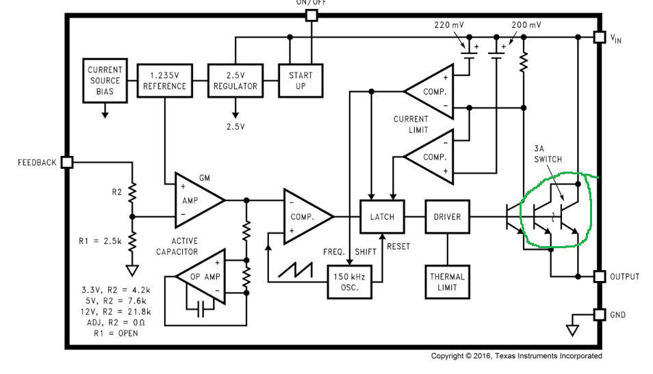

How much is VCEO in LM2596D ?
I asked it because I see 23.5V spikes when the switch goes off! my input voltage is 12.5 and out is 5 .

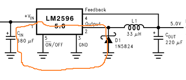

I mention it on this picture:
Where are you seeing the spikes?

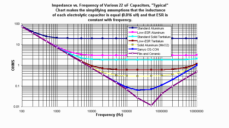

If the spikes are on the input, that could be caused by insufficient decoupling of the Vin pin. You want some ceramic capacitors on the input. Electrolytic capacitors probably have too much inductance to be effective decoupling on their own.
If the spikes are on the output, that could be caused by too much inductance in the wires going to the Schottky diode.
The loop shown in orange is the path of the high power alternating current. Other current paths are low power or low frequency. It is important that you make the area of that loop as small as practical on your layout.

Capacitance ESR varies significantly for various technologies :
OSCON is polymer tant, best in class for large bulk bypass caps.

It is between Vin and output pins or pin 1 and 2.
When the switch has just turned off, that voltage should be the sum of the input voltage and the forward voltage of the Schottky diode, so around 13 V in your application. When the inductor current gets to zero, the voltage will fall to the difference between the input and output voltages, so around 7.5 V in your application.

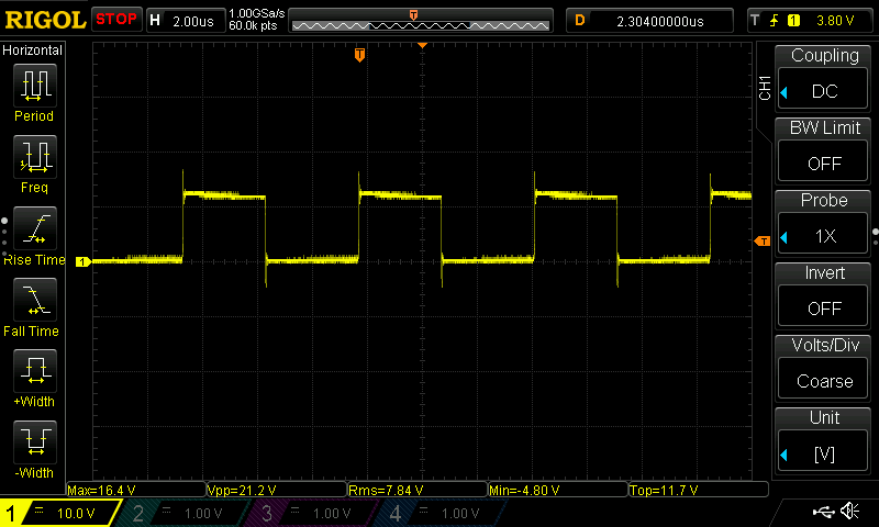

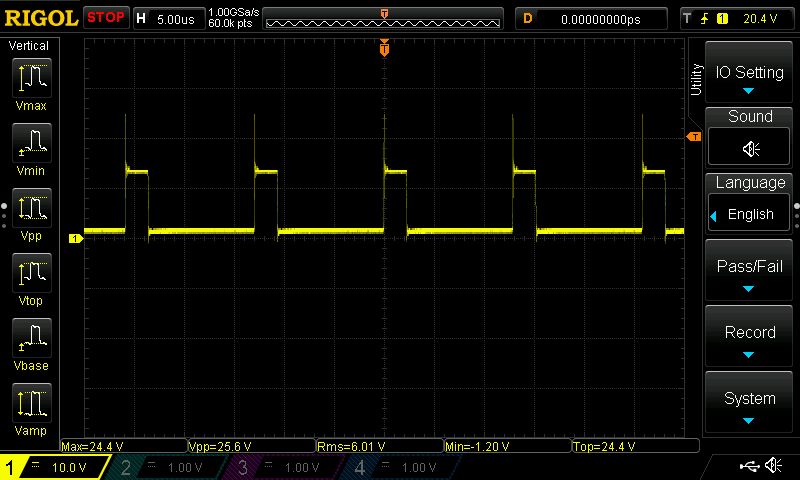

Test condition is:
Input voltage: 12.6V
current consuming: 1.3A
Output voltage 9V
Ground to Ground
Tip to pin 1 of LM2596
Ground to Ground
Tip to pin2 of LM2596

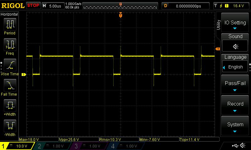

Ground to pin 2 of LM2596
Tip to pin 1 of of LM2596
There's something wrong with how the circuit is working. The average voltage across the inductor should be close to zero, so the average voltage at pin 2 should be only just above 5 V. The switch should be on for less than 40% of the time, as the output voltage is 40% of the input voltage.

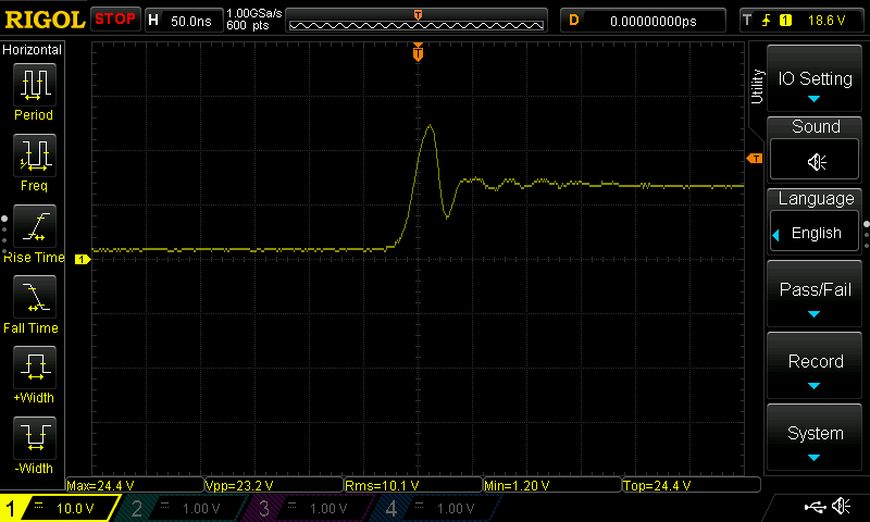

Can you send more details about the circuit. Also, the switching waveforms in more detail at the points when the switch turns on and off, with a timebase of maybe 50 ns/division.

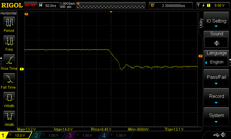

Please read post no.8 again I add some inf. but if you want another information let me know .
Ground to pin 2
tip to pin 1
turn off:
ground to pin2
tip to pin1
Turn on:
My wave form is exactly like in the condition that document says long Ground prob condition!!!

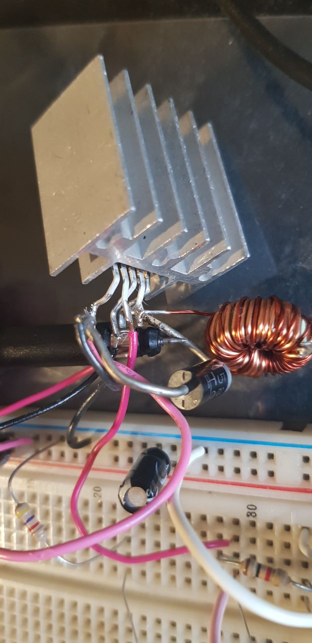

It certainly looks like the sort of ringing that I've seen with ground connections being too long. Can you show us what the circuit looks like?
If you have oscilloscope leads with metal ring just a few mm back from the tip, try to make the measurement with a direct link, as short as possible, from that to the circuit ground. I've used a knife blade or pin to make that connection, or soldered a short wire to the ground pin, and bent that so that the ring can touch at the same time as the pin touches the point to be tested.
Also, you should never put a ground wire to pin 2. Post #5 says why. It would effectively be making the ground wire longer as the voltage of the whole oscilloscope chassis will have to change each edge.

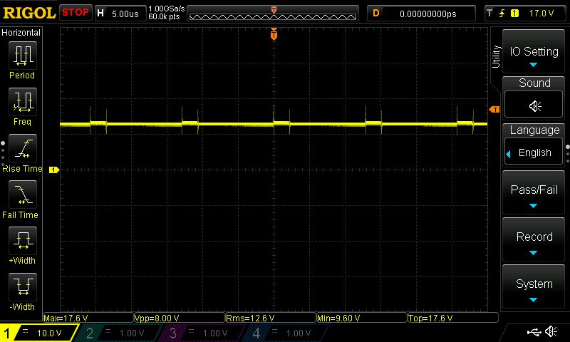

I had assumed that the output voltage was still 5 V, as that is what you said in the first post. The waveform seems fine for 9 V out and a significant output current.
What is the inductor value?
The board is going to be a QC.3 charger which is 9v and 5v ...
inductor value is 34uh but I used a toroidal core from an old motherboard.
Can you try to measure pin 2 on the tip, and pin 3 to ground?
This is the board:
Ground to pin3
tip to pin 2
in 12.4
out 5v 0.8A
