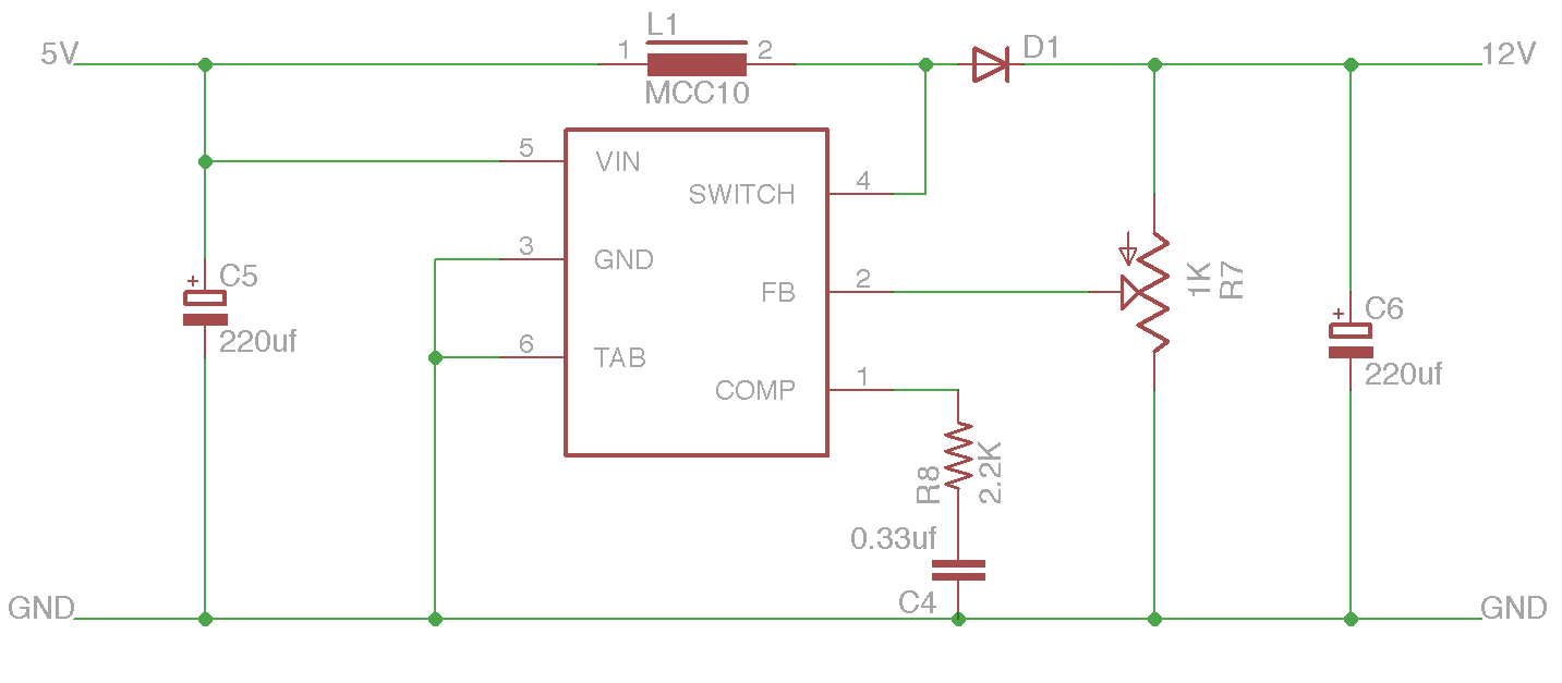

I think its time we had a schematic, and a picture of the PCB layout :D
If you're worried abotu others stealing your design or something, of course just the SMPS part would be ok. Also, I just thought - to eliminate any problems there might be after the switcher - the rest of the circuit its powering, have you powered this by 12V from a separate supply and checked the current draw? I mean, if that is drawing a lot of current, then it could be that is the problem, and the poor switcher on your PCB is trying to keep up. I may have missed a previous post where you have already checked the rest of the circuit, so apologies if you've already tried.
Also, the partnumber/datasheet (even a photo if needs be) of the inductor you're using on your board would be handy.

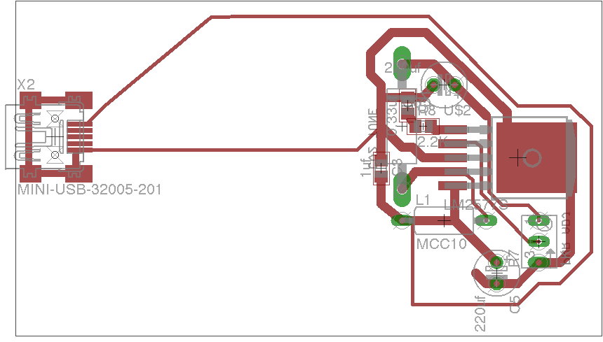

Well, I've only mounted the power circuitry so far. knowing the tendency things have not to work first time I thought it was wise to leave the rest of the circuit out of the equation rather than risk killing it the first time I powered it on! so as far as schematics go I've literally just got the same as the circuit I first linked to:

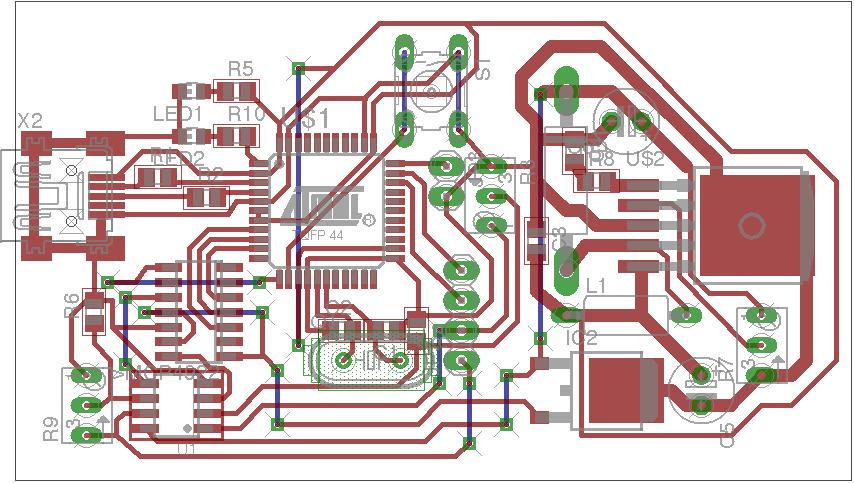

board layout of the final circuit looks like this:
But given that the rest of the parts aren't mounted what I effectively have is this:
As you can see the inductor I was originally using was a weedy little axial leaded RF choke type, so now I'm kind of limited to trying to find an inductor which will fit the space I left for it!
Do you think the thin trace going from the 2577 to the inductor could be causing problems? I know the traces should all be as thick as possible but it was the only way I could see to route it! as you can probably tell it was originally designed to be home etched single sided with jumpers. In retrospect when I decided to have it fabricated properly I should have gone back over it to see what I could improve knowing that more vias and traces on the other side were an option!
(EDIT: Could have added a ground plane too!)

At this point though I'm beginning to think that it must be my board design that's to blame. Should have done more research about SMPS before I made it!
Nice! ok, lets see.
The layout is less than idea, but... should be functional. With a linear regulator and microcontroller being powered by your supply - I can't see this drawing more than 50mA from the LM2577 circuit. That could be a problem as even though we look at the 'maximum' current a SMPS can supply, with these simple switchers, all the datasheet references expect a load current quite high, often > 1.0A.
There isn't a ground plane, and the trace supplying power to it from the USB is indeed very thin, but should be good for a few 100mA. There are a couple of traces going under the chips pins - one of which is the feedback line.
This can be prone to noise (any high current traces) but given that you've got it going straight to a pot, that should load it down enough to keep its output steady. The lack of ground plane or heavy ground traces can cause all sorts of issues which I won't go into (another big post maybe?)
Ok, even though the layout isn't great, I'm sure you can get it working without changing that, and the biggest issue I can see so far is the inductor.

Although, there's an elephant in the room - your ebay module probably has an inductor of 100uH, and yet it works fine? This can only mean that 100uH is 'fine' providing it is of high enough current rating, or.. the switcher on your board is screwed, or the layout causing it to switch erratically, or... the compensation network isn't right. - thats a lot of things to check :/ I can be hard to measure the current in the inductor, and difficult to see whats happening in the ebay module without a scope.
The compensation network. Pg19 has an equation for calculating R, we don't know the value on your ebay module but we can calculate what it 'should' be based on your specs. You can plug in your numbers, but I get a maximum value of: 1066ohms,
or '1k' will do. This is based on vout of 12V, vin(min) of 4.5, and Load current max of 200mA.
Similarly for Cout, I get 79uF. and CC 130nF.
These numbers, although nicely calculated, are a bit of a joke from the datasheet, because they are specific to a certain load current.
So, after all that theory, practical things to try. Although it could well be layout (its not helping) here are things to try.
- Add a load current, say 100mA, for 12V out thats a 12 ohm resistance. If you have any power resistors it would help because we 're going to dissipate 1.2W. Check if anything gets hot.
- Replace your switcher chip on board with a new one. If its regulating, then its probably 'not dead', but you never know, sometimes broken chips can behave oddly.
- Replace the inductor with a 100uH one, specced at 3A Isat. Also you could try a 220uH, and even a 330uH, these will require lower saturation currents, say 1.5A.
I strongly suspect that the only real difference between your board and the ebay one (aside from layout, lack of ground plane and thicker traces) is that inductor. Its higher saturation current means it can take a higher current ripple without saturating.
The thin trace going to the inductor? yes, very much so. Even when the current is fairly low, a thicker trace provides lower impedance. I often design boards to be home etched and end up accidentally leaving jumper links on the design when sending it out for manufacture, and yes, took me a while to be 'liberal' with via's, double side traces and thicker traces when having it built - because I HATE drilling boards, and double sided ones are just a hassle.

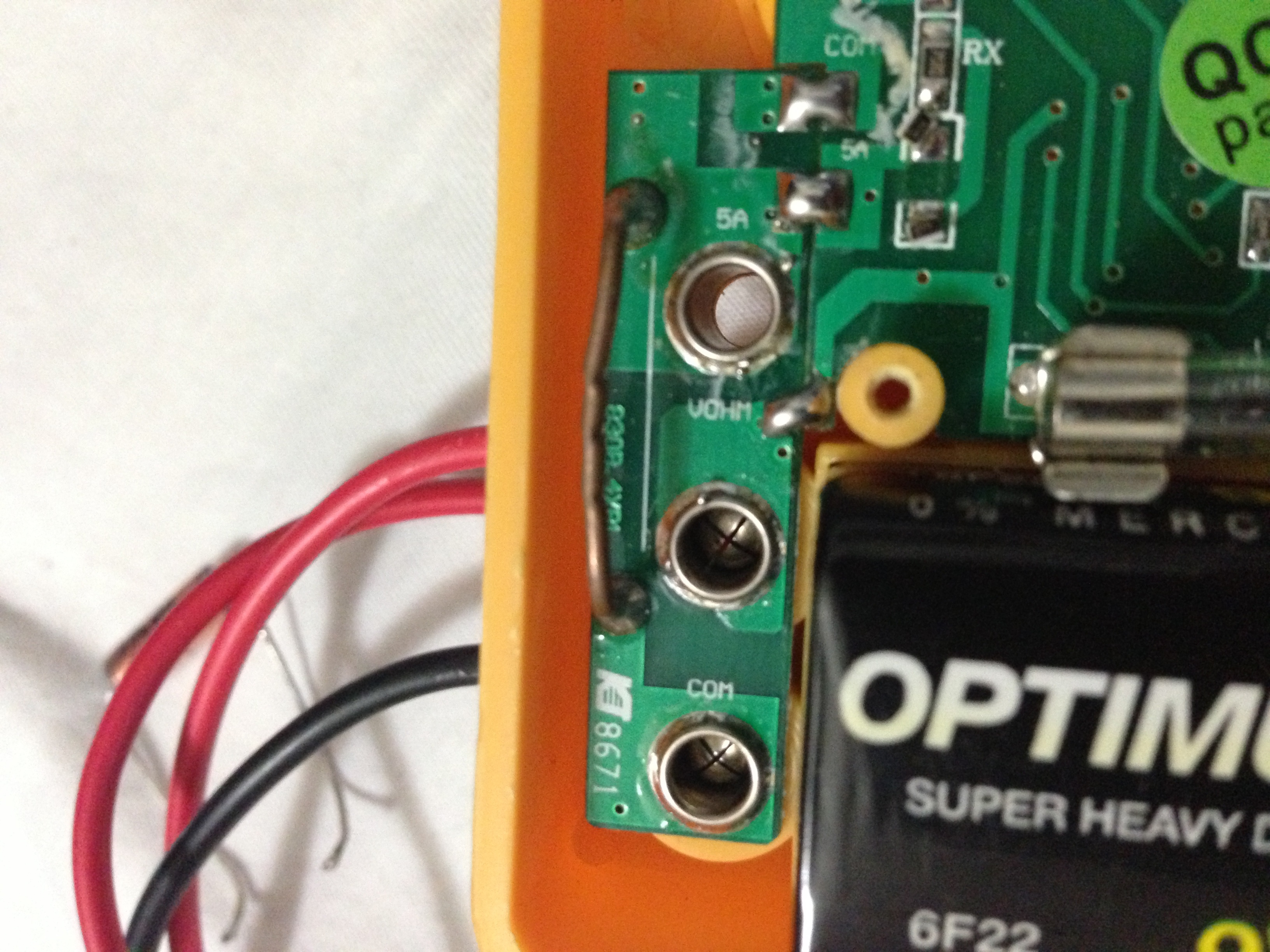

Glad you got it working man, don't forget to replace that fuse on the multimeter, ended up getting a pack of 50 for mine since I seem to blow it weekly. Good luck!
Yeah it's weird, the pot wasn't fried cos I could still adjust the voltage, typical it's always the last thing you think of though! I've now made myself late for work adding the micro and associated bits. I can plug it into USB and have it recognised now with all voltage and current readings as expected. All that's left is to add the DAC and the op amp, then I can upload the code and I'll finally have the MIDI to CV convertor I need to control my DIY synthesizer!

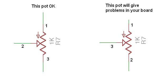

Hang on a minute!
I think I know what the problem could be.
Have a look at my attachment.
There are different pin configurations for pots.
Check and compare your two pots to see if the one which gives problem is like the second one I have drawn.
Whaaaa? Whoever designed the one on the right is sick in the head!!

OK, fair enough.
I am sure I had one somewhere with a weird pin-out, but cannot find it in my usual places.
Hey Ho!
Your converter is working, end of problem.
