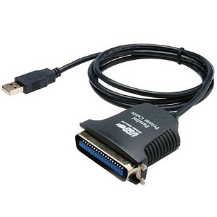

Usb is not going to work so say good bye to your laptops
You need a USB to port adapter be it parallel port or serial
Or this

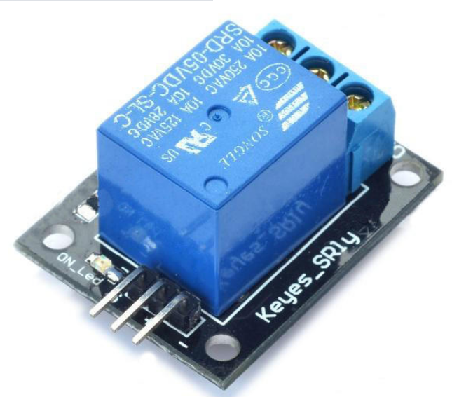

Then you need one of these

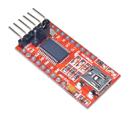

And basically a arduino is a way to let your laptop do things in the world plus you get write your own code
It gives usb to serial then the avr chip gives you ports you can switch or read
And like Mike just said But I'll say how I would tell someone USB is useless without something on the end of the cord that can talk USB
It would take a long time just to learn how to write your own usb code let alone a driver for your computer then your back to having to have a uC on the end of your usb cord or buy one of the above "USB to port adapter be it parallel port or serial"
Or get a cheap 3 dollar uno or learn how to use a bare chip AVR or PIC or any of the one's that have USB and code you could learn from.

If you want to use just your computer for this, then I think that a USB to parallel port adapter controlling relays would be the easiest way to go for you.

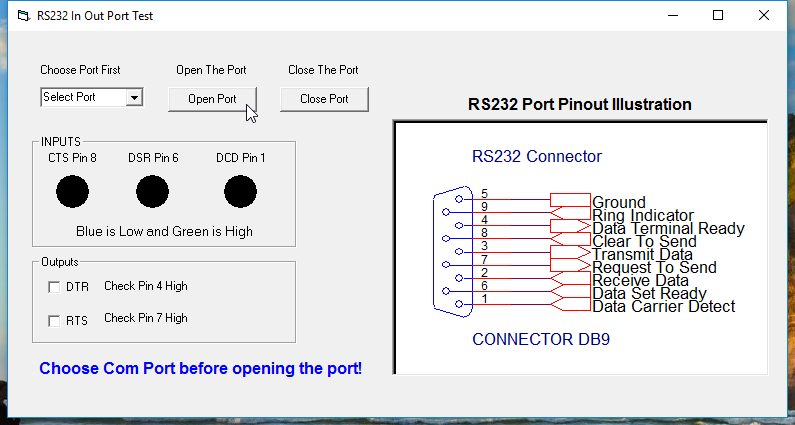

I guess if I wanted to play around with parallel port today I would run with a USB to Parallel Port adapter as crutschow suggested. Another little slick trick is using the RS 232 port which now are all but extinct on motherboards today. Less using the data lines. The DCD, DSR and CTS inputs of a RS232 Comm Port can be used as digital inputs and the RTS and DTR outputs can serve as digital outputs. I did write a little routine to use these RS 232 pins. I used an old Keyspan USB to RS232 adapter and what becomes important is the pin outputs and inputs are not to true RS 232 specifications. My experience was outputs high were 5 volts and outputs low were -5 volts, inputs were low 0 volts and high 5 volts worked just fine. I have an old Belkin adapter USB to RS232, parallel port and USB ports but the last drivers were for Windows XP. :(

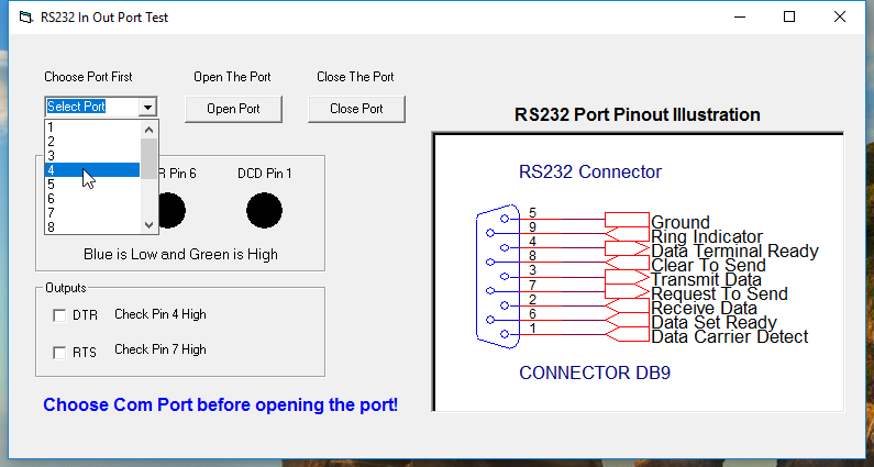

If anyone has an interest my RS 232 Program can be downloaded by clicking here. The user interface looks like this:
Important to first choose a comm port.
Then just open the port and when done close the port. Also be it an old parallel port or RS 232 port using adapters make sure you know how much current a pin can output (source) because in many cases a transistor driver is needed if you plan to drive relays to turn things On/Off. :) The above runs fine on Win 98 through Windows 10.
