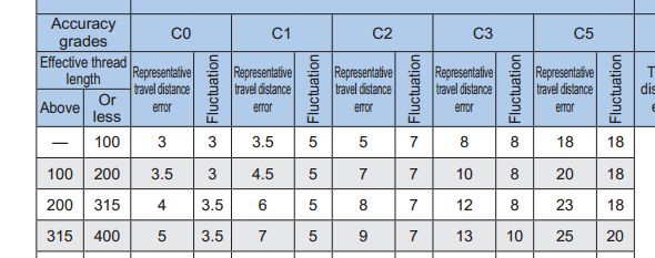

You might be able to get within 50 micron with a ball screw and appropriate design. Here are ball screw precision limits. Errors are in microns; lengths are in mm.
C0 is the highest class made, and would still not meet the 2 micron specification. However, if you go to a more common C3, you might get an acceptable level of precision. Precision ball screws will often come with a chart showing actual lead errors for each screw. You can use that information to improve your precision. A precision of 50 microns (0.001") is much more easily attained.
