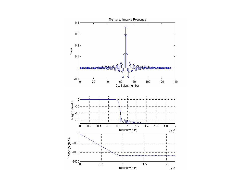

What is meant by phase response of a signal ?
Why do we need a linear phase response o/P from a filter ?
A pulse can be represented as a series of harmonicly related sine waves. If the harmonics are phase shifted relative to one another, the shape of the pulse is changed. The best result is obtained when the phase shift is linear.
BTW, is that a real filter or theoritical? Such sharp cutoff in a linear phase filter is impressive.
I'm guessing it's a finite impulse response (FIR) digital filter. Realizing that response in an infinite impulse response filter (such as an RLC filter) is basically impossible.
Linear phase is a RESULT of making a non-causal digital filter causal. Digital filters are inherently non-causal, however they can easily be shifted by N samples to become causal, hence linear phase shift, you're adding delay to make the filter causal.

If you review your DSP you'll find that one of the primary advantages of a FIR filter (which is what you have shown) is they have linear phase shift. The reason for the linear phase shift is the idea of causality. Initially when the FIR filter is designed it depends on FUTURE values of time (non - causal), to solve this problem we simply shift the filter by N samples to force the filter to depend on past samples (causal). Intuitively this make sense as we cannot know future samples, but we can store past samples to use them later. This is the reason for the linear phase shift that is introduced into the system.
yes, but we also do not store past output values in an FIR Filter, we do that in an IIR Filter. Another condition is that the Filter zeros should show even/odd symmetry.. H(n) = +/-H(N-n). Whereas we do store past o/p values in an IIR Filter. So this makes the IIR Filter have not such a good phase linearity !
