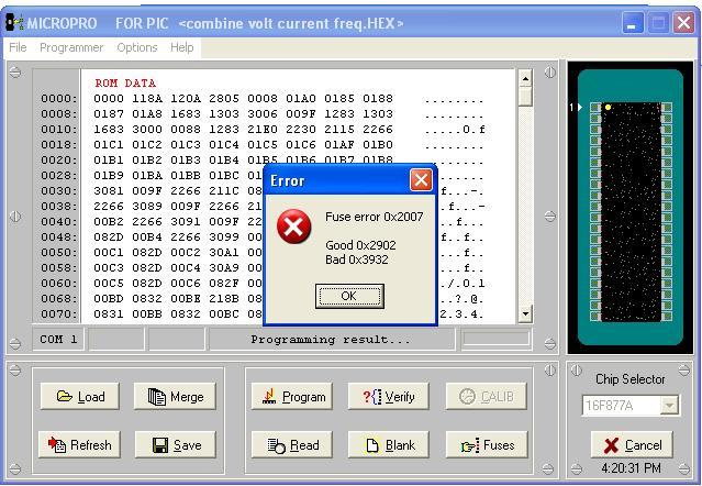

i tried those but my programmer shows fuse error
Read the chip back to make sure it's actually programmed the fuses, which it probably has.
The values I gave only set the bits which are used, WinPicProg masks off any unused bits when it verifies, some programmers expect them to be '1'. But as it's just a verify error, the chip should be programmed OK.
Try it, and see if it works any better?.
