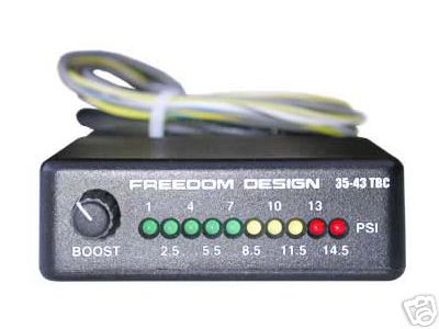

I am not sure exactly some of the things you guys have mentioned would actually look like on the box, so here is a picture of the results I need. I need to know how this was done, what with, and how I can do it? This is not my project or my picture, just one that I found to demonstrate what I am looking for. Thanks for all of your help.

It's probably silk-screen printed directly on the panel. You could do something similar with Letraset (rub down letters), which you then protect with clear varnish.
You could also do something similar by printing it out on your computer, and laminating it, cutting it out and glueing it on the front (although it will be shiny from the lamination - but it protects the letters. If you have a DTP package on your computer, try experimenting with it.

Yes, Letraset is letter by letter - I did see, years ago, transfers with complete words specifically for projects - but I've not seen them for years.
