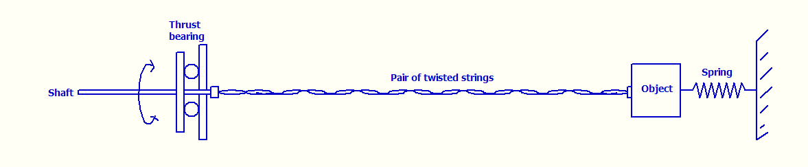

Here's a concept I had ages ago but have never tried out. It might work for you.
Brushless DC motor turns a shaft which twists a pair of strings. The more twists the shorter the strings get, pulling the object against spring tension.

Maybe it is possible to gear it up through two wheels in different sizes since it is not that heavy
