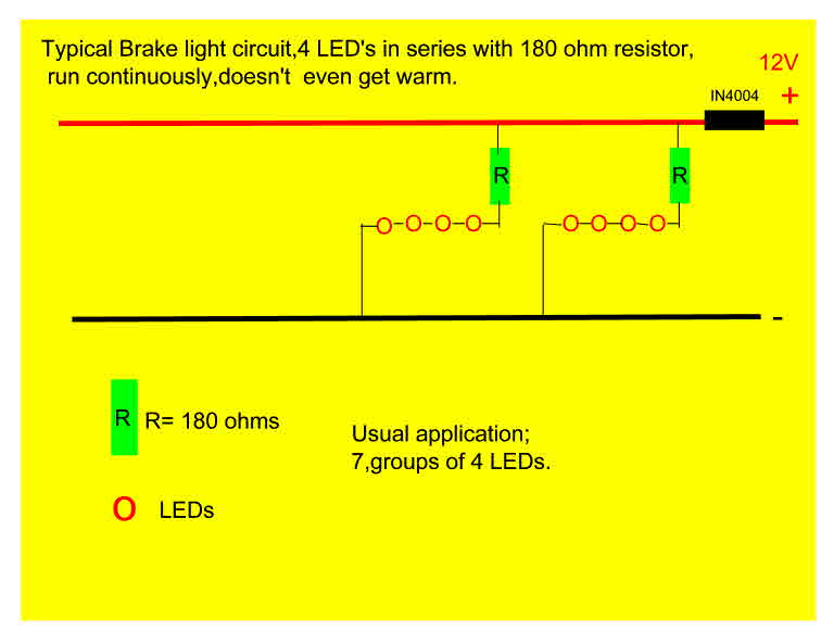

Alright so taking everything into consideration..
  1. I will use the scooter's 12v battery.
  2. I will test the LEDs and match them up.
  3. I'll keep them in sets of three using a 220ohm resistor in each set.
Sound like a solid plan? Do I need to throw a 12v regulator on the line to avoid voltage spikes? I can also just test the battery and see if it fluctuates much.

So does everyone think I will be ok running them in series or three @ 12v and just using 330 resistors? Will the resistors get too hot? I don't want them to melt the plastic casing. They are kinda close to the plastic.
Thanks guys, I have learned a lot from this thread already!
Justin
The resistors certainly won't get too hot because they will only have about 100mW of power dissipation. The LEDs will be making most of the heat, each string of three will be about 150mW, or about 50mW per LED. I don't think you will have a problem.

bountyhunter, you are suggesting using the 12v as input and using 330 ohm resistors in strings of three?ac
yes, one resistor feeds 3 LEds in series to ground.

I would not waste my time matching the LEds. The series resistor will keep the current in each string pretty equal. That really is a non issue.
I don't think so. Even if there is a spike, the series resistor will limit the current to a safe value.
Will I be able to desolder all those LEDs from that board? Should I use one of those sucker tool things?
No, suckers are pretty useless. Solder wick is the wau to go but I don;t think you need to remove the LEDs, just change the resistors.

12v brake light
Hi JdotFite, You don't need a voltage regulator,let the LEDs & resistors do
it for you.Ideally 4 leds & a 180Ω resistor will run continuously,without even
getting warm.Since you've allready built your unit,it would be a shame to take it apart (LEDs dont like to be de-soldered) the best way would be to replace the resistors,to calculate the value, check the resistance of a LED,
and add 180Ω you will now have group of 3 leds & a suitable resistor in series.
good luck Terry

The LEDs are not guaranteed to be 2.5V each. They have a wide range of voltages. If all four are 3.0V then none will light with a 12V supply because the current limiting resistor will have no current in it.
True, I wouldn't go higher than 3 LEds per string. You will get way too much brightness variation as the battery voltage goes from 12.6V up to 14V as the engine brings the system voltage up to nominal alternator/regulator set point which is typically 14V.
Look at the data sheet

There's no need to get too technical to create your Brake light. Firstly,it has one function,and that is to be viewed from the rear of your vehicle,usually from a straight angle,brightness varies according to the angle viewed.It is also only seen intermittently,(as you apply the brakes) The design is of your choice.The one you have built can be modified to work on the power supply of your vechicle,and as the light will only be used when the engine is running,then it has to cope with the voltage(usually 13.8v).So look at the data sheet of your LEDs,you will see-Forward Voltage;e.g. Typical 1.7v
Max 2.6v you can now calculate the resistance to light a LED without burning it out.e.g a single led would need something like a 1K2 resistor at a stable voltage of 12v,groups obviouslly share a resistor,and if one of them blows then the group fails to light,So design your circuit within the safe range of the LED and you will have no problem.
