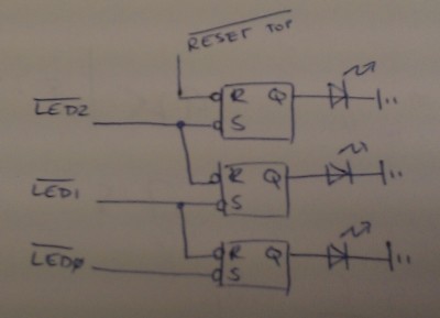

If you want to use SR FF on the outputs, you could do some cascade like so (obviously if would repeat for all LEDs, and I haven't drawn in any resistors):
The LEDs are driven by current sinks so the outputs of the IC do not produce digital lows unless the LEDs are replaced with resistors, then the digital low voltage will be 0.4V when the current is 2mA.

Do you have a circuit for the priority encoder setup? The RS latch implementation above can be done for eight outputs using two 74279 logic ICs (or four quad NAND logic ICs).
Do you have a circuit for the priority encoder setup? The implementation above can be done for eight outputs using two 74279 logic ICs (or four quad NAND logic ICs).
That's what I'm reading up on now. Thanks for the 74279 pointer. Soooo much to learn and relearn - it's been a fun couple of days.
