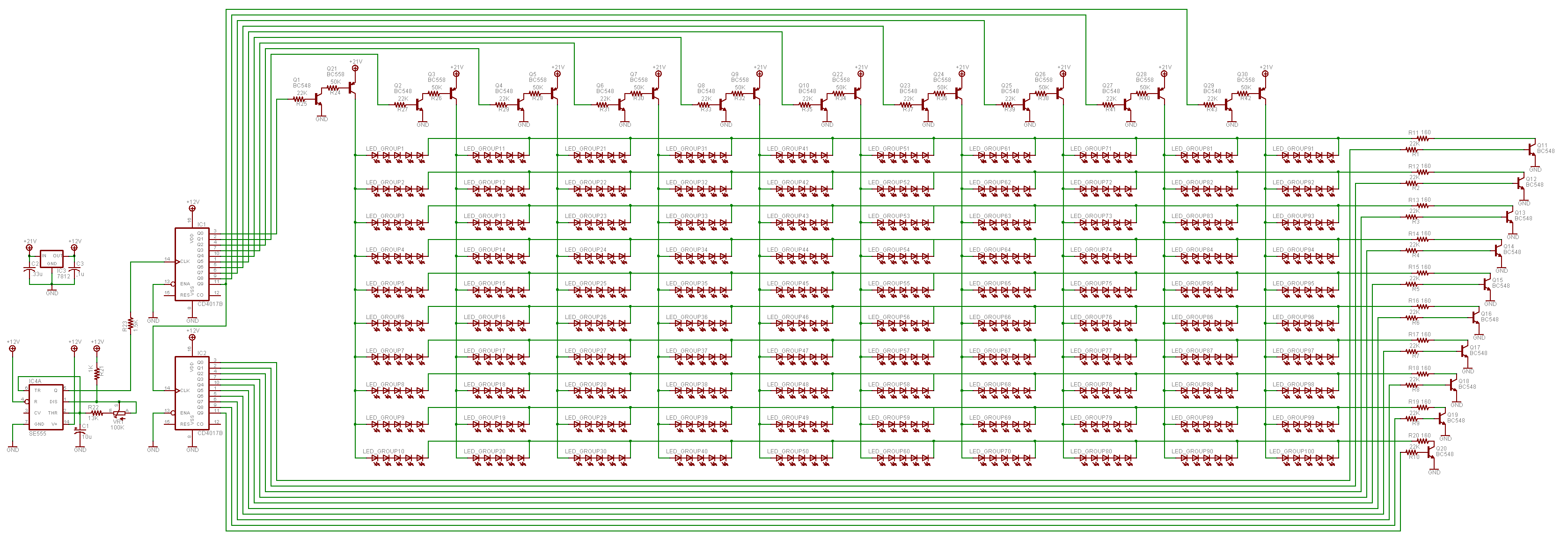

LED sequencing circuit

OK here's the latest version. Tear it up!!!:D

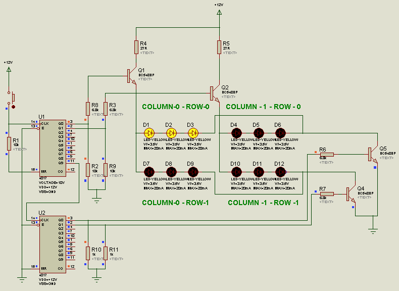

I simulated the circuit using five LEDs in group at a supply voltage of 21V. There is no way to control the transistors with a maximum base voltage (theoretically) of 12 to conduct 21V. (The maximum I got out was 11.6V)
Reducing the number of LEDs to three the group can be well controlled. I used base resistors of 6K8 for each transistor and a pulldown resistor on each counter output of 10K. In practical design the pulldown resistors might be a 10 element SIL-package.
Not using the pulldown resistors the circuit becomes unstable and produces error messages while simulating. With the pulldown I "played" the circuit at least 50 times with no error message, doing what the counter outputs dictated.
Using three LEDs in a group the OP might use just one power supply which saves cost. :) It also increases the number of flashes.
Two counter circuits won't suffice, but adding a third one shouldn't be a problem, increasing the number of LEDs to 501 total at a spacing of 1.996cm instead of 2cm :D
BTW, I suggest to connect the MR pins (15) of the counters to ground as well. It won't hurt. :)

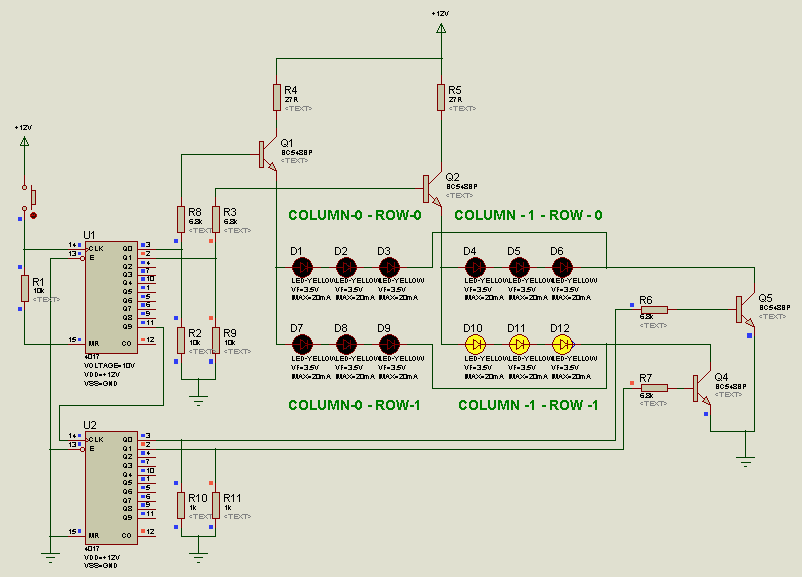

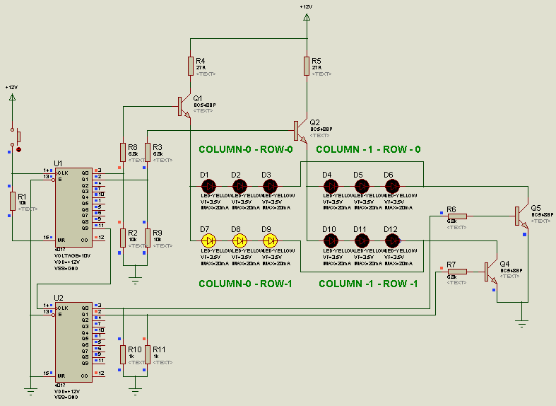

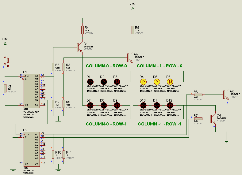

Attached are four screenshots of different groups being lit. None is glowing dimly.
I put the current limiting resistors of 27Ω at the high side. The resulting current for LEDs Vf=3.5V, If=20mA is 18.6mA.

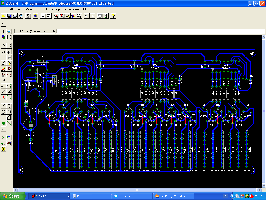

Based on vne147's circuit and my add-ons I have designed a single sided PCB layout which requires 10 wire jumps around the transistors.
Board dimensions are: 160X83mm (6.3125X3.3inches)
There is a total of 27 pieces of 10 pin connectors (10 for the colums and 17 for the rows) which should make wiring of the LEDs easy.

vne147's circuit does not work - there is no way for the 12V logic source to forward bias a BE junction into 16V of LEDs. easily corrected with an extra set of transistors and resistors but kind of kills the "low componewnts count" bragging point
