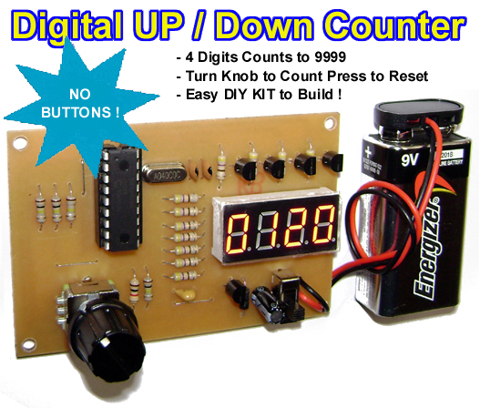

I agree that 20Hz is not the best, but unfortunately with my project there is time taken to read from the serial EEPROM. Usually, however, though -- when I multiplex displays I will scan the columns / digits as fast as possible. Another project I have made which uses multiplexing to deal with 4 digit 7-segment displays runs much faster than 20Hz (I do not know the scan rate but it is probably several KHz:
