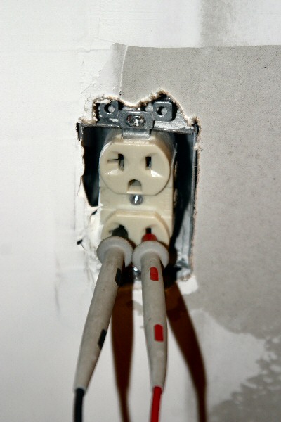

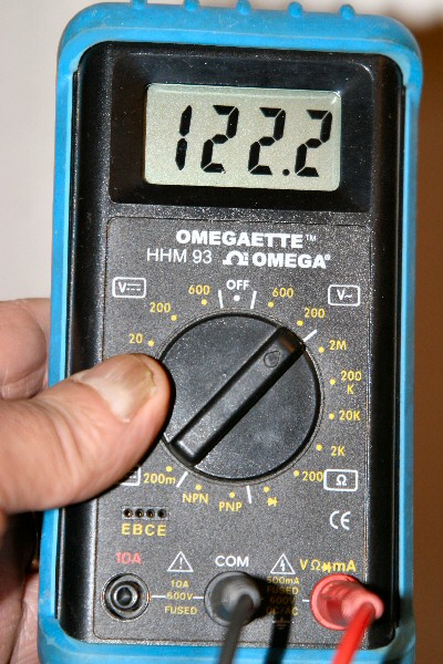

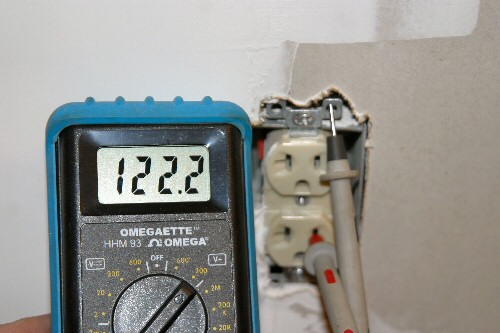

If the RV has standard 120 VAC power outlets they should be wired identical to residential outlets. There is 120 volts hot or high, a neutral and a ground. Attached are some outlet images with resulting voltages. The first two images show measuring neutral to hot with the resulting voltage. The last image shows hot to ground. The voltages should be the same give or take. This shows that Ground and Neutral are tied together at the mains breaker panel. This can be done using a meter as shown or just go to any hardware or home improvement store and buy a simple 3 lamp outlet tester for about $10 USD.
