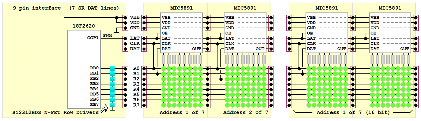

I'm sure I've seen somewhere an LED matrix with minimum pins. I was going to pick up one of these:
LED Matrix - LEDM88G
Which looks perfect for use with Nigel's tutorial. However I'm sure I've seen a few really good circuits that use less port pins by implementing row/column driver ICs.
I've also seen Mike's excellent PWM version of a similar thing, but I assume that would need all the pins too.
Can anybody suggest what other components/ICs I should buy at the same time so that I can try it?

Use a processor with enough pins.
Use shift registers, 74hc595s work well. 3 pins per register chain. With some work you can get that down to 2 pins.
Buy a IC designed to do the work. Depends on the interface, SPI will be 3 pins.
Consider using 8 bit or 16 bit serial-to-parallel "sinking" or "sourcing" driver ICs.
Example 9 pin design below can drive one to fourteen 8x8 modules. It uses 9 pins forming a high current display module bus which is also used as a 7 channel SPI interface to load the shift register of the source driver ICs on each module in parallel during display "off" time.
Similar designs using 9 or 10 pins can use "sinking" or "sourcing" driver ICs.
Other designs might use 3 pins (Data, Clock, and Latch or PWM) and an additional serial-to-parallel driver IC.

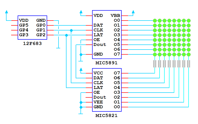

Thanks for both your replies. My futurlec order just arrived and I've got some 74HC595s and a matrix. I assume I can use these for the anodes fine.
For the cathodes, the datasheet suggests they can sink or source 25mA, so could I use another 74HC595 as a column driver? Or would transistors be a better solution?

I guess my question really was: are the 74HC595s suitable for sinking & sourcing which would be a 6 pin interface to the 8x8 array.. Or am I going to have to use one 74HC595 to drive and 8 transistors which would use 11 pins?
I'm slightly confused how the 74HC595 sinks current rather than sources it, i.e. how it becomes an "input" rather than an "output".

Ah, so it appears the OE pin on the 74HC595 controls this. I'll have a play and see if I can get normal output onto 8 LEDs first (via sinking & sourcing), then play with the 8x8 matrix.

Directly driving columns and rows from the 74HC595 outputs at a 1/8th or 12.5% duty cycle will not provide enough 'peak' current for a full brightness display.
If 10 ma forward current through an individual LED provides full brightness then you would need approximately 80 ma forward current or 'peak' current at your 1/8th duty cycle to provide 10 ma 'average' current and to perceive the same brightness level.
You need to provide 80 ma 'peak' current per LED at 1/8th duty cycle and you need to provide for up to 8 LEDs lighted at one time in a column or row, depending on which way you're multiplexing the display. That's 640 ma 'peak' current on your column or row drivers and that's why I use N-FET (sinking) or P-FET (sourcing) drivers on the rows in my design examples.

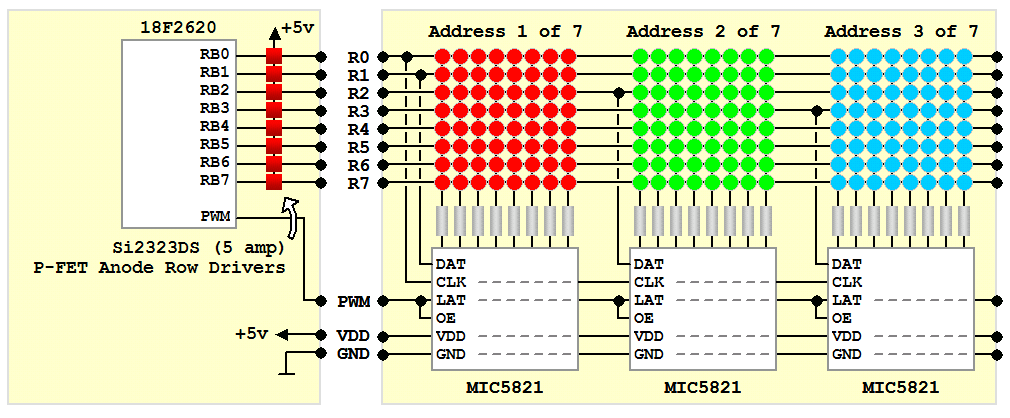

I suppose it depends on your design. I normally scan rows so that's where I use the high current (5 amp) FETs and I only drive one row at a time. Here's the procedure I use;
1 - blank the display (take OE high on the driver IC)
2 - select new row (power up only one of the FETs)
3 - load the column shift register
4 - latch shift register data onto driver IC outputs
5 - display new row (take OE low on the driver IC)
Now I should probably point out that I connect the <LAT> and <OE> pins together and drive them with the PIC PWM signal line. This effectively performs steps 1, 4, and 5 for me automatically. All I do in my ISR is select the new row and load shift register data. The PWM signal also provides full "fade to black" display brightness control.
There's a relatively simple 7x8 prototype and software listing in this thread; 8x8 matrix proto' notes.
That example uses a serial-to-parallel sourcing driver IC. If you need to sink common cathode columns then you would probably want to use P-FET row drivers and a serial-to-parallel sinking driver IC as shown in the attached drawing.

Also wanted to mention that Russ's "pointless" design is very similar to the second design in my earlier post. Both designs use 500 ma sinking and sourcing driver ICs but my design only uses 3 pins because it's using serial-to-parallel ICs.

Got it, thanks Mike. Just looked and I can only find the Si2323DS or Si2312BDS in SMD packages, which makes it much more difficult as I don't have any way to make PCBs.
However, the MIC5891 and MIC5821 pair in your earlier post look good as I only want 8x8. I could combine this with a suitable resistor pack (e.g. 47Ω) and column/row scan. I assume that this design was designed for 1/8 (not 1/64) duty cycle?
This seems much simpler than combining shift registers with a transistor array (e.g. ULN2803), if my assumptions are correct.
