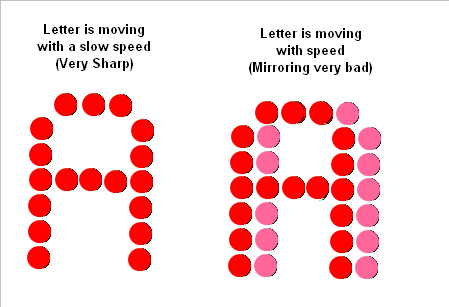

I’m making a 5X7 (5columns & 7 rows) matrix project. Rows driving from PORTB & columns driving from 74HC164.
I can scroll a letter nicely with a slow scrolling speed.
My problem is when I increase the speed of scrolling the letter is mirroring. Means some sort of shadow moving with the letter lines. So when scrolling speedily the letter is not sharp.
People who have experience with matrix designs may know this incident.

Here is the problem with a picture. So it will be more clear to you all what I’m talking about.
I’ll post my schematic + code as well.

Does this make any sense ?
To display each column
A: set portb (rows) such that all leds are off
B: setup the shift register to select the next column
C: set portb to select the leds you want on.
D: delay
C: goto A
If you skip step A you will have the mirror problem.
Assume you are sourcing the leds. Lets say you write 0x2F to portb to create the right leg of letter 'A'. You have these leds on and need to shift right to the next column where all of the leds should be off. But if you skip step A (turn off portb) the same LEDs will now be on in new column for a few machine cycles. They go off as soon as you update portb.

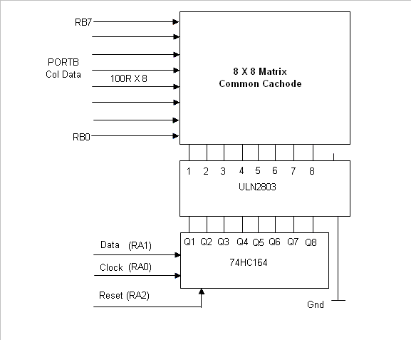

Here is the schematic.Its & 8X8 matrix I have used 5 from the 8 columns & took all 8 rows in the software.
I'm doing a column scan.

With the aid of your last post I was able to read the code.
I only read asm when I have too. :)
If you can hook a 2 channel scope to two adjecent transistor outputs, maybe 2 and 3, look for overlap.
If not add more delay in the red code till the problem goes away. If that does not fix the problem I am wrong about it.
