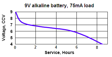

The Energizer datasheet for their alkaline 9V battery shows that its voltage drops to 6V in 20 hours when the current is 25mA which is a capacity of 500mAh. If the current is 200mA then it is at 6V in 1.5 hours and its capacity is only 300mAh.
Energizer has curves on their datasheet for their 9V alkaline battery that has the voltage quickly falling to 7.2V then slowly dropping lower. Your voltage regulator will not regulate for most of the life of the battery.
Im so ****** confused its not even funny. Can you explain all this MAH and crap. What does this mean? I dont get this. All Im doing is hooking up a 9v battery, to a 5v resistor, then I have the 120ohms resistor to the LED.
