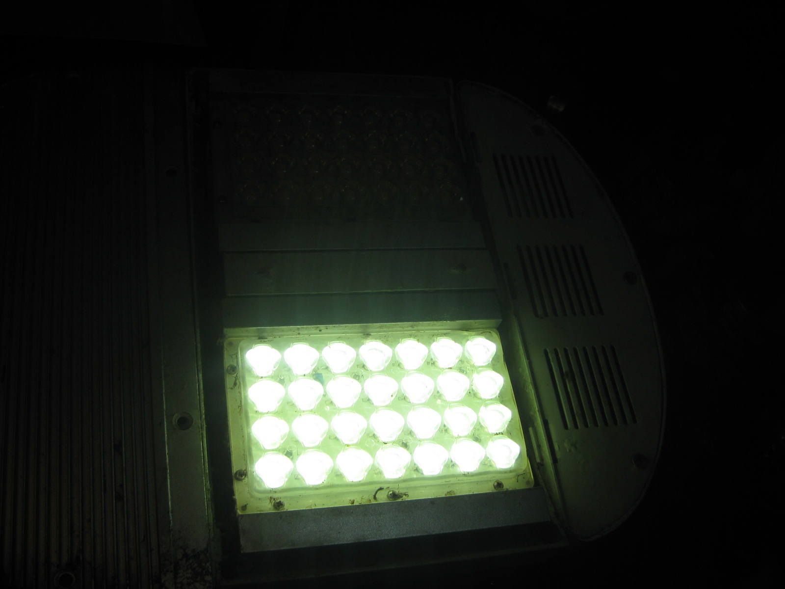

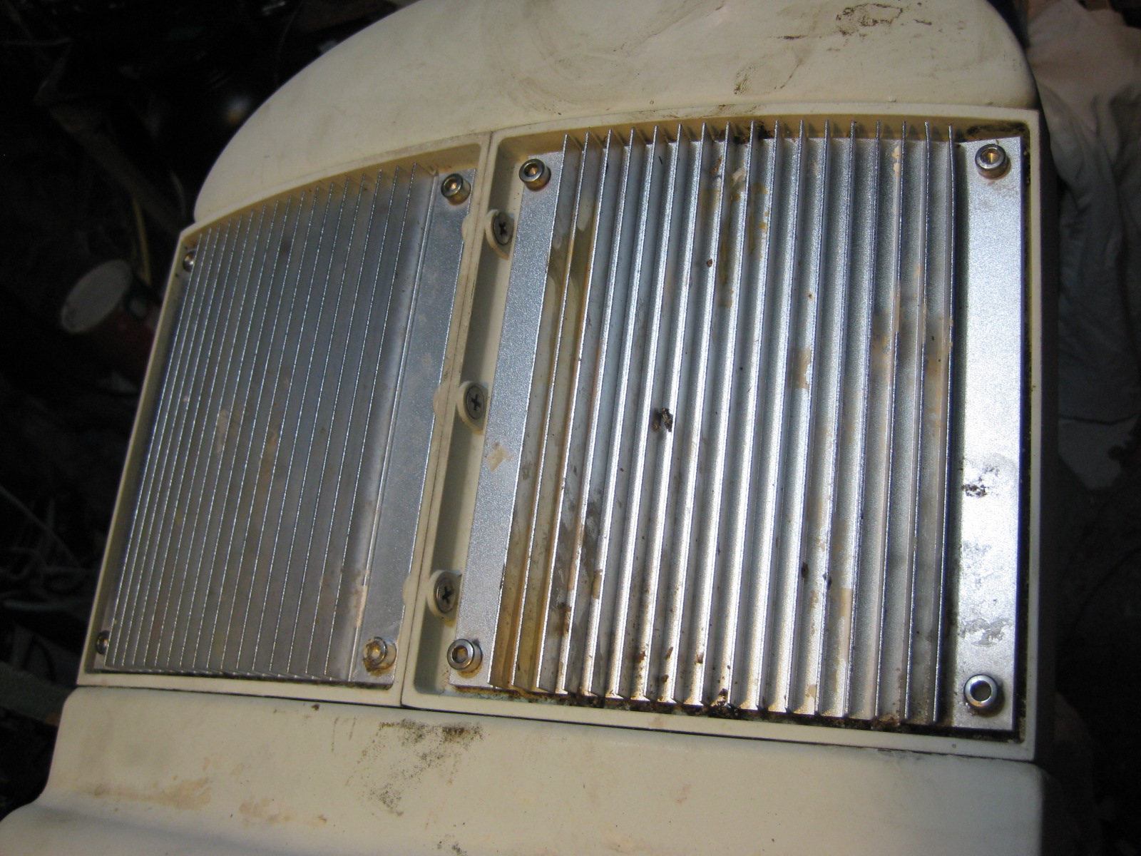

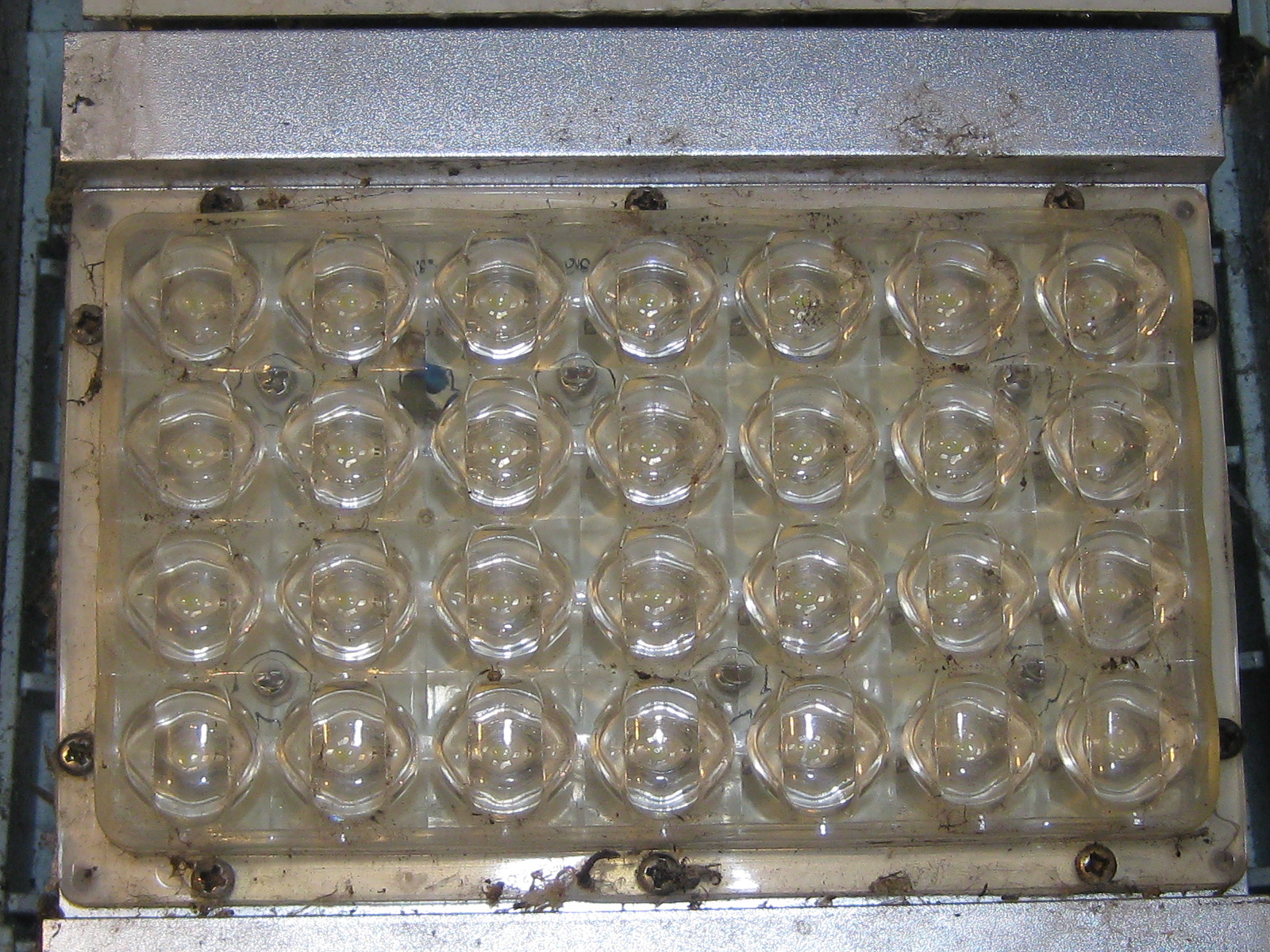

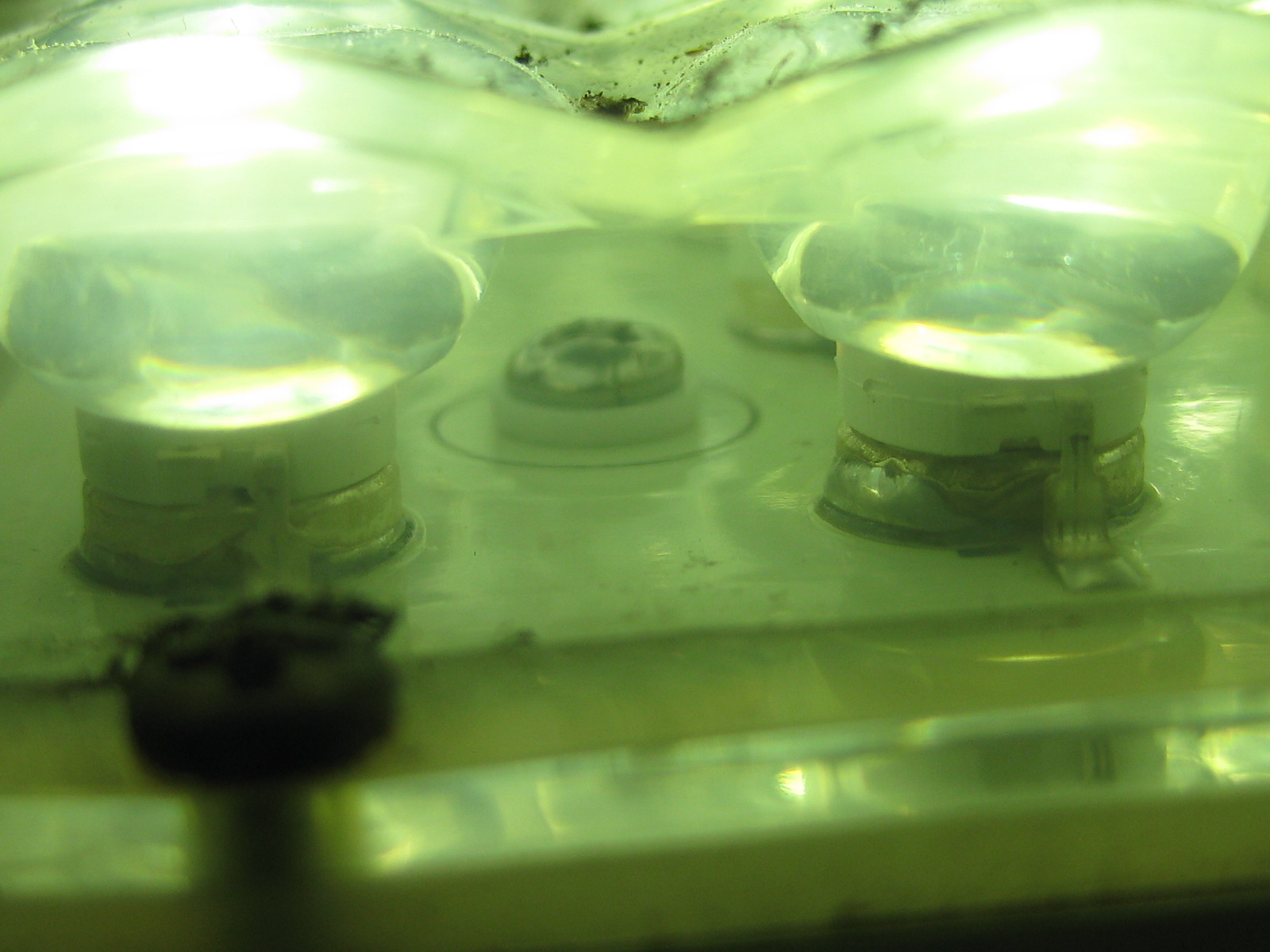

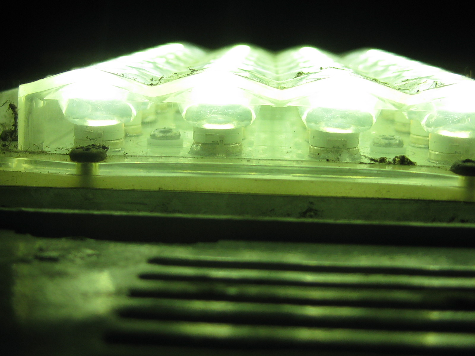

A couple of pics attached from one of the streetlights I have
2 clusters of 28 LED's
About 80 % of the streetlight casing is Aluminium heatsink.

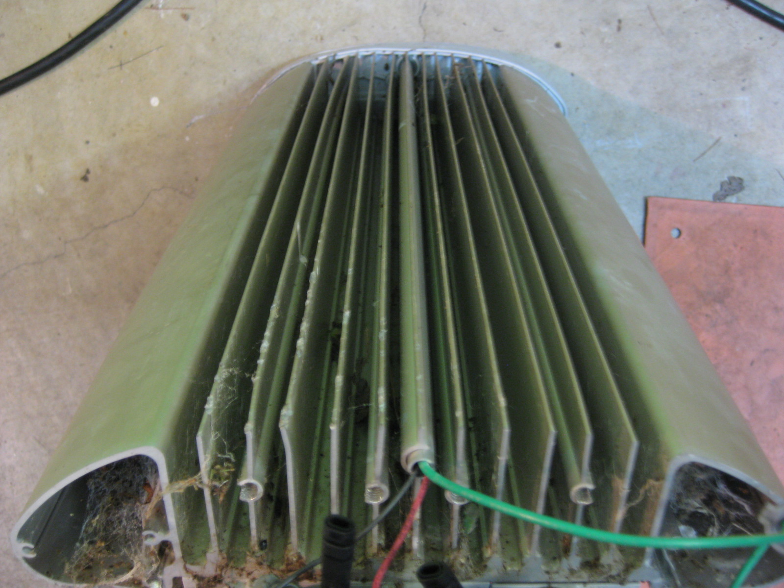

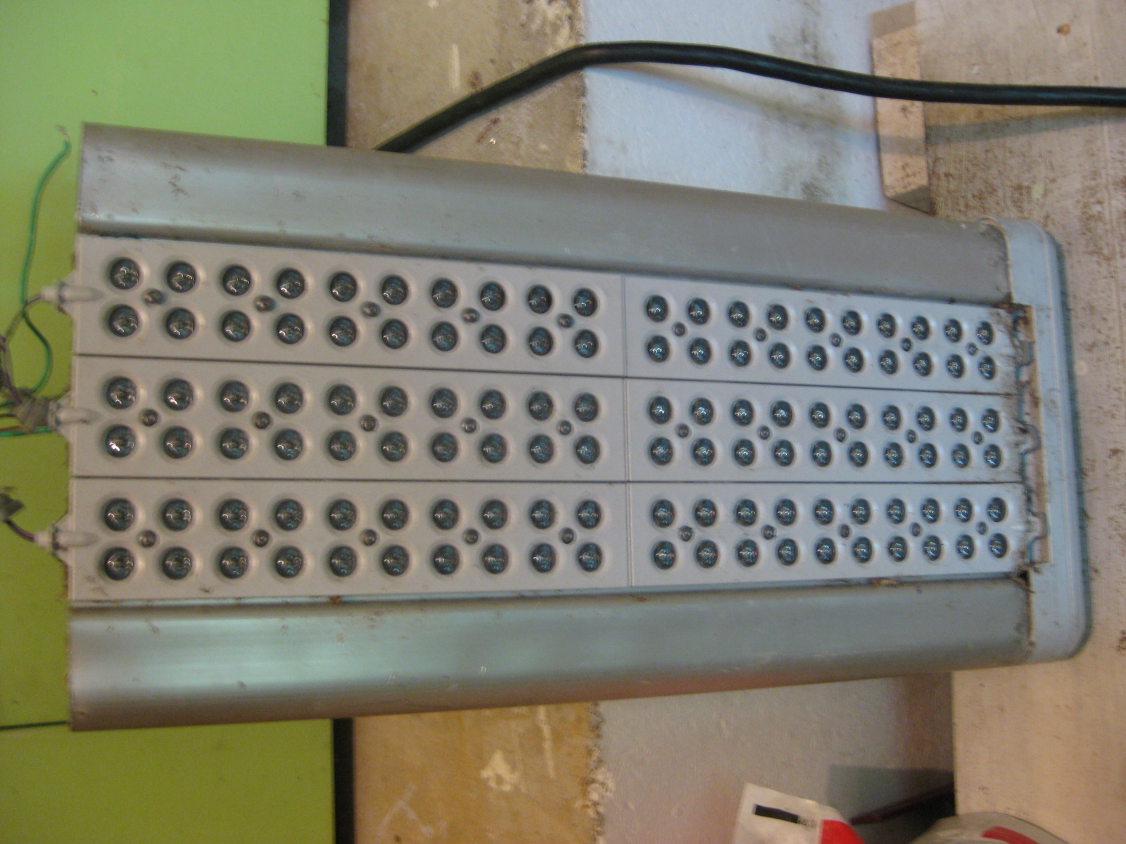

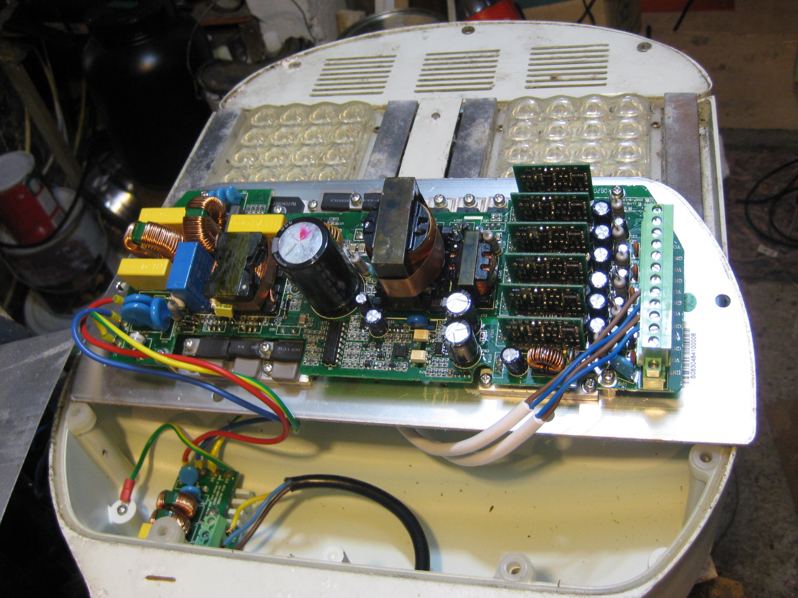

This is from another streetlight I have
The controller board was missing.

RODALCO the street light driver looks interesting....As you say its 56 LEDs in total. It looks like theres 6 DCDC LED
driver PCBs there. It seems unusual to use so many separate boards but maybe they want that if one fails, the remaining
ones can keep going.
I can see the PFC stage, and then the main Switching converter, interestingly I don't see any resonant capacitors, but I
do see a secondary side big inductor, which suggests either Half Bridge, Full Bridge, or two transistor forward
converter..........
-probably say not half bridge as I cant see a current transformer.
-probably say not full bridge because I cant see enough transistors, and also the powers not likely to be high enough.
-So probably Two Transistor forward converter.....but I can't see the high side gate drive transformer, so that's also in
doubt.
-possibly a one transistor forward converter....but that's a devil of a converter to put after a PFC stage because of the
high FET OFF drain voltage, also it needs the third reset winding.
-Could be an active clamp forward converter though.
If we knew the controller IC then that may give it away.

Flyback, I will make a few more close pics of the driver.
I am not sure what the photo limit is on this forum.

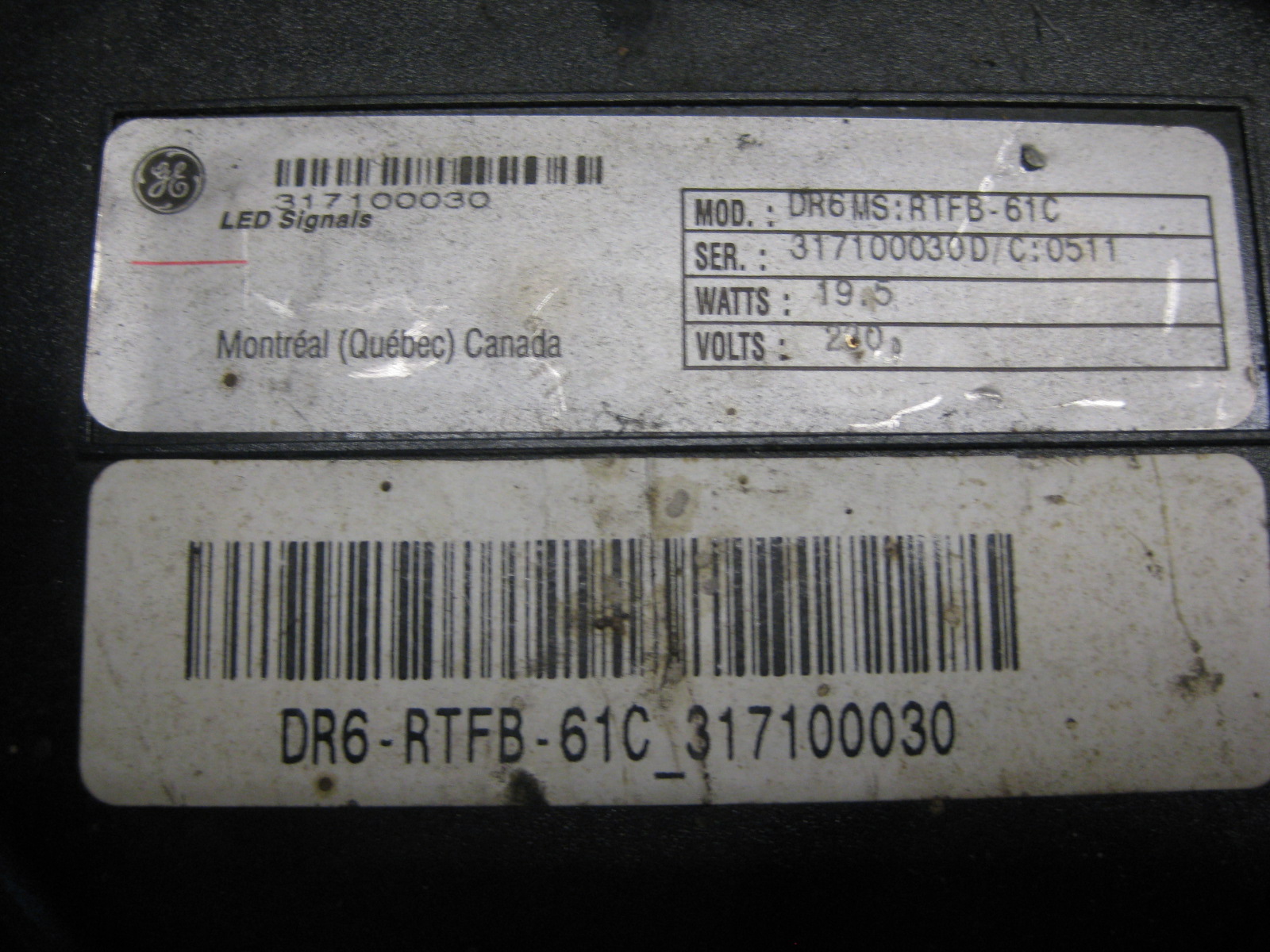

Found the traffic lights too , info will follow.

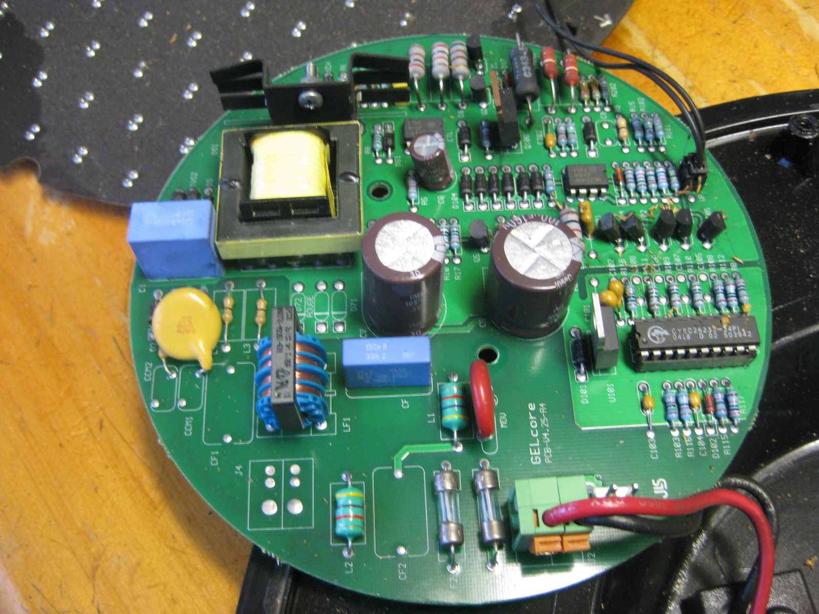

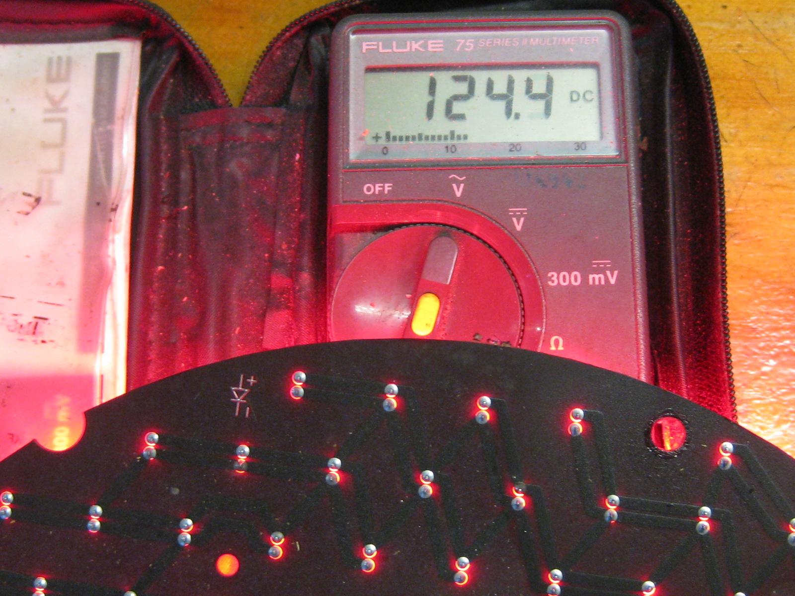

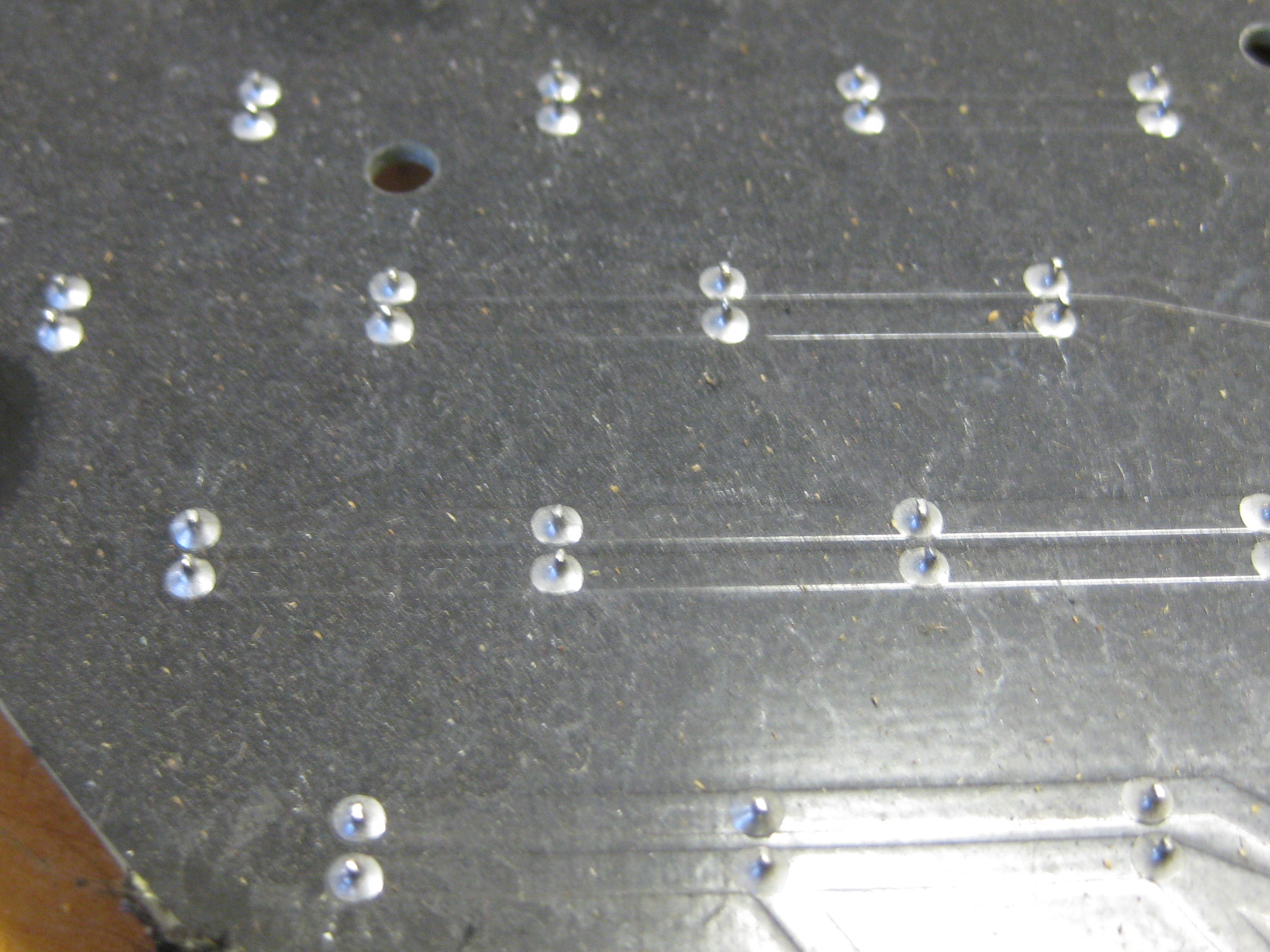

I have made some photo's from the Red LED cluster from which the LED's are in 49 lots in series of 4 LED's in parrallel.
Total 196 LED's are used.
LED Current is 124 mA

Thanks Rodalco, that's interesting, a traffic light is only 15.4 Watts at the lamp....(124.4V * 0.124A)..that certainly is lower power than I thought.
The LEDs pass 31mA each (unless they are PWM dimmed), as long as the 4-in-parallel groups share the current with each other.
It seems bizarre that they didn't just put 4 parallel strings of 49-leds-in-series...and reap the benefits of statistical spreading of Vf variation, in order to assure (to a degree) equal currents in each led....they could have put a resistor in each of the 4 strings to stop any string from hogging too much of the overall current.
The back of the LED PCB shows that most of the bottom layer copper has been etched away.....maybe they recycle it to save money(?)....if say one of the leds in the 4-in-parallel 'unit' hogs most of the current, then it will overheat, and without a decent size copper 'pcb heatsink' to dissipate the heat, the led will likely overheat....so it seems unusual why they etched away the bottom copper.....also, parallel leds work better with good thermal coupling, so its odd that they missed the chance to better thermally couple the leds by removing the bottom copper.
(but maybe these are special leds which incorporate in-built resistance to aid parallel operation).
I suppose using many small leds in theory means that you don't need to glue the led pcb to a aluminium heatsink, because the heat is in theory spread out. ..so you save money on a heatsink.
When they produce such a product, I wonder how many led pcbs fail at the switch-on-and-test stage because some of the leds are much dimmer than others due to current hogging.(?)
I wonder if they have to leave them on soak test for several hours to try and precipitate any such "current hogging" failures(?)
-in the Far East, they have many staff who work for cheap, so maybe they can afford to have such "extended soak testing".
The 'all-through'hole' assembly suggests the Far Eastern manufacture.
So this looks like a cheap product from the Far East, but are the West mugs?, buying cheap products, that just fail prematurely? (or do they last a long time?)....some posters here have said they've seen that some leds in traffic lights they've seen have failed
