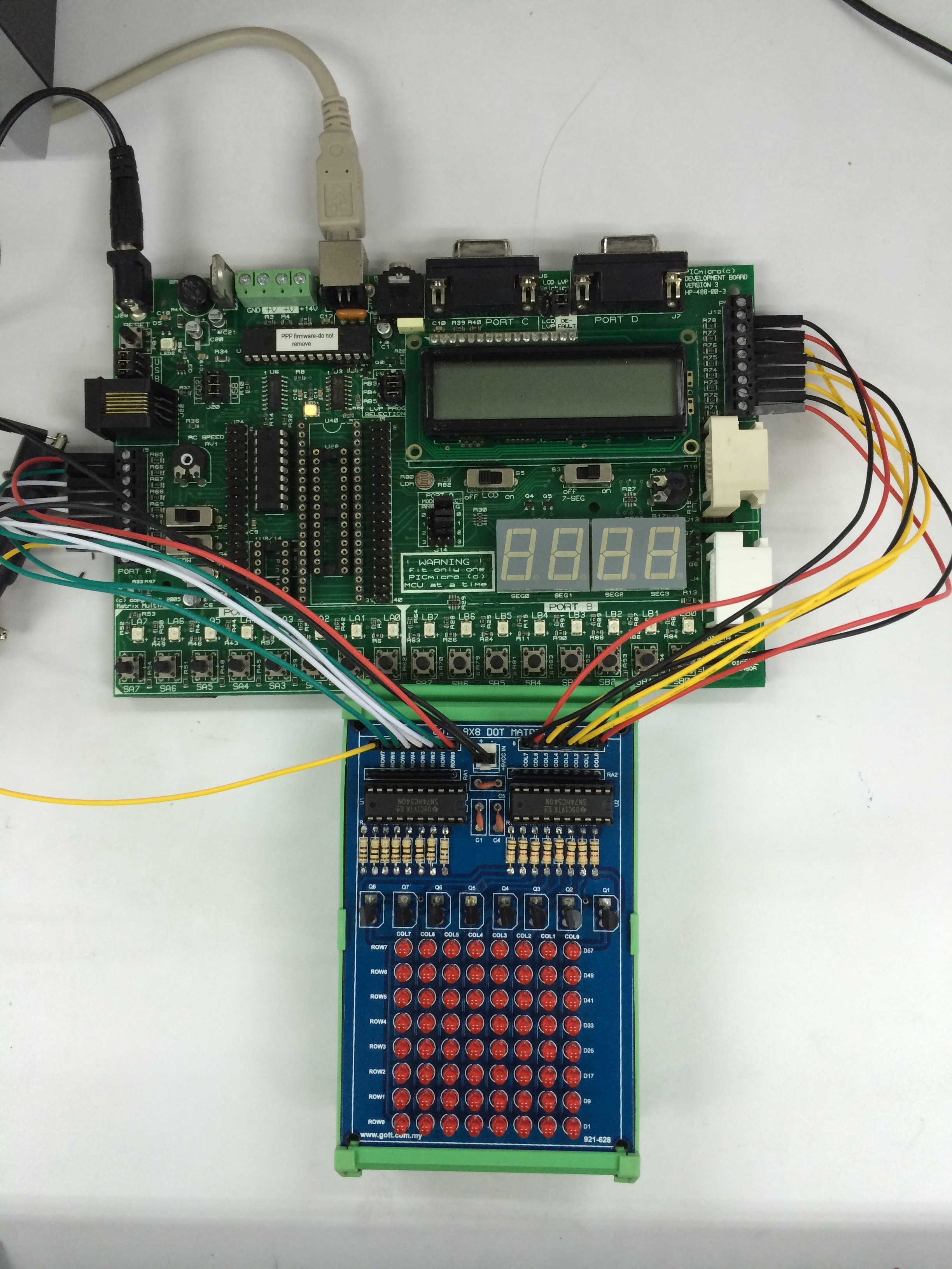

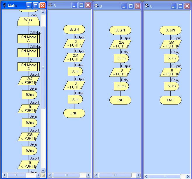

Beside is the dot matrix I'm using IMG_0884.jpg. The version of flowcode is V3.6.11.53. My purpose is find out the output for every single LED. SO i try to light up each col and row first. This is the output i found for COL0-7 flowchart.jpg (due to using demo version of flowcode, the outputs can be used are limited ). Output for col6 and 7 are 191 and 127. When i try to light up row0 with the output of 254 at port A and 0 at port B, the led at row0 light up but also leds at row5,6 & 7 flowchat row0.jpg

Are your outputs inverted by the transistors.... ( I assume so as you are using binary "11111110" ) but then you are setting port b to 0... There are only 8 transistors, so shouldn't only one port be inverted?
Have you a schematic of that LED board?
If you have the rows on port A and the columns on port B you should be selecting 255 on port B to light all the row..
The other thing to check is that your pins are outputs and any analogue modules are turned off... One more thing... Some DEV boards use the pins elsewhere so that can affect your results... Just make sure nothing else on the board is using these outputs.
Hi there, for your information the output is inverted as shown in image provided ( to light up bit 0 , u need to enter the output of bit1 to7 ). I don't know how to use binary in flowcode. Btw, i use 0 output in port b so that none of the led in col0 to col7 will be selected which means all led in col0 - col7 will light up ( with output of 255, none of the led in col0-7 light up since the output is inverted . Actually both port A and B are inverted based on my experience. I tried light up bit 0 in row0 and col0 with output of 1 and both led in col0 and row0 remain unchanged ( it didnt light up ). I think the output is nt affected by things u mentioned because i tried erased it using ppp. glads
