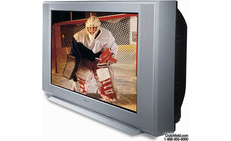

It must've been quite a physical workout working on those CRT's, compared to lighter LCD TV's.
Knowledge is power.
36 inch Sony's were probably the heaviest (Trinitron CRT's weigh more than others - thicker glass), you could barely lift them with two people, and on the box it recommended four people - but there's no way to get through a doorway with four people round it.
Those 36 Sony's weighted 98 kg. My piano weighs less. ;)
