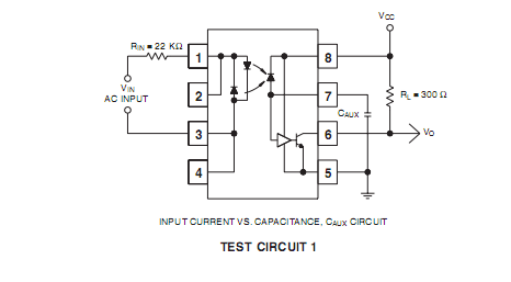

This is not a photo diode folks.
Its a green LED. Sunlight has nothing to do with it.
The circuit showing the photo diode is the INTERNAL circuit of the MID400 optoisolator from the data sheet, not my circuit.
Look at the circuit in the original post. U6 is the MID400 optoisolator. Pins 1&3 are the input (AC). When AC is present, it drives output pin 7 low, sending a signal to GPIO #RA0 of the PIC (not shown). It also lights the plain green LED.
The question was: do I also need the 10K pullup resistor, or would the LED and series resistor do the job of pulling up RA0 to a level that the PIC would recognize as high when the AC was not present.

So, considering everyone else is taking time to prototype this, I figure I should as well.
I set up the MID400 circuit without the pic. With just the series resistor and LED, the output was only pulled up to 3.5V when the MID400 is in the off state (Vcc=5v).
Of course, adding the 10K resistor pulls it up th the 5V rail.
So it's Vcc less the 1.5Vf of the LED. I don't have a PIC handy, but I cant see how the high impedance input of the PIC would change the circuit much.
EDIT: If I'm reading the datasheet correctly for the PIC18F4620, at Vcc=5V it would consider anything over 2V on RA1 to be high, so I *should* be fine.
PS, I fixed the schematic in the OP so that Vcc is at the top, per convention. Sorry for the confusion.
Mark_R,
The 10 k resistor can't hurt. Equally well, when nothing is driving the LED, the voltage can't get below about 3.5 V, as the LED starts conducting, and so with an input high voltage of 2 V you'll be fine. On the TTL level inputs, the switching point is far closer to the negative rail than the positive rail, so with your arrangement it'll be fine. I had problems when I had the LED between the input and ground.

the datasheet indicates the output state is pulled high when there is no line voltage, so you do not need a pull-up, as the input line of the PIC is not left floating, before connecting to the PIC Input, remove the LED and the diode, if in case you need them, then you can add these to an output port of the PIC, and modify the source code so that the LED is switched ON when the input is low and vice-versa.
The output of the MID400 is open collector, so a pull up is required.
