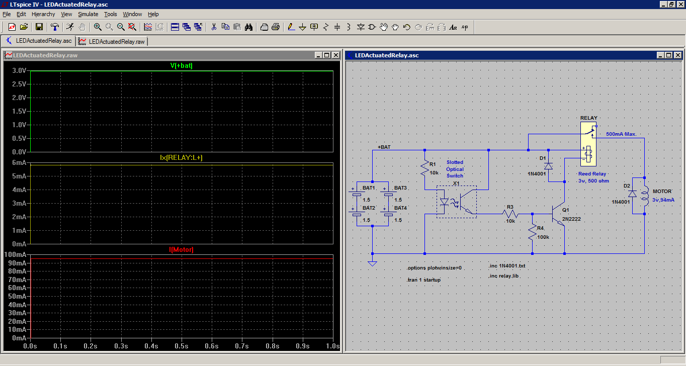

Hi
Here is a circuit that might do the job...
eT

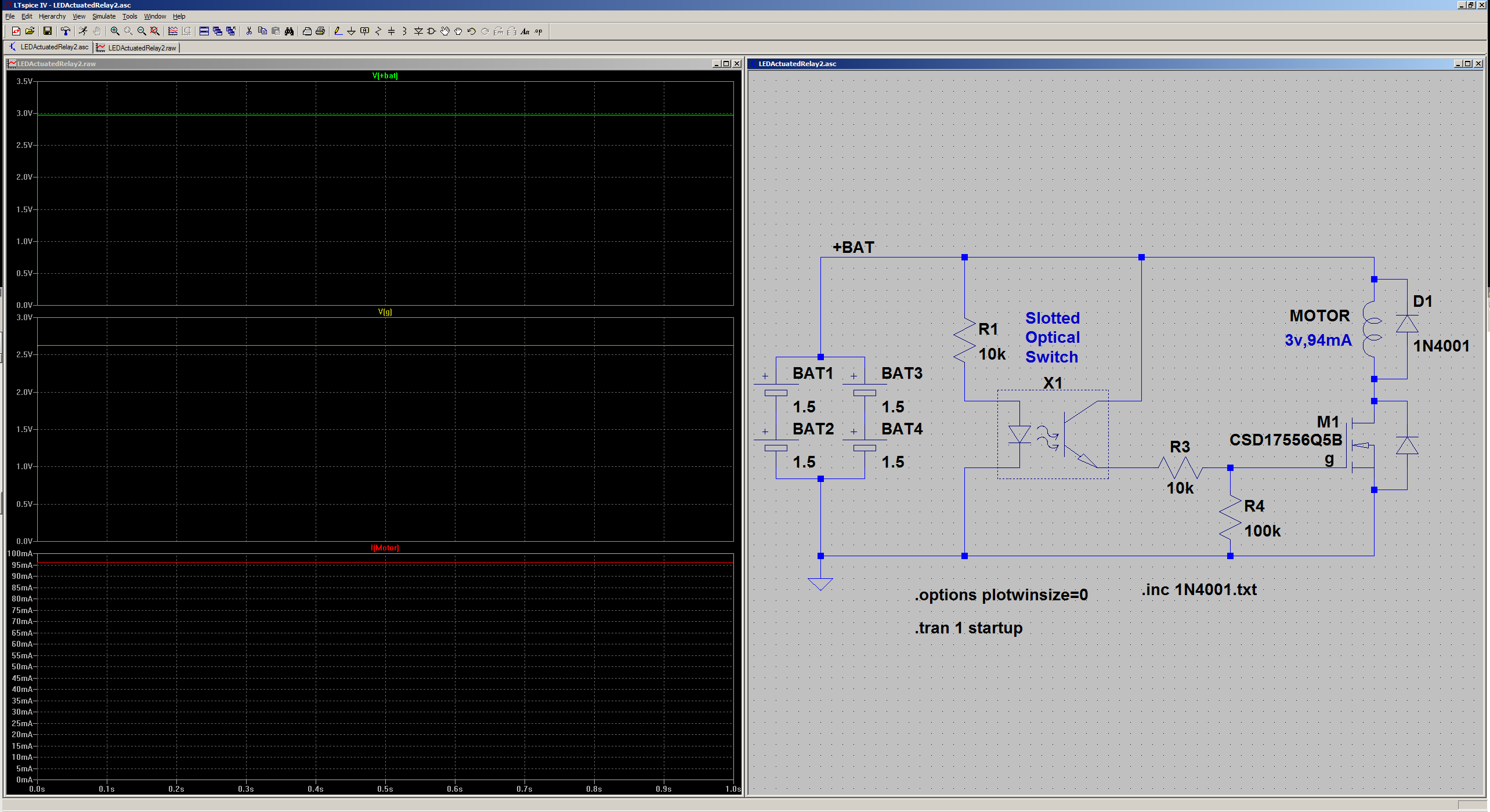

If you replaced Q1 in eTech's circuit with a logic-level N-channel MOSFET you could eliminate the relay and save space.
Hi Alex_T
Good idea...you mean like this?
eT
That's right.

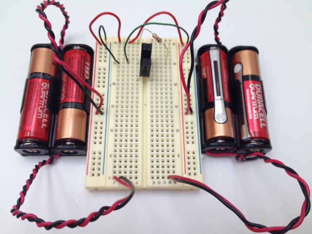

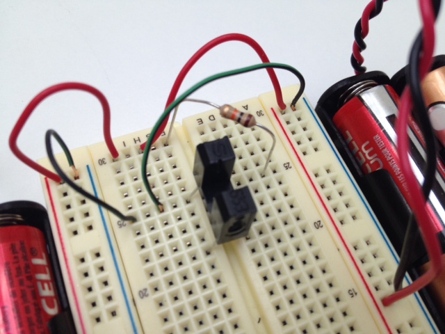

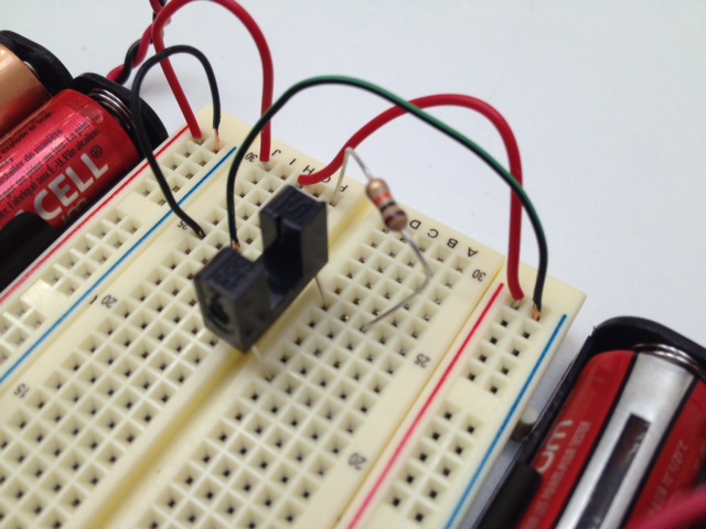

I was unable to make the LED light turn on. I tried two GP1S53V, but neither of them worked. I did verify that 3 volts was being supplied to to unit
Hopefully someone can tell me what I did wrong.

Just shooting off a few ideas...
Are you sure that you are connected to the LED end of the interupter?
Are you sure that the LED emits visible light and not infra red?
You have a 10k reseistor in series with the LED, that is far too high, there would be so little current that you would not see the LED illuminate.
Your batteries appear to be connected as two parallel series pairs, you will only have 3 volts to light the LED, not really enough. Connect the batteries all in series to give 6 volts.
So, use 6 volts and a 470 or 560 Ohm resistor and you will be in with a chance of it working.
It appears that it is infra red.
I used 6 volts and a 560 Ohm resistor across the infra red side, terminals 1 and 2
When power was applied there was no visible light, but the Ohm meter read 3.6 on the x10k scale across terminals 3 and 4.
I think terminals 3 and 4 were a long way from being fully connected, but at least there was some action.
Peak forward voltage = 4 volts maximum. Is 6 volt input too much?
I'm ordering more GS1S53v. I had two, one didn't work at all and the one I tested may have been defective.
Would it be wise too start over with a different photo interrupter?
Mark...did u assemble the test circuit as shown in the PDF.
The pins 3 & 4 are the emitter and collector of the NPN photo-transistor.
Thus you must ground the emitter and supply the collector with the +ve supply via a load resistor (pullup, say 10K) . Thus the output (from the collector pin 4) works digitally....and pulls 'low' when the IR beam is detected and pulls high (to Vcc) when interrupted. You cannot measure the Collector -Emitter resistance with an ohmmeter. A bipolar transistor is not a transconductance device. Usually the voltage drop across the collector emitter junction drops to a small fraction of a volt when the transitor is saturated ON, otherwise the Vce = Vcc-Vss (Gnd) when the transistor is OFF and not conducting. A transistor saturates more easily with a low collector current load. Transistor Gain or Hfe (Ic/Ib) is around 10X for collector current loads @ 50% max rating.
