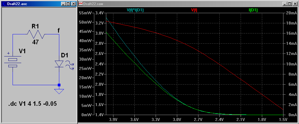

As I suggested a few posts ago, the regulator doesn't do much for you. Here is a sim of a "white" 3.2V LED discharging a battery. The Battery voltage is the X-axis. Notice the current I(D1). The battery discharge current goes to ~zero naturally when the battery reaches ~2.4V. The LED will be visibly bright while the LED power is between 50mW and ~20mW.
100's of millions of solar powered garden lights cannot be wrong... ;)

At least I will have a stable voltage supply to the leds
No, you won't. Read Mike's explanation in post #19 carefully.
And yes, you can place the via as shown.

You missed my point. You don't need an automatic cutoff. It happens automatically as the battery discharges below a voltage where it stops drawing current...
What if the battery discharges too often below the current drawing level, could it be damaged? Bear in mind, that I have three batteries in series, so one battery may fall down to that level, but the other two must not - so the battery circuit still will be closed and current will flow through the discharged battery. I wanted to prevent such an occurrence.
