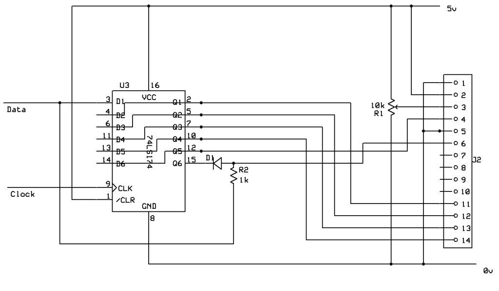

I have built a 2 wire LCD interface, which takes two pins from a PIC, clock and data, and with a shift register converts the signal to the parallel format required by the LCD.
After building this I tried to get it to display something, however it did not completely work. All of the characters, bar one, display perfectly fine. Though, one character (2nd on bottom row) displays a random character which occasionally changes. It does not matter what is supposed to be there, but something odd almost always comes up. I tried a different PIC chip and it worked, but when power was disconnected and reconnected the odd character was back.
Can anybody point me in a direction that can resolve this problem? Do I need a new LCD module? Or is it something simple in the program?
Thanks heaps,
Tom
PS I have attached a copy of the circuit and program.

First I would try the lcd module connected in 8 bit mode connected directly with the chip using KNOWN working software.
Secondly.. Try a pullup resistor on RA4 (the only pin on the chip that is open collector)
If it's not the display... try to AND the Data and E signals using two transistors, rather than the diode / resistor setup you are using
Thanks for that, I shall try that in the morning.
Adding a pull up resistor to RA4, will this affect the diode/resistor AND gate?
Tom
Probably.... I've never had success with two wire hookups, I always use a separate 'E' pulse...
That's why I recommend two transistors as an AND gate then you should have a clean 'E' pulse.
test the display first though... It MIGHT be faulty...

Jon,
Tom's circuit and code look correct. If you're interested, the source for this very old and rather clever method comes from Myke Predko and is documented here.
Regards, Mike

Here what he had to say about it
I normally use a 74LS174 wired as a shift register (as is shown in the schematic diagram) instead of a serial-in/parallel-out shift register. This circuit should work without any problems with a dedicated serial-in/parallel-out shift register chip, but the timings/clock polarities may be different. When the 74LS174 is used, note that the data is latched on the rising (from logic "low" to "high") edge of the clock signal.
And the rest of the story great reading

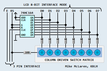

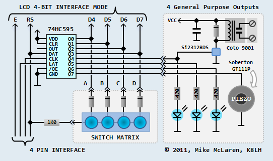

I'm just curious as to WHY. Why wire up a part into something it isn't when you can just buy the actual part that's made to perform the function?
Because that's the part Myke Predko used. When I tested that circuit several years ago I used a 74HC164 instead of a 74HC174.
Anyway, your 74HC595 circuit makes a good LCD interface too. I sometimes use a 74HC595 interface variation like the one shown below just to get a little more functionality from the part, but at the cost of yet another I/O pin.
Regards...
