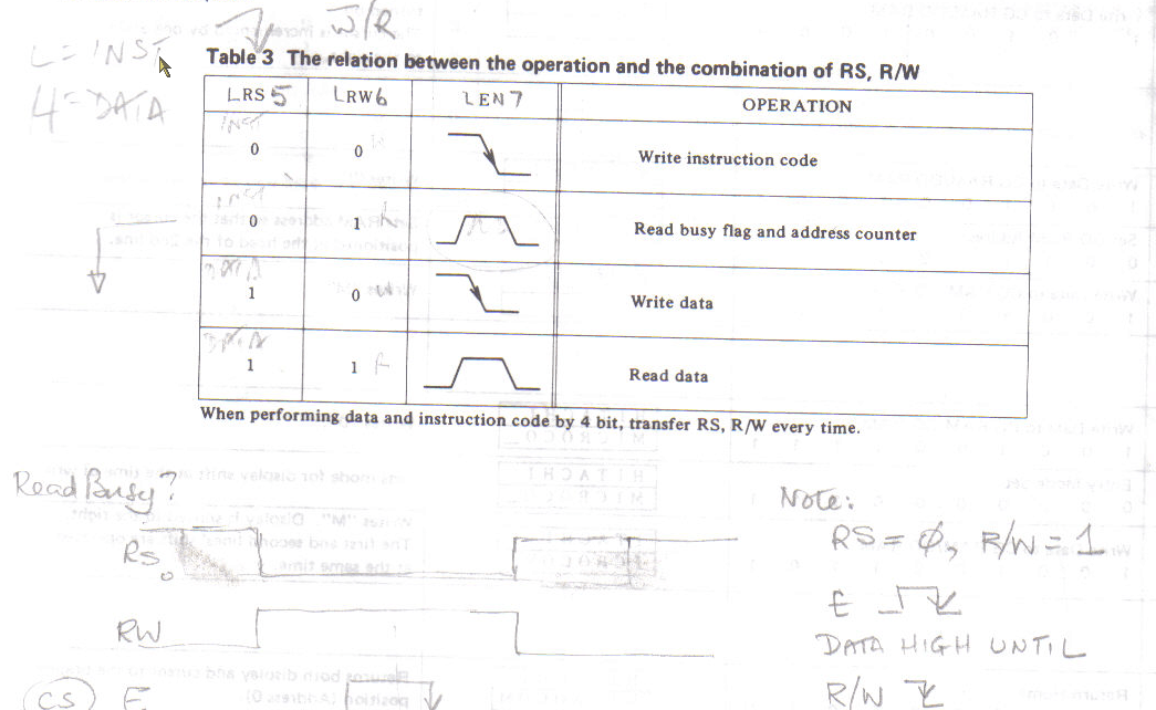

Look at this image. Sorry about the quality, its a copy from my notes
Check the phase sense of the signals. RW.????
Sorry, not sure what you're trying to get at here. Can you explain the bottom right of your notes - it says to make the enable go up and then down, and "data high until RW drops". Does this mean I need to do this:

This doesn't seem to match what's in the data sheet, which suggests that you can read the data a short while after raising EN but without having to lower it first. Also you don't have to fiddle with RW during the procedure.

The table I posted is from the Hitachi manual for the HD44780.
It says the RW line must be high when the Enable pulse is used to read the BUSY [D7] . You have in that section of code, RW low.
The hand written notes are from waveforms observed on a scope..

Check the state of the BUSY before you Write to the LCD

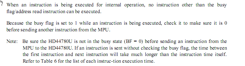

Maybe not enough
... and inserted a bunch of NOPs in the program after each change of state of the Enable line. However, I still get the same thing..........ahydra
Even a bunch could mean almost nothing in terms of the time needed, mostly miliseconds, as delays, during inizilization.
A bunch, a lot, are vague terms. Most, if not all, datasheets have some sequence where there are delays more or less well defined, consisting of XX msec and not a bunch of.
